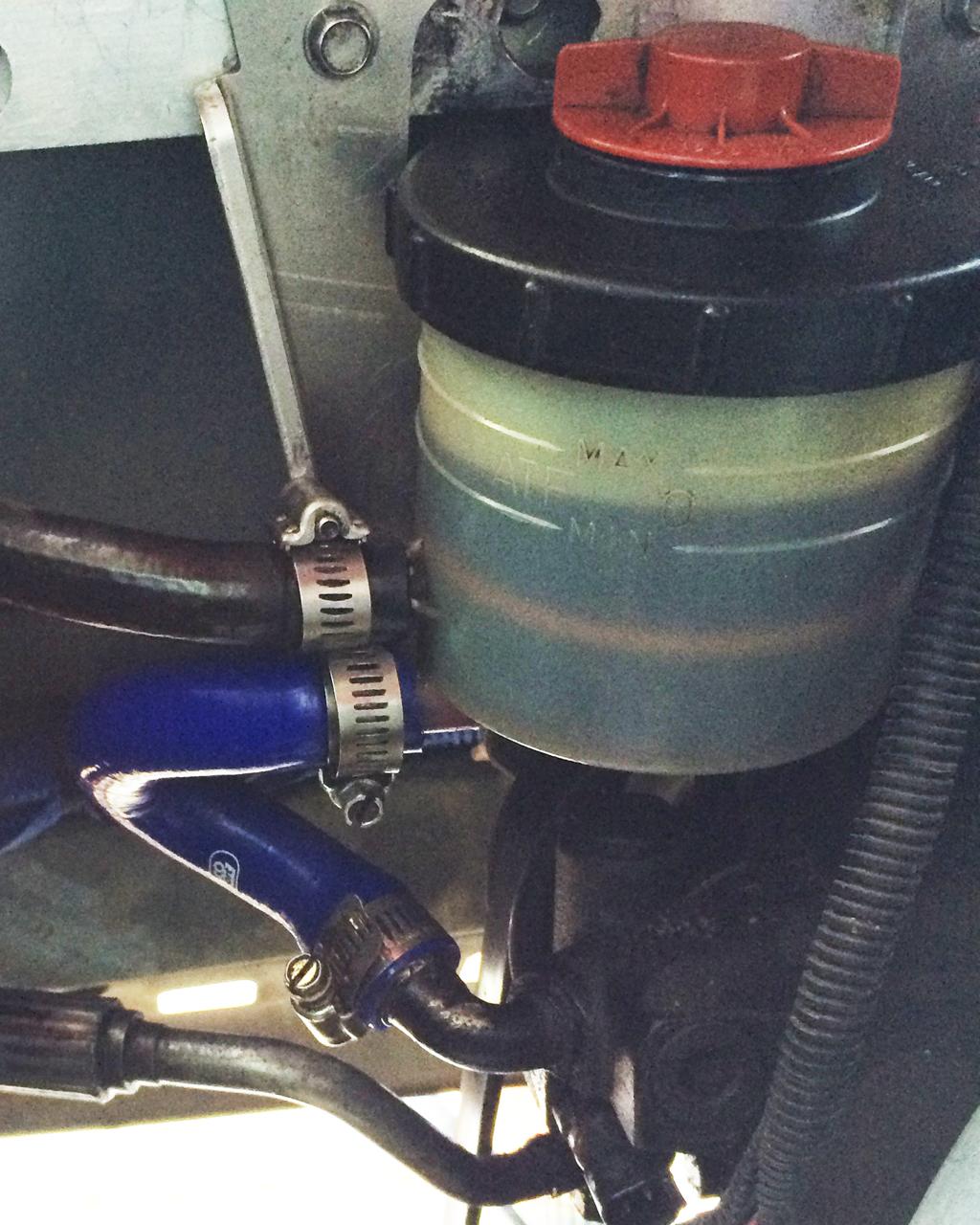

Just an update of an old thread . . .

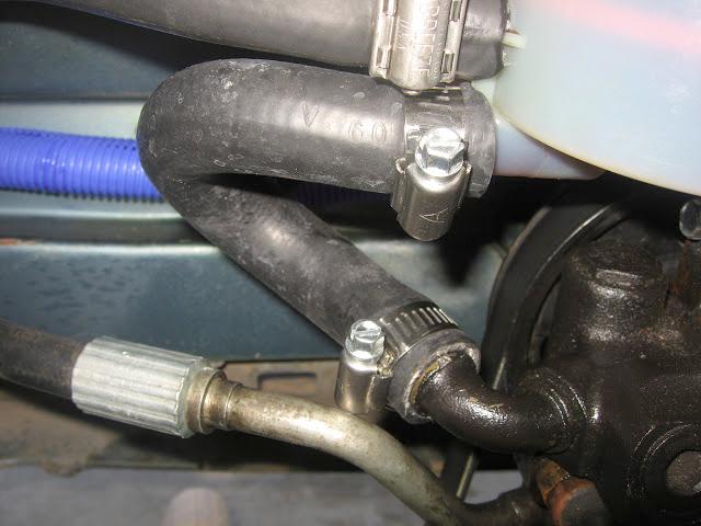

This PS hose that I originally tried was not oil/heat resistant.(originally posted back in 2013):
LemonCove wrote:
. . . found a short molded hose that works much more efficiently for the reservoir to pump line:
I found this teflon-lined silicone version that is basically the same dimensions and it works - Samco FE18016 teflon lined silicone hose. 180 degree molded 5/8" hose. About $40 (aargh) but the last detail that was really bugging me on my 2012 installation.
[/img]

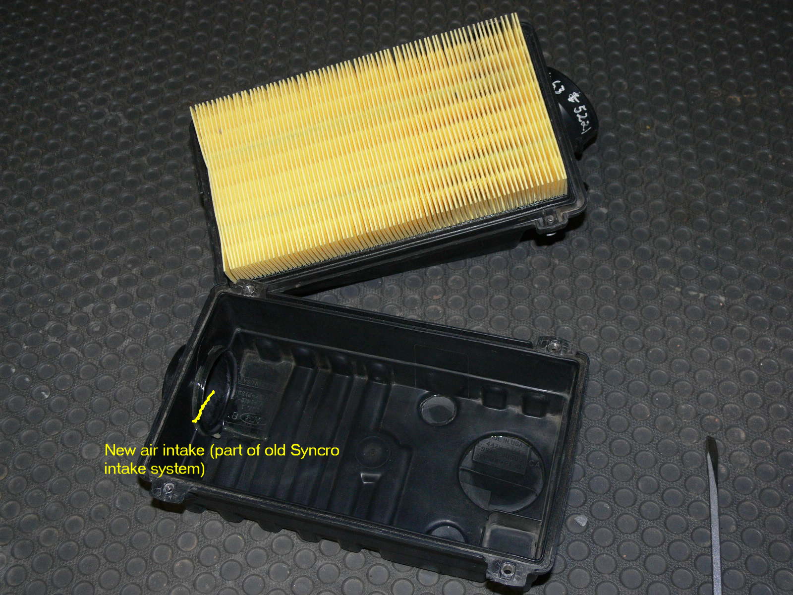

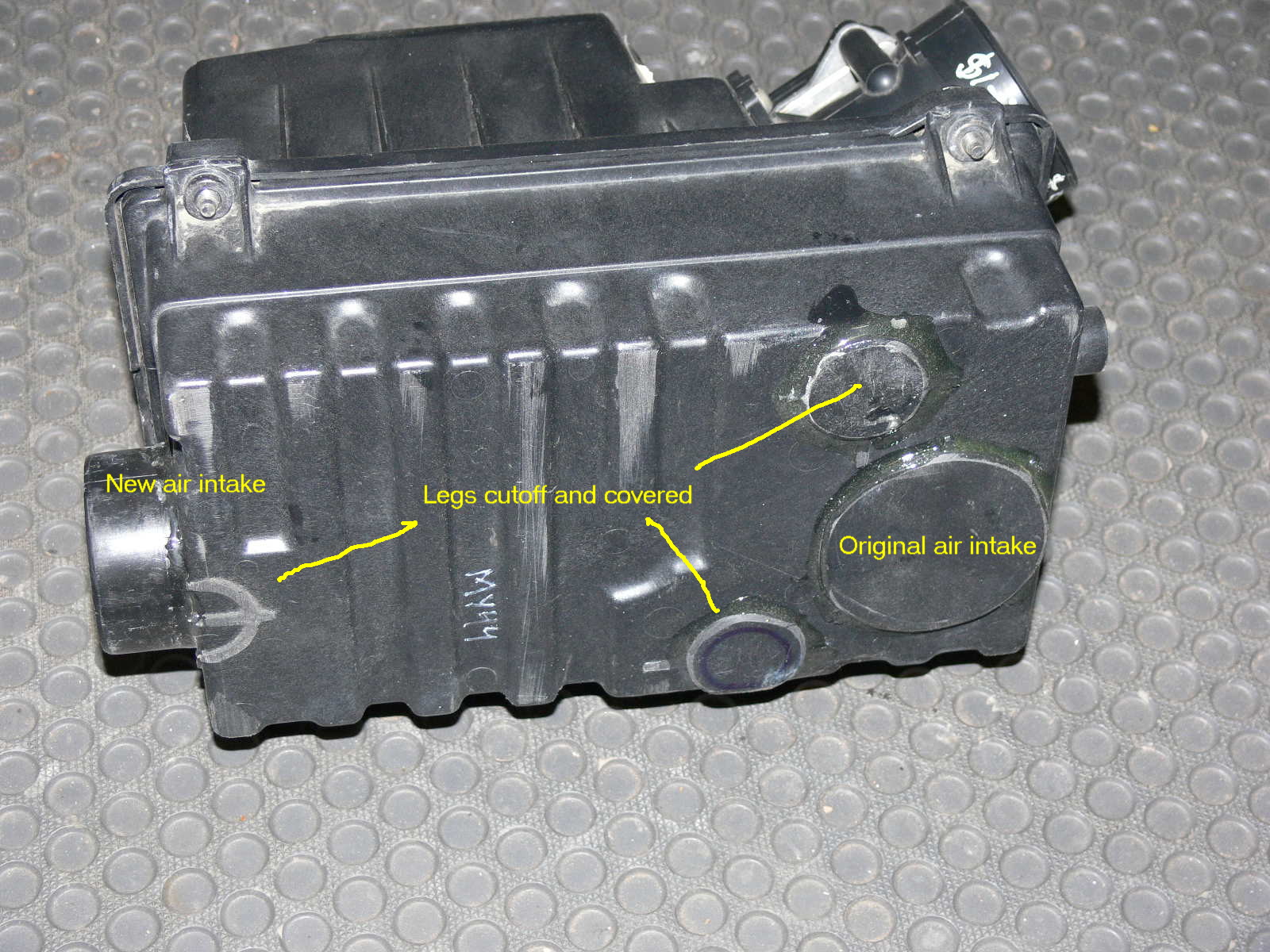

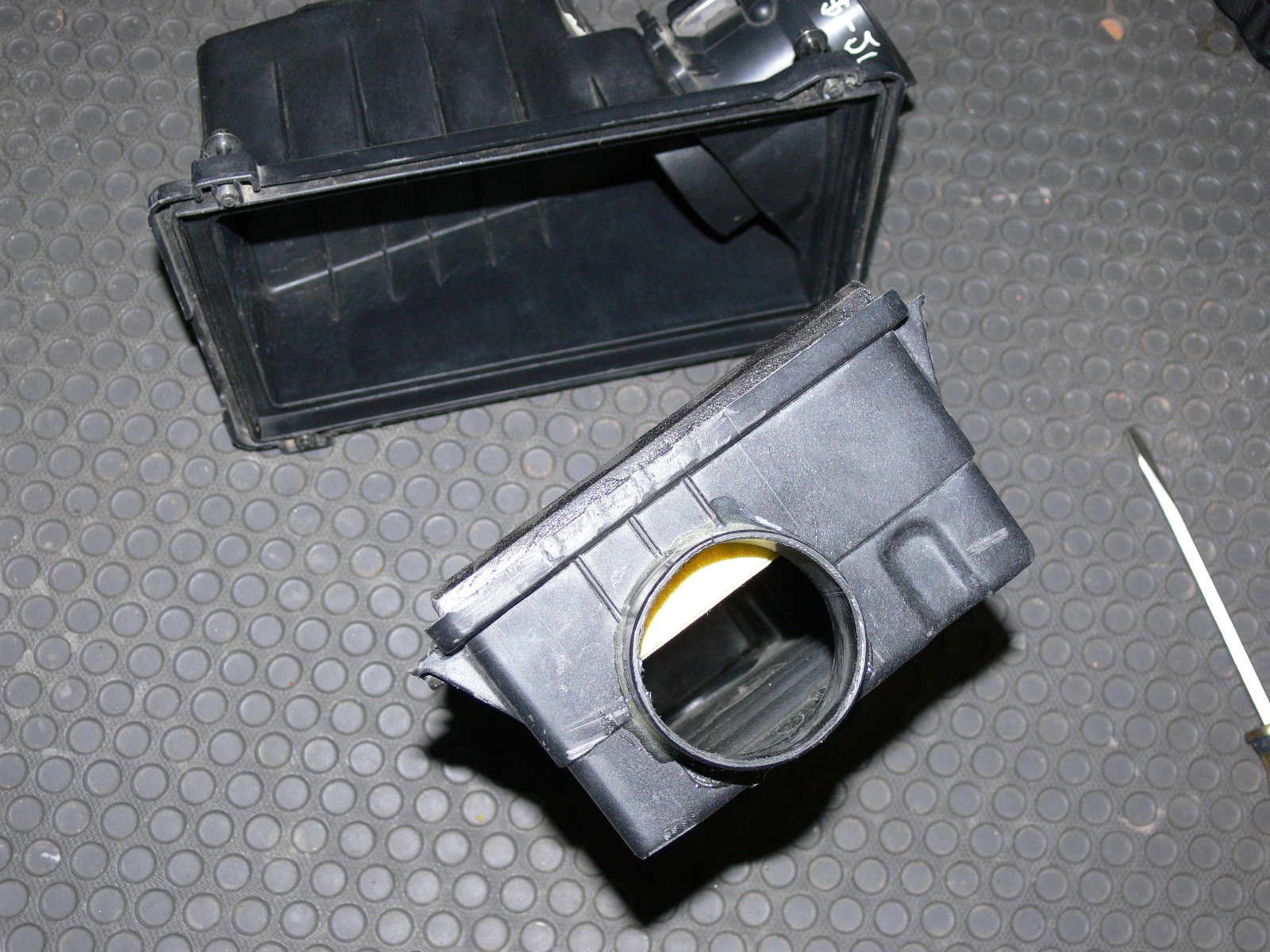

Here is how I modded my air box. It's not perfect but has worked very well for five years. It allows for connection to the stock snorkel.
It's very quiet even without the resonator.
My rig is using the old Group 6 setup with the ECU stuffed behind the drivers taillight. I really want to convert to the RG3/Cobra air intake setup so I can eliminate the long corrugated air hose!
It means a new ECU/ wire harness $$$, but has to give better performance over the long hose.
I'm hoping to do this mod when I replace my existing Zetec for a zero miles engine I have sitting in the garage.

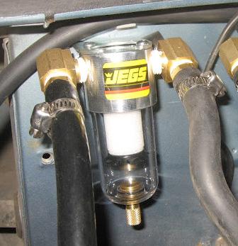

As far as the oil catch can . . . I added a separator in the same line between the PCV and intake (used Bostig's port) after finding what I thought was an amazing amount of oil in the intake manifold. Mine's not nearly as nice as yours, but I do like the clear plastic reservoir . . . . I would guess that I accumulate a couple of ounces every 800 miles or so (my usual round trip to and from CA). So my advice is to check it fairly regularly until you know what kind of accumulation you're getting.
Jed

I second the shortened pressure hose. Mine blew after rubbing on the muffler all summer. Ended up getting a nice shorter one and brazing on the stock fitting.

Good point on the heater hose/ATF incompatibility. The ATF may cause the rubber to soften and then collapse under P/S pump suction and lead to unpleasant noises from the pump. Had this happen on my Subaru conversion until I could find oil-rated hose to replace it.
