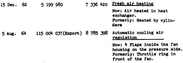

That's wrong, early 63 was still stale air. They did that from Mid December 1962 until August 1964 - that's 19 1/2 months.
