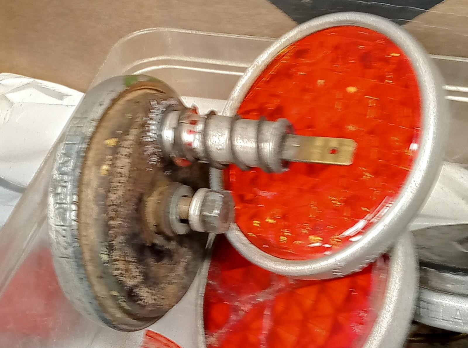

bally wrote:
Fab. Thanks Lind. I’m doing the same at the front and have the same issue at the rear so will look to follow your lead using the reflectors. I might experiment with motor bike LEDs
Many thanks. Dave
Glad to help.
The problem that I found with most LEDs is that they are intended to fit into normal bulb sized spaces. There just isn't much depth to work with in the reflector housing.
I should have taken more pics of making them. this is the only one that I got, which was right before I installed them.
Many thanks. Dave

bally wrote:
Very nice Lind! Do you have any more details on your rear indicator mod please?
Cheers. Dave
I generally like stock stuff, but I feel that semaphores are unsafe. So I decided to install blinky turn signals, but with no rear bumper there were not many options for placement on the back of the bus. I bored a hole in the backside of the reflectors, and put an LED bulb back there. It took me a while to find a bulb that would fit, as there is not much room behind the reflector. I used a maglite LED conversion bulb. I used a 6v one, but I would recommend using a 4.5V one, because the 6v one doesn't always work at idle. I used an instrument light bulb holder, and held it all together with with a section of an oil pressure relief spring. Those are the ingredients, it takes some creativity to make it work, and of course standard turn signal wiring. I had to drill a couple 13mm holes in the body also. For the front signals, I just used orange bulbs in the parking light sockets of the headlight buckets.
Cheers. Dave
