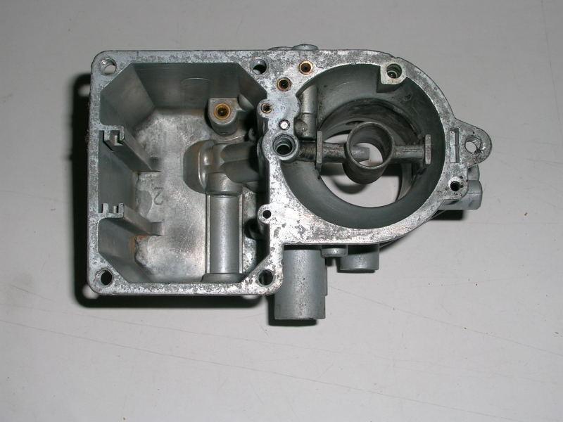

I put a stock carb on a 1600 dp with Scat C20 cam and it was pretty quick but it needed a lot more fuel at idle to make it work and pumped out a lot of fumes. Also an engine builder I used to supply parts to said anything more than an Engle 100 would't idle properly and would be unacceptable to the customers I actually supplied him cams milder than E100 before supply dried up.
How is the idle quality with these overbore carbs , larger displacement engines and aftermarket cam ?? .

Do you have procedures photo or video for bore steps?. One of the engines that I have is a stock 1600, will it make a noticeable change in power if I did it?

Or you can wrap a drillbit with sand paper. Drill it till it gets thin. Don't remove the Venturi .

Ian - there are two ways to go - if you don't have access to a nice shop or care to really take apart the carb.
Blackline Racing in Murray, Utah will remove, ream out and re-install the venturi for a little over a hundred bucks. Phone:(801) 747-3342 9AM to 6PM Mountain time.
You can buy one already done - http://vwparts.aircooled.net/Super-Stock-34-PICT-3-34-3-Carburetor-12V-Bocar-p/super-stock-34-3.htm

Anyone know where to get a bigger venturi for a Solex 34 Pict 3? I'm looking to keep the single carb for a while on my 1776 build and would love advice on the size I should go for.
