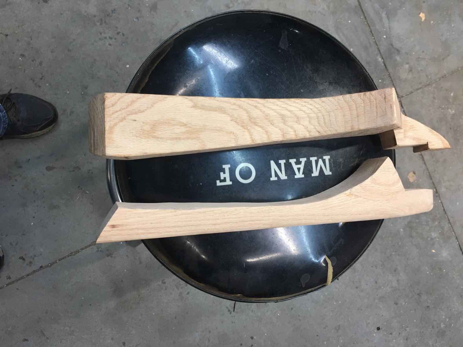

An update on self building the wood parts for the convertible top.
It is turning out not to be as difficult as I thought it might be. I glued up some oversized blanks of oak (I planed some flooring until it was uniformly flat) I then cut cardboard as a patttern that I fit to the car until I was satisfied with the curveture of the pattern. Transfered the pattern to the wood and cut it on a bandsaw. I was able to shape the wood on a belt sander until the fit was virtually perfect. On one piece I shaved off too much. I just shaved a flat spot with a hand plane and I glued on another chunk of wood then repeated the forming process until I was happy with the fit.
I will tackle the bows next but I am confident this task is easly within the capability of anyone that has a bandsaw and good bottle of Titebond 3 glue. I will post pictures when I get further along. My total cost of the wood bows will be less than $30 counting wood and glue.
Our hobby has its rewards and I am glad that I decided to build them and not just buy the parts. It is less about the money, though over $1000 for a set of bows seems excessive, For me it is about the pride we take in our craft
