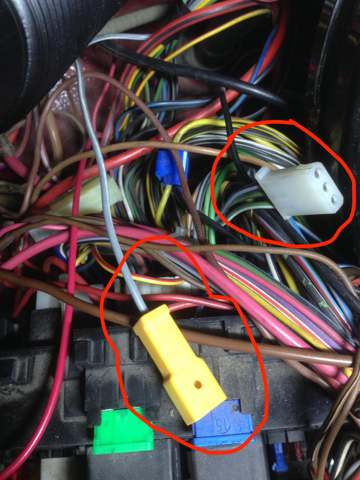

Brunswicken is offline
PostPosted: Sun Jul 17, 2016 7:31 am    Post subject: Re: Name This Part (engines, body, misc.) Reply with quote

Paulbeard wrote:
That rats nest looks so familiar. I even have the same yellow connectors hanging loose. What do those go to?
T3 Pilot gave me some info via PM. Need to check the engine compartment (control box, might be there)

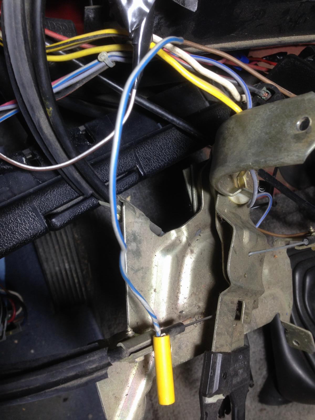

Thanks for the info. 61Scout, I'll test that blue/grey wire for voltage.
Paulbeard
Joined: July 10, 2015
Posts: 2611
Location: Seattle
Paulbeard is offline
PostPosted: Sat May 28, 2016 8:07 am    Post subject: Re: Name This Part (engines, body, misc.) Reply with quote

PostPosted: Sat May 28, 2016 7:04 am    Post subject: Re: Name This Part (engines, body, misc.) Reply with quote
The flat 3 connector is for cruise control.

PostPosted: Sat May 28, 2016 6:44 am    Post subject: Re: Name This Part (engines, body, misc.) Reply with quote
Bruswicken, not sure about the connectors in the first photo, but that wire (blue/gray) in your last photo looks like an illumination wire. Easy to confirm with a test light or volt meter... I bet it becomes hot when you turn the lights on.

Brunswicken
Joined: March 29, 2011
Posts: 32
Location: QC, Canada
PostPosted: Sat May 28, 2016 5:17 am    Post subject: Re: Name This Part (engines, body, misc.) Reply with quote
Currently doing a brake booster swap and came across some wires that were not connected to anything. Looking for some help identifiying what these wires are for. Van is a 5 speed '88 diesel Joker.
this one is located close to the temperature control assembly
