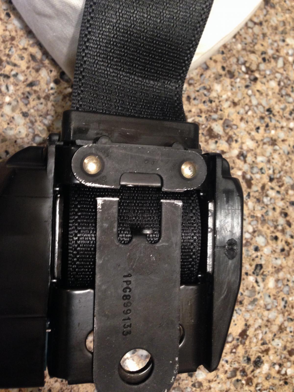

Since I am not 100% sure removing those silver rivets on the back is okay, I decided to (carefully) cut most of that thin back plate off:
I used a hacksaw (put Gorilla tape anywhere it might touch), then carefully filed the cut edge and dabbed some black Testors on the silver edges. I am hoping to find the hardware I need the the closest Ace Hardware I can find and get them in the car in the next day or so. Once that plate was off, I found that the raised bumps on the mounting plate don't quite line up with the holes in the retractor. I will need to carefully Dremel the outside edges of the holes to get the bumps to properly seat. It should help keep everything straight though, so it should all be good in the end.
Since it doesn't seem feasible to put these belts in the back and I couldn't find any non-retractable shoulder belts that are a particularly close match, I am going with end-release/Euro style lap belts in back. These seem to be the closest: http://www.retrobeltusa.com/product-p/278-xxx.htm , http://www.seatbeltsplus.com/product/1511-74.html . Anybody have experience with either? I am leaning toward the second ones, because that place also sells the black buttons that cover the bolt heads and I am hoping they will work on the B pillar mounts. I do think it's kind of weird that the female side on them is 34" long. I generally expect that to be the short side and it is only 17" on the RetroBelts. It is a bit shorter on the 60" option, 24", which still seems long to me. Anybody know what the typical bug specific lap belt lengths are?
Thanks, Doug

Thanks guys. I think I'm going to carefully Dremel those two silver rivets and hope that that back plate is the only thing that comes off. Since seatbelt bolt thread and diameter are standardized, does that mean the bolts generally have the same size head Question I ask because I want to get some of those black button things that pop onto the bolt head, and I'm probably going to have to order them. It would be lame if they didn't fit on the bolts once they got here…
I think the VW shoulder bolts I have will work for the B pillar mounts, although my 68 is missing most of the headliner in that area:
I plan to get a longer bolt to anchor that loop on the female side with a big washer, a short bolt with a nylon nut or nut with lock washer to attach the belt to the bracket and a short bolt and lock washer to attach the bracket to the floor.
Thanks again, Doug

I've also got the Humvee belts and modified that riveted bracket. In my case I simply trimmed the bracket and added a plastic piece where it rests against the rear seat.
You can look in the build, somewhere in the last few pages.
Those Humvee belts were literally a bolt-in, that little bracket mod was nothing.

b1pig wrote:
you may also need to remove the metal tab/flap thing thats on the back of the reel. i did by drilling out the rivets. (carefully)
So there is no issue with drilling out the silver rivets to remove that thin plate on the back?
I think it shows up OK in this picture, but I was surprised to see that the mounting brackets I ordered from JBugs have bumps on them that seem to match up with holes in the seatbelt mounting plate:
That thin metal plate with the spike on it is obstructing the holes and it doesn't seem to serve a purpose in this installation, so I would like to remove it. I'm hoping to make sure nothing falls apart if those rivets or Dremeled or drilled out…
Also, does anybody have spare hardware left over from installing their belts? The belts I ordered didn't come with anything extra. My 68 bug had 6 of the original 10 seatbelt bolts in it. Two of them are shoulder bolts which will work to mount that the B pillar hanger/pivots but with no room for a washer:
Looking at the Humvee hardware that came with the full kits, these two bolts and washers look like they would be perfect:
Anybody happen to have a pair of those bolts and washers left over that they like to sell? I'm not having a lot of luck finding new bolts in the correct diameter and thread, except for plain ones…

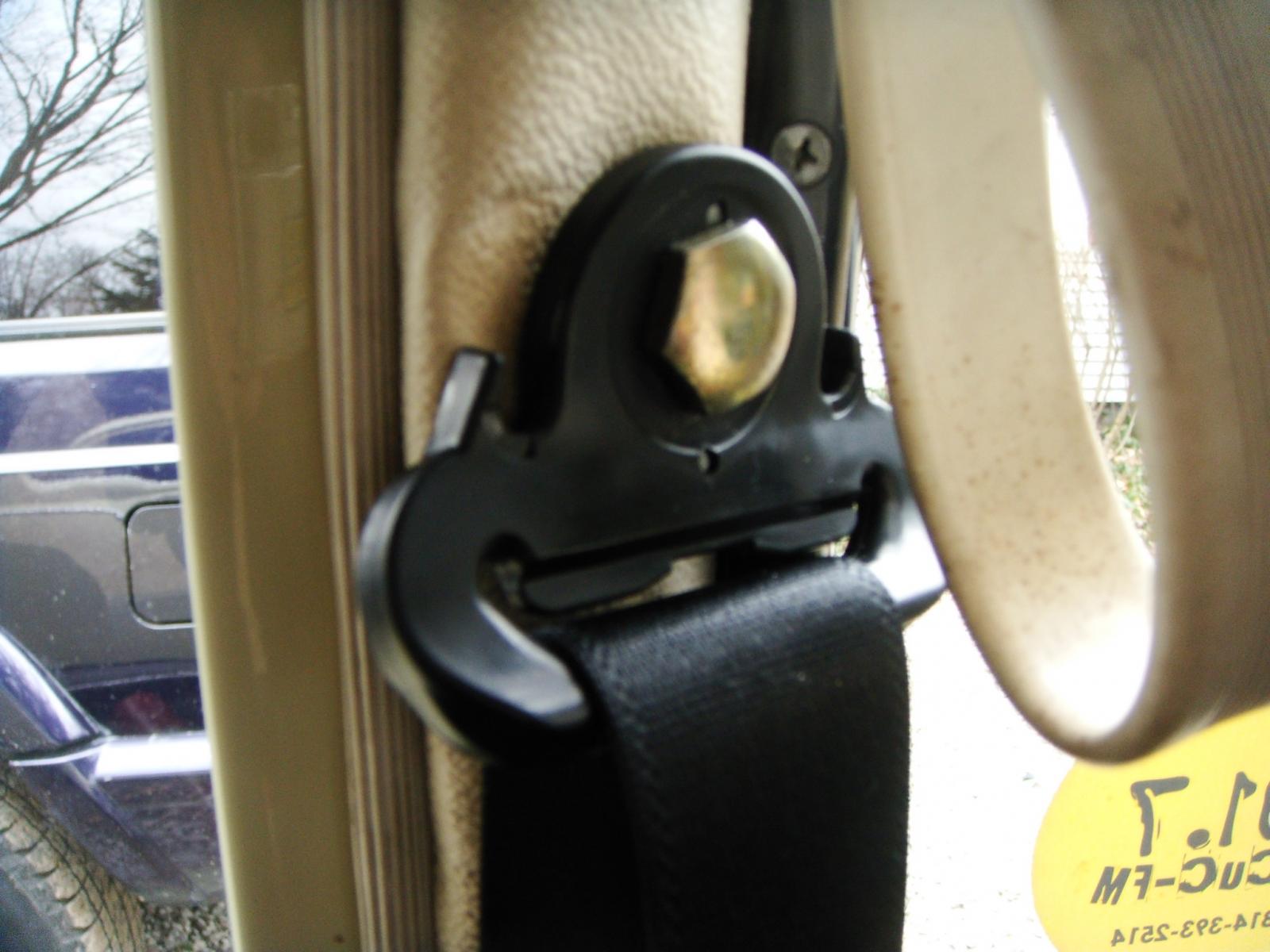

PostPosted: Tue Jun 07, 2016 12:52 pm    Post subject: Re: Seatbelts Reply with quote
Not my pictures, they're Motor7710's who I quoted from earlier in this thread. But yes I found these pictures to be very helpful for my installation.
69 Beetle - Daily driver
1600 SP (unknown history)
30 PICT 1 w/power circuit (Volkzbitz)

Hey Relyt,
Those pictures are exactly what I need. Thank you.

Motor7710 wrote:
Hope these pics help! Very Happy
There is thin slit barely visible allowing me to slide belt into place with no binding.. Razz
You'll need brackets and to drill a hole for the mounting bolt through to the wheel well. Make sure to use a good lock nut.
