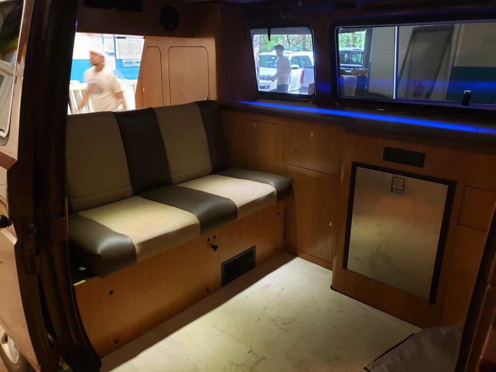

I've recently found this site (https://www.4yourvan.com), they're selling a modular set of cabinets for the Vanagon that seem to be vey well thought-out.
I have no affiliation and most likely won't install any their cabinets (my van is an original Westfalia) but there're several interesting ideas (the rear corner closet with the slide-out kitchen, multiple drawers in the kitchen unit, use of tambour doors, etc). The person who designed truly knew how to maximize the interior space.

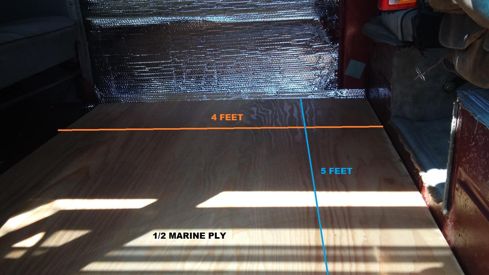

How did you get one sheet large enough? My dimensions were all over 4 feet.
It's a 4x8 sheet of 1/2" plywood, cut at exactly 5', side-to-side. It's a little short at the seat area (prob 3"). It would be nicer if the grain ran fore & aft, but what are you gonna do. Anyway, thanks for the idea on the ply. I did spend the bucks on it though. It's marine A-A grade. The single sheet was $75.
Also, I sprayed the inside of the van with Cosmoline before I put down the reflix insulation. A word of warning, that stuff smells terrible and toxic. I kept the windows open for a few days before I put down the insulation.
Note: There is a small amount of give/flex to the 1/2" plywood, so I would not go any thinner. This is partly due to the bubble wrap foil insulation underneath, and the fact it's not attached yet. I'm sure it will be fine once I bolt in the plywood & add the fridge & cabinets. I took out all of the factory foam on the floor. A side note, this wood and insulation is about the same weight or as the original carpet with the factory bottom insulation and the middle seat brackets. So, I'm still keeping it light.
Chestercopperpot wrote:
Euro dimensions go to 60 inches. Good wood supply shops will have euro dim ply for kitchen and bath box makers
Thanks. That's good to know.
Here's a markup for the next guy

Here's my blank canvas from yesterday. I'm test fitting the floor.
