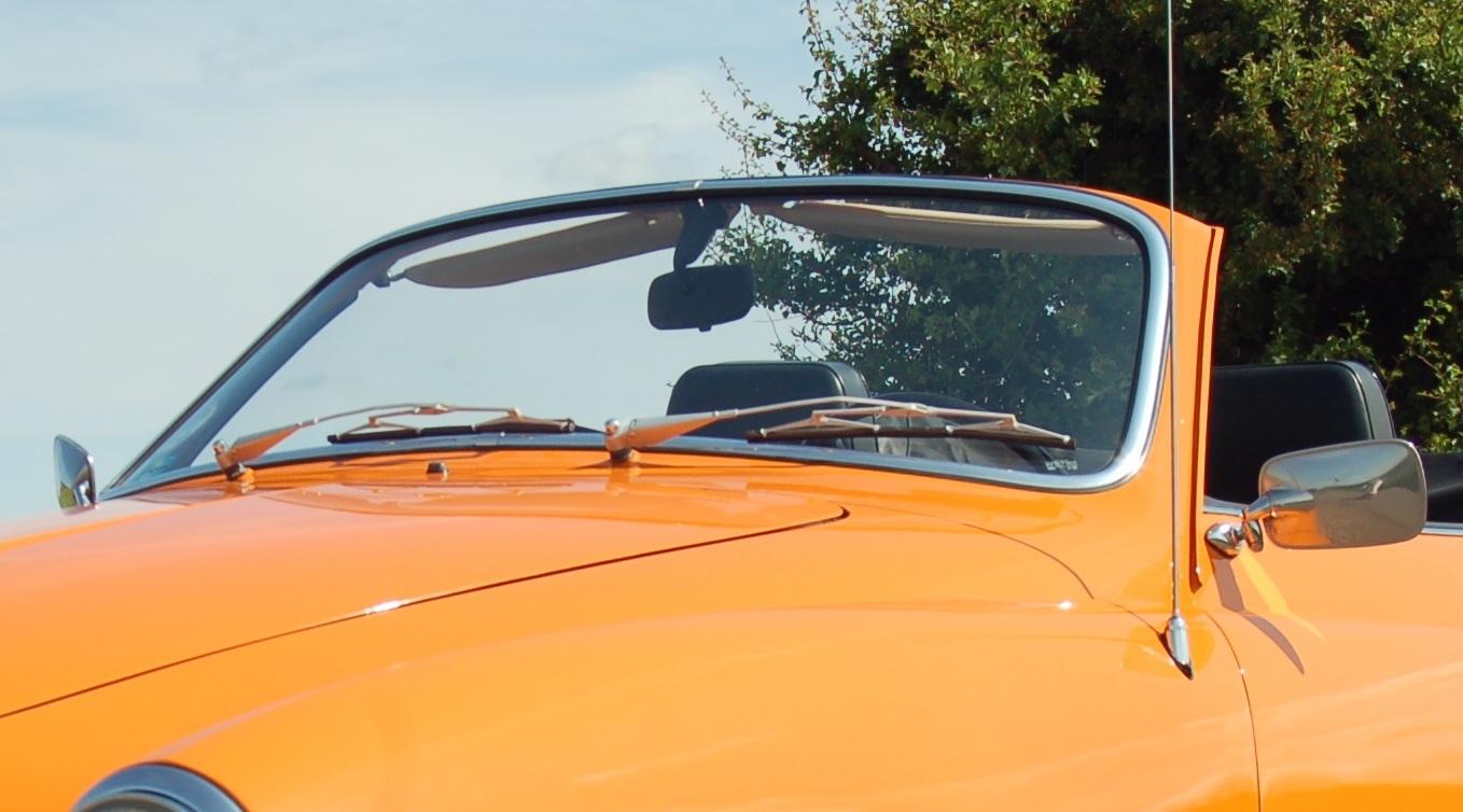

I have ordered several pairs of these NOS SWF wiper blades from this seller:
http://www.thesamba.com/vw/classifieds/detail.php?id=1364795
It says inactive, but I believe she has many sets left. Prompt responses to e mails, good communication about shipping and arrived quickly, as described.
Rubbers still in good pliable condition, but have glycerined them to keep flexible.
The packet says they a for 1967 ghia (I think) but they are 13" and fit the 6mm hook perfectly. Some pics to show the difference between the black (beetle) ones and the aluminium. It may be that the 73/74 models came with black wipers as standard, but personally I think these would look better!
Apologies for resolution, just cropped a bigger pic
The previous shorter blades v. V. V
