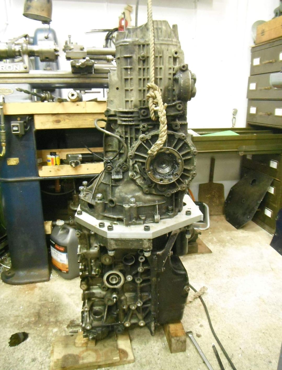

Hello from Russia.
Maybe someone will find it interesting -- Honda B20B + Passat b5 gearbox swap to T3. Run for about 20.000 now, gearbox feels fine, no sounds, no metall in oil etc. Car is not mine, just my country fellow.
If his gearbox wont die before summer, I will swap b20/b16 hybrid to my T3. I am a big fan of Hondas and T3 with b20 vtec sounds great, but revers running gearbox is my headache. Probably every time the vtec will kick in I will worry about gearbox lol.

What transmission is he using?
The transmission of choice is from a 1990 Audi 80/90 4 cylinder model 012
The beauty is the CV joints bolt right up.
You can also use the 4 cylinder Passat /A4 transmission, but the output shafts are not a direct bolt up.

PostPosted: Tue Jan 08, 2019 1:33 pm    Post subject: Re: Can the 1.8t run backward? Reply with quote
Zeitgeist 13 wrote:
When does that thing hit peak torque, like 6500rpms?
The B20B is not your typical honda engine the redline is at 6500. They are non vtec, it's basically just a standard 2.0 16v 4 pot similar to a VW only it rotates counter clockwise. In standard spec peak torque is at 4800rpm and it's a smooth delivery to that.
It's never going to have turbo torque figures because... well it hasn't got a turbo.
The carbs I have on it are jetted for midrange rather than peak too

I know this may sound blasphemous, but what about adapting a pre-2000 honda 4 cylinder engine to an audi transmission. They spin CCW naturally.
Don't get me wrong, very cool project and work to get a motor to spin opposite of what it was designed to do.
It's possible alright.
This is a B20B (well actually its the test block which was a B16 but it's the same)
Gearbox is standard and uses the standard audi clutch. The engine is also completely standard. All changeover is done with the adapter plate and the flywheel.
The honda management uses a distributor which gets in the way so I'm running it on 45s

I wonder if it is worth a mod to the thread title to say this is for the early 058 AEB ATW engines as Andrew has so kindly introduced the new thread for the 06a.
I fear the 2 threads will start to get quite cross contaminated with content between these 2 different motors...
Thanks again Andrew for sharing your time and ingenuity with us, along with the others to helped spur discussions, thoughts and solutions along the way. I am merely a lightweight amongst the heavyweights in this forum !
I am hoping when the time comes that the clarity of how you guys properly set the valve timing is universal between the 2 different 1.8t motors Smile hint hint, lol ...
Cheers everyone ...
The valve timing is identical between the early and late 1.8t engines. I'll be showing how to do that next.
