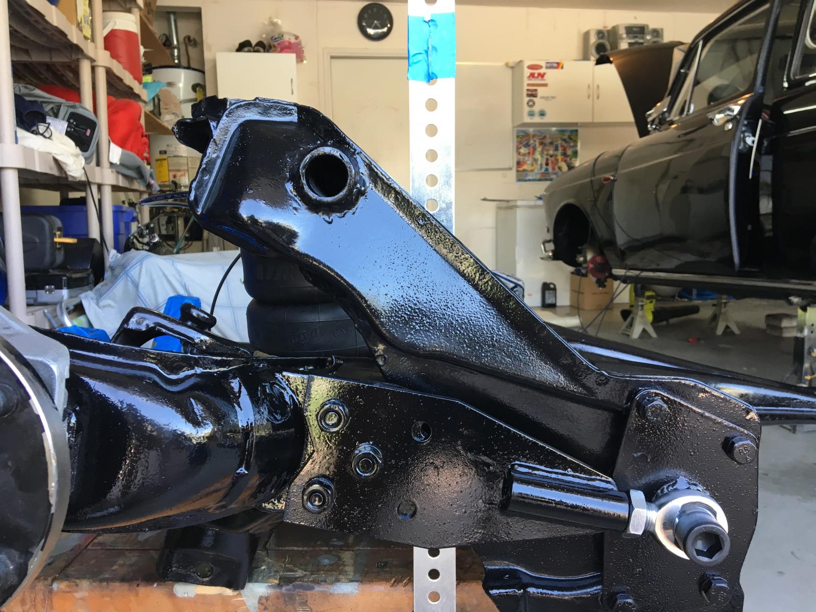

PostPosted: Mon Jun 10, 2019 7:38 pm    Post subject: Re: Rays 64 Notch Build Reply with quote
photo of subframe

PostPosted: Sun Jul 23, 2017 6:40 pm    Post subject: Re: Rays 64 Notch Build Reply with quote
UPDATE
So back in 2013, when I got the car the original plan was to slam it on bags. My only choice at that time was to fab something, which was not going to happen and not to mention the cost. At that time no one made anything for the IRS rear end for the type 3. Happy to say there is today ( dubonairsuspensions.com ) sells the rear kit that you weld on. I will have to pull the sub-frame out to weld the kit in. For now, I will run bags in the rear and air shocks in the front. Air management will be Air Lift Autopilot V2. Front shocks will be the Monroe MA803, I tried the MA785 but the 803's should give me an extra 1 1/2" rise. The rear torsion bars will be removed and run the long travel conversion kit from appletreeauto.com.

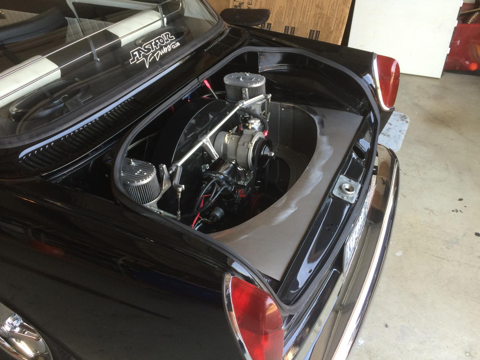

I'd fabricate some deck lid "stand offs" kind of like the bug guys use on their pre 68 bugs (with big motors and not slots in the deck lid).

vwfye wrote:
Were you able to seal off the lower and upper of the engine from each other like in the bug?
There are some gaps between motor and tin. So definitely not a tight seal like a bug compartment with all of its seals installed. But should keep temps down and road debris out. I did open up the area below both rear cowl opening to bring in fresh air.

Finally got sheet metal finished in engine compartment. This metal work was high on my list of work for the car when it was being built and just kept on getting pushed. Now time to enjoy the car for the summer and then think about re-spray body again. Most people don't see the flaws but I can see them all Evil or Very Mad
