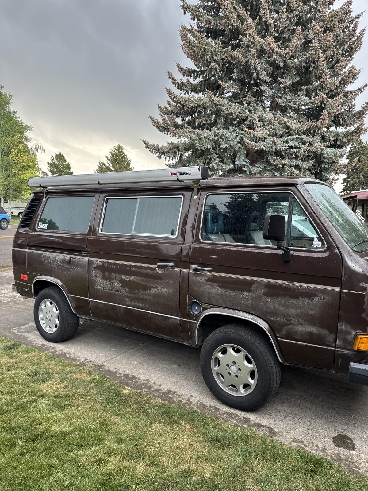

Added the third GoWesty bracket.
Even with only ~1,000 miles, I was seeing a little bit of stress in the t-slot.
If you're going to go with the hard case, do not just use two brackets.
40 lbs doesn't seem like a lot, but stretched over 8 feet down bumpy roads will do a lot of stress in the middle.

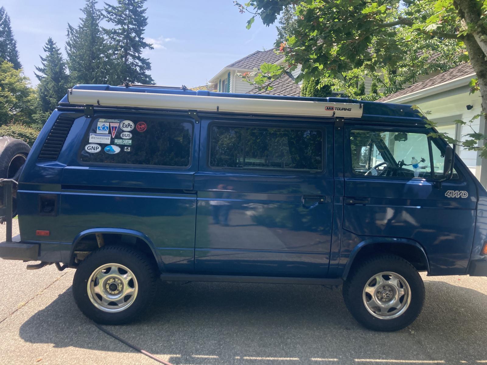

ProbablyNotIan wrote:
Finished the install this morning in a rain storm, which seemed somewhat poetic.
I was able to do the install mostly by myself. My partner came out for about 3 minutes to help me tighten a bolt. Might actually make a quick video on how I did it, not that I recommend anyone try it.
Not even moving down the road with it, I can see how there needs to be a third bracket, so I guess I'm putting in another order to GoWesty.
I see that you’re installing the brackets with the extra bolt on the side, I think that’s wise. I just finished installing the same awning using 3 brackets from Van-Cafe, and I opted to do the same, added an extra bolt on the side to ensure that the awning is solidly attached (and not totally dependent on the rain gutter).

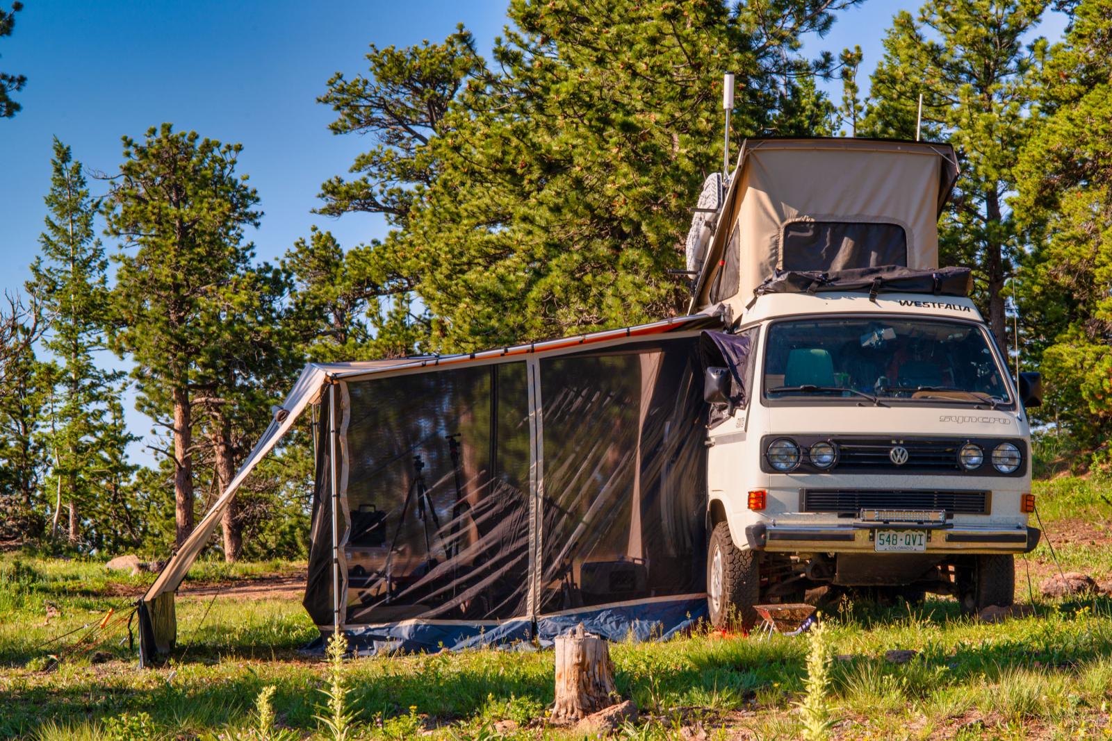

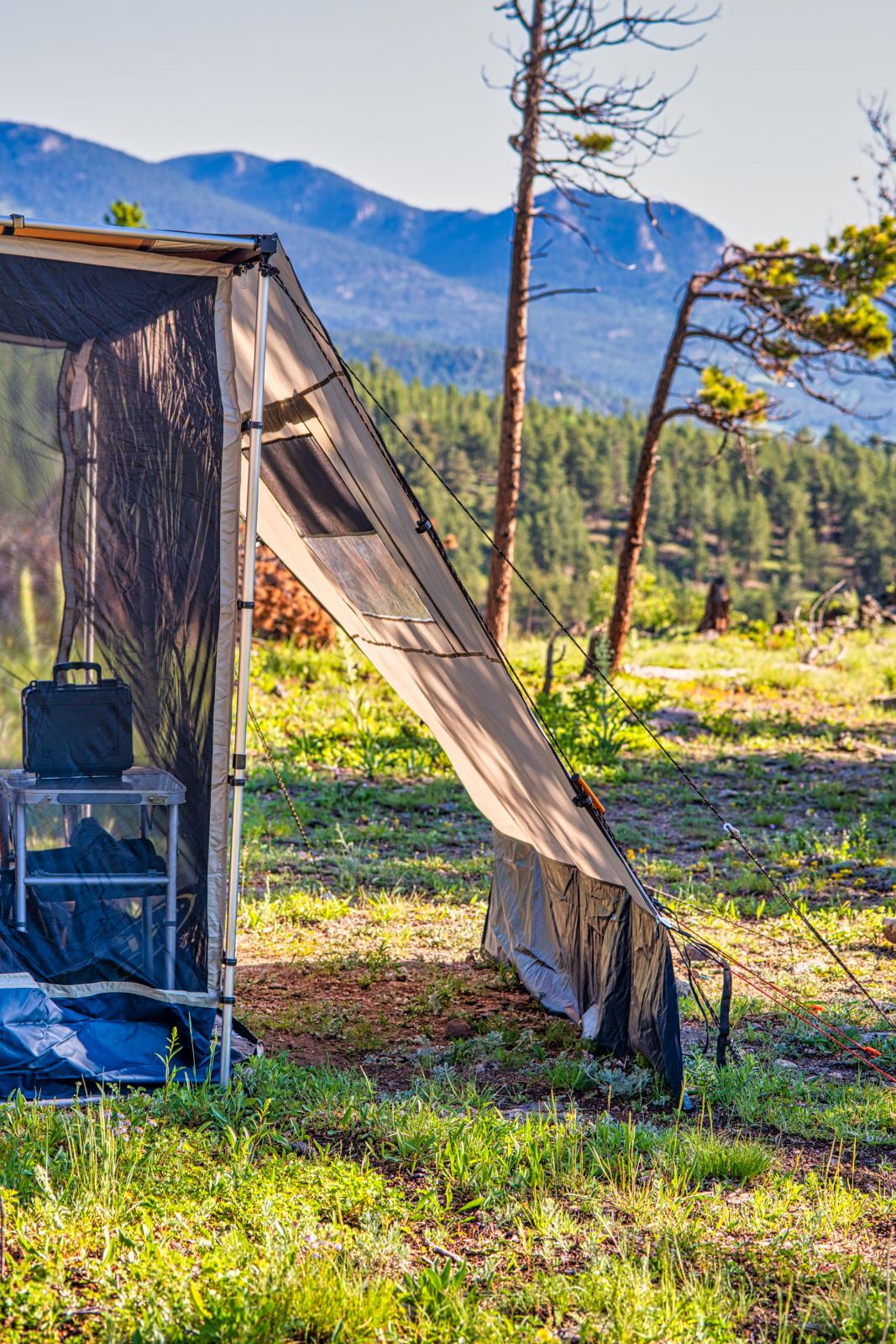

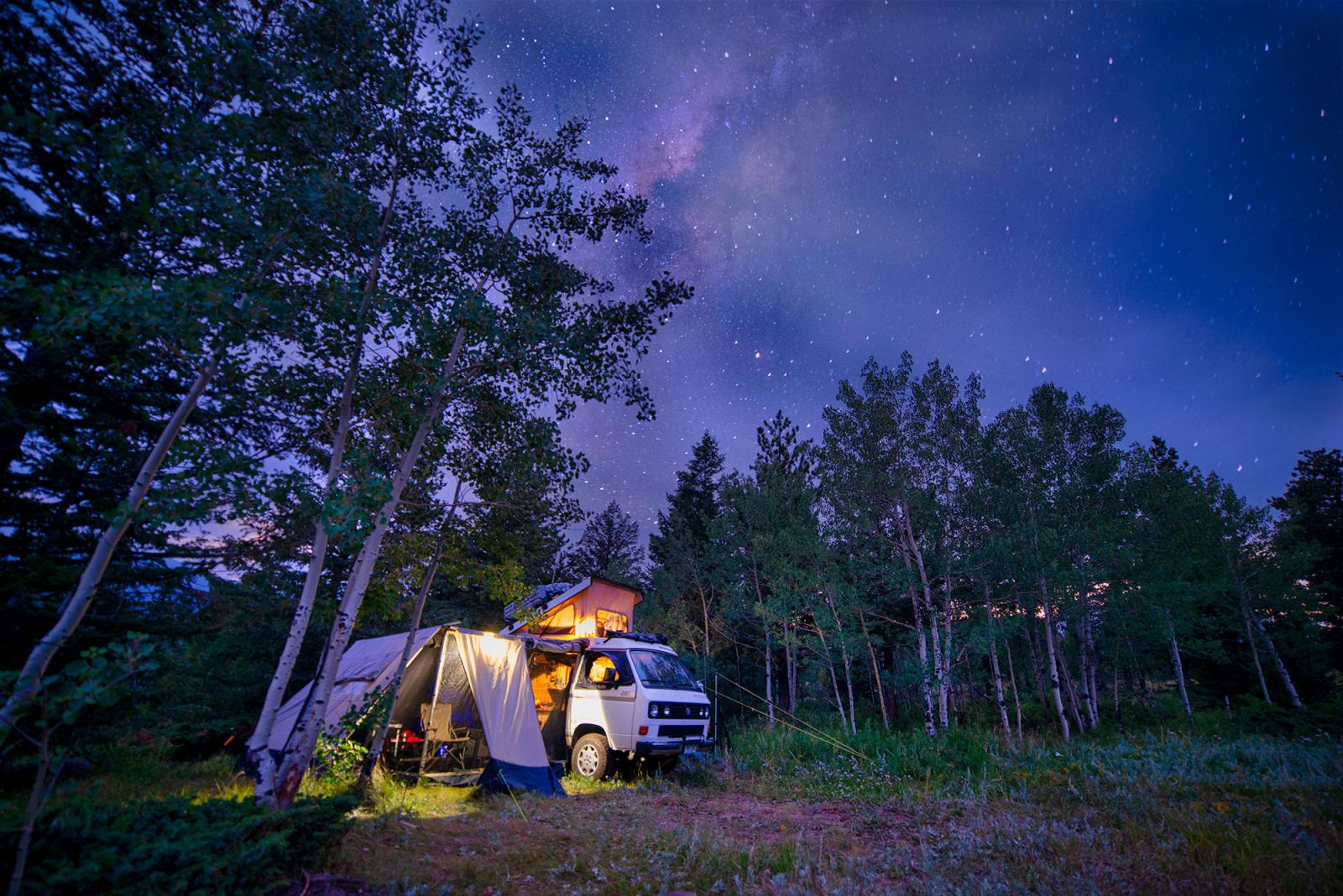

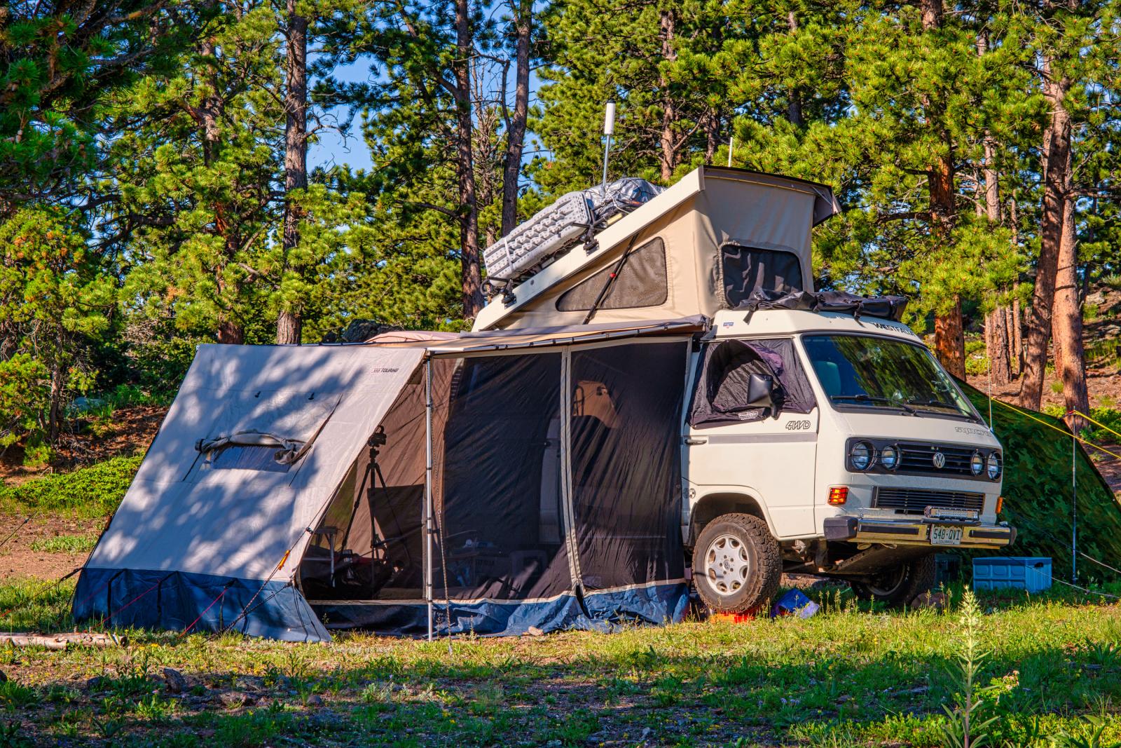

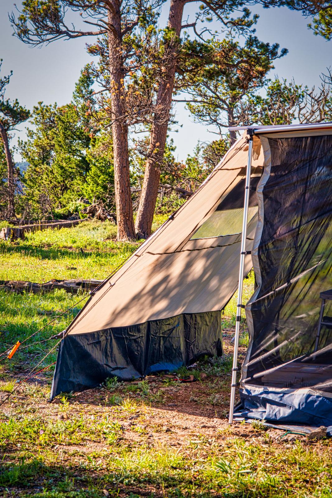

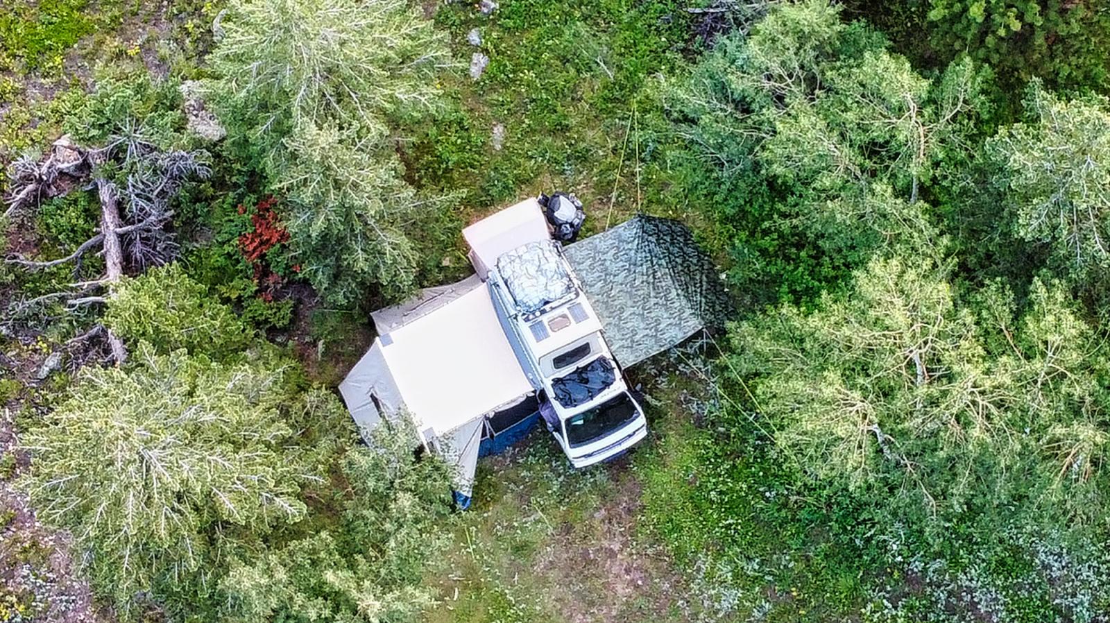

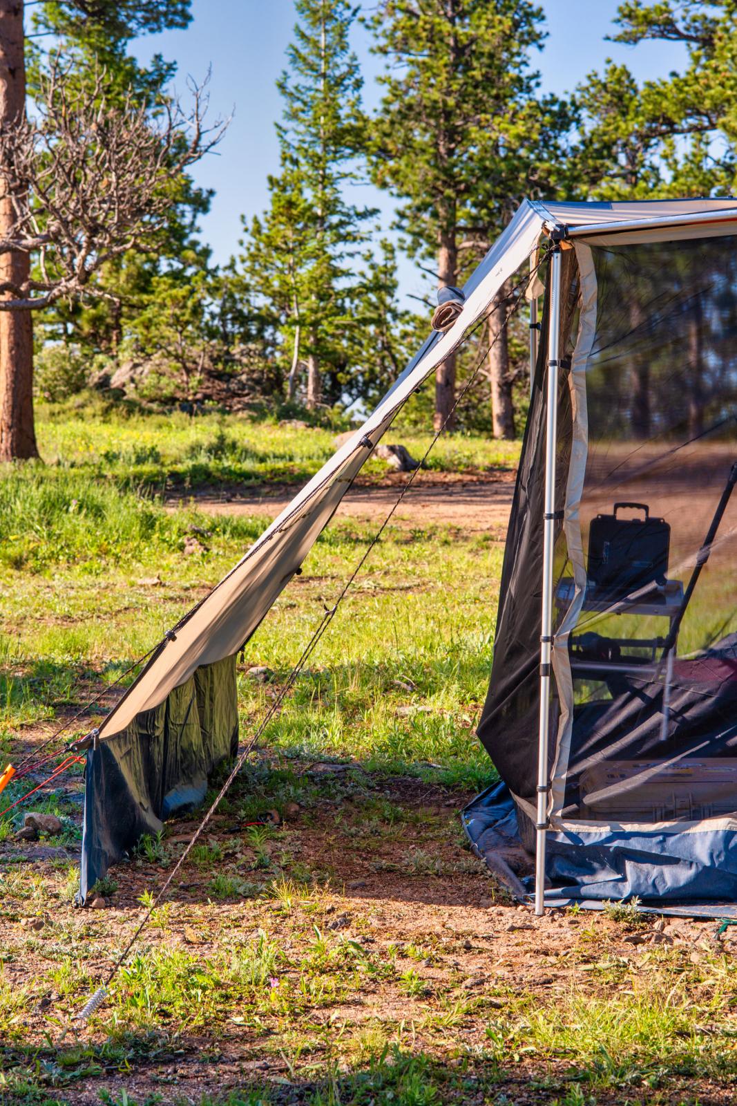

And the experiment continues! On this camp, for the first time I used all three of the 3-wall tent sections added to the screen room for extra rain and wind protection. For the side section with the door, I rolled up one side to keep as much view as possible, but could roll it down and zip it up when it rained. It rained a lot during this trip and the additional protection was fantastic. They also create quite a bit of extra protected space for tripods, water containers, etc. The two front corners are exposed to the elements, but it still offers a ton of extra protection.
A couple of night/star shots just for grins Very Happy
Drone view from above. My goofy tarp setup on the driver's side is working great for additional weather protected space and is the perfect place for my gas generator and other stuff I want to keep out of my "living area".
With the entry area all rolled down and me pondering about how much of a pain it will be to enter via the zippered entrance, with another zippered entrance to the screen room right behind it. A tripping accident just waiting to happen... Trippy Zippers!
Then it occurred to me that I can just enter through the side... much easier!
All staked down and ready for wind and rain. This also pulls the wall out a bit and makes entering from the side a little easier.

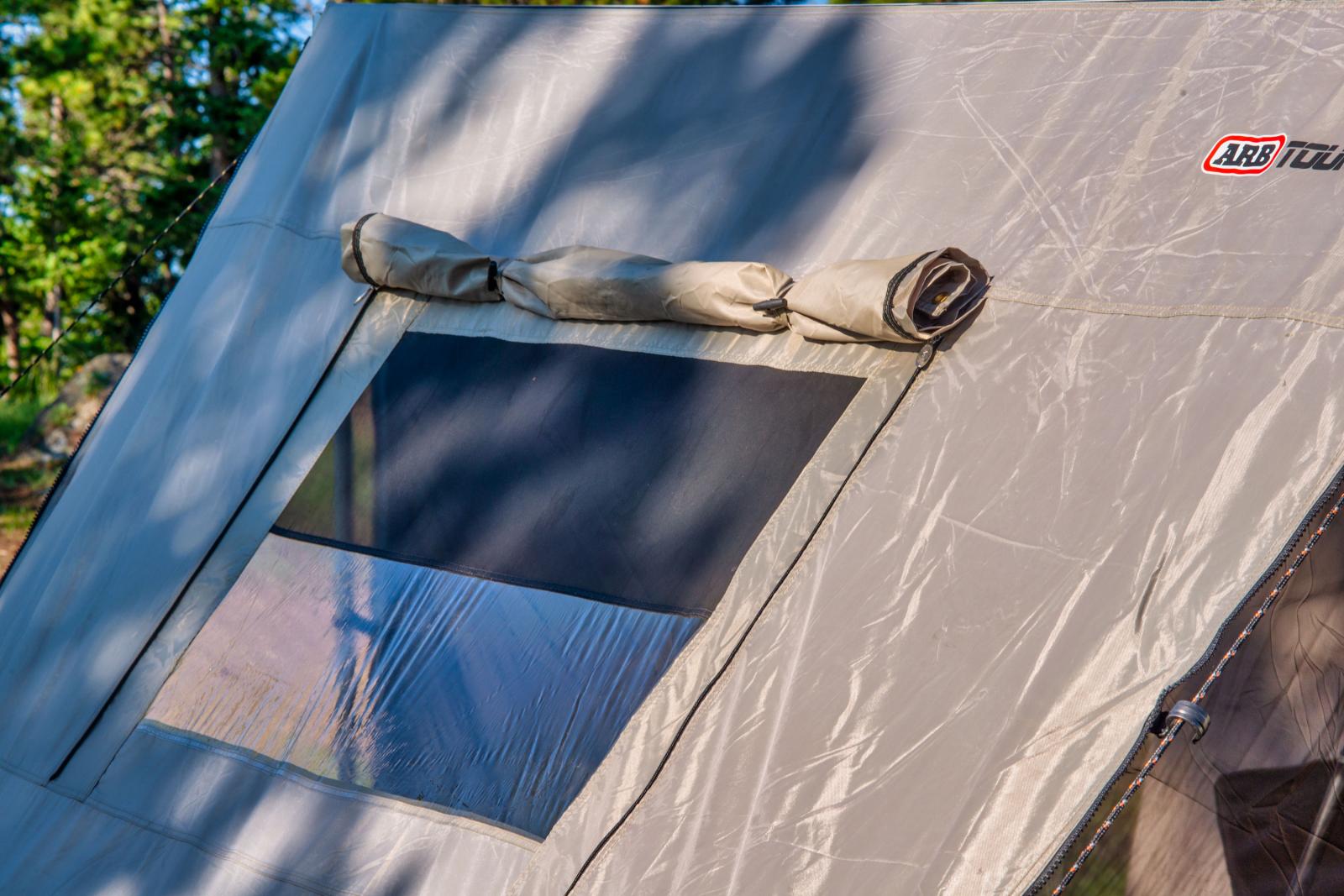

View from the inside showing exposed corner. Note that the two windows on the 3-wall tent have two sections. The bottom half is clear plastic and the top half is mesh. I roll mine half way to maintain a view while keeping the rain out. They can be rolled all the way up if the weather is nice for even more views and allow the breezes to flow through better.
I think I have taken the screen room/3-wall tent experiment about as far as I can take it now. I'm very happy with the results. The screen room by itself it great until it rains hard with any wind. The rain hits the fine mesh of the screen room and "mists" everything inside. This really keeps that to a minimum. I suppose the newer ARB "Awning Room" accomplishes a similar result, but this is what I already own.

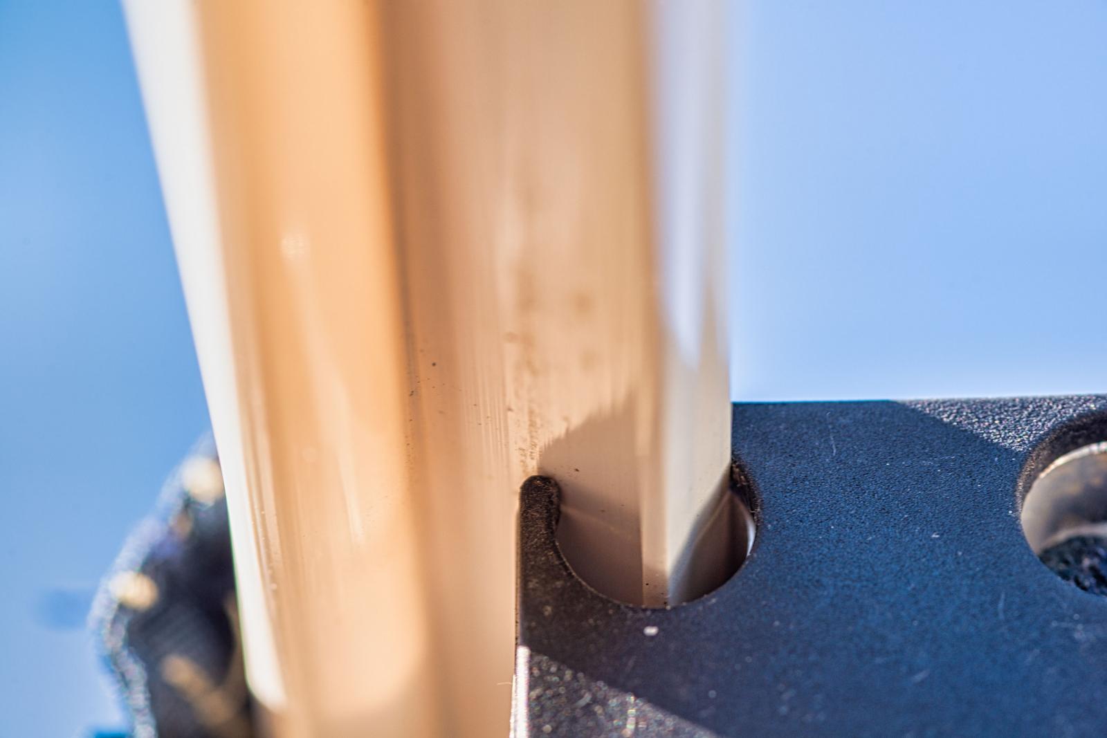

Vanlife Geek wrote:
I just finished another 2 weeks in the forest and got to play with the awning configurations a bit. I had ordered the "RV TwinTrack" gizmo that slides into the existing front track on the ARB and provides two tracks. This enabled me to deploy both the screen room and the front wall of my 3-wall tent as a wind/rain break. I had been curious if this might serve the same purpose of the actual ARB Wind Screens. I think it pretty much does the same thing, so I guess I won't be buying the Wind Break. Or am I missing something?
I will say that the RV TwinTrack is a bit difficult to work with. Maybe it's an ARB thing, but sliding on the attachments using the track is not nearly as smooth as the existing ARB track. The fabric catches on the ends, making it a tough one man job, however two people should have no problem with one feeding it in one side, while the other pulls from the other. I think I'll try to file down the openings a little to see if that helps. Since they come in 3' sections, that adds another layer of difficulty, but again, doable. Otherwise, a success.
RV Twin Track - Come with six 3' sections
It's sort of a square peg in a round hole situation, but it works.
This windbreak has a window!
By the way, this dispersed camping site was one of the best I've ever had. I've camped in this area for years, but didn't know about this site until I was looking at the area on Google Earth and found it from space! Lots of room and stellar views.
Now, off to find another great site for two weeks.
Nice work! Keep the updates coming!
