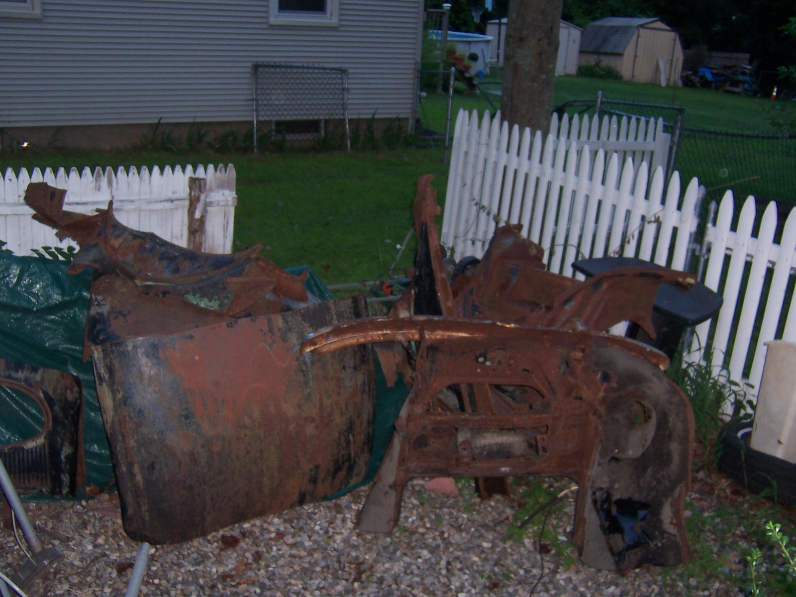

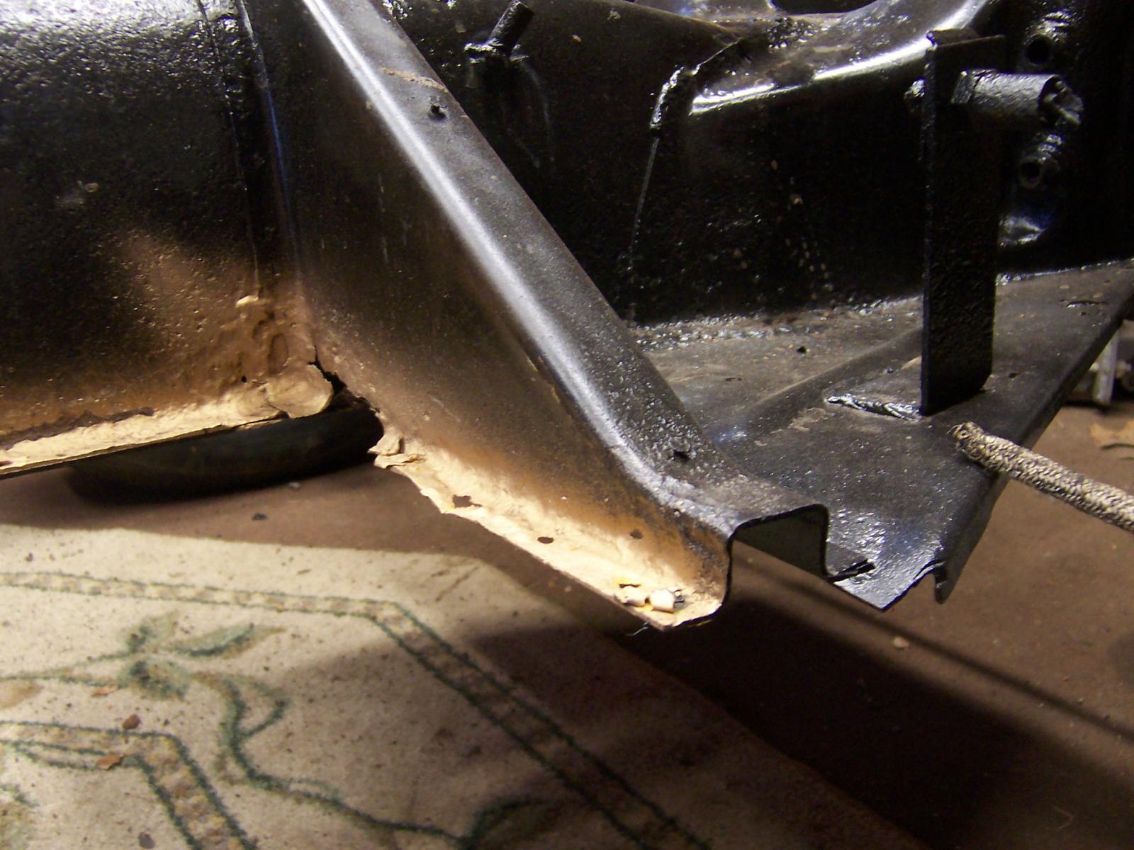

Almost ready to put the new old floors in. Both these sections on this chassis were rotted and hacked. Got these two great ones from Randy in NC , thank you once again, Sir! Now it has nice solid pieces here.
Very Happy Now I just have to replace a few sections along the tunnel where holes are and the surrounding metal was too thin to weld up.
I will replace more than this, the metal is deeply pitted and I don't like leaving it like this.
Then there's the Napoleon's Hat and the bottom piece just below it, that has been cut for some reason.
Why do people do stupid things like this! But work trudges on.

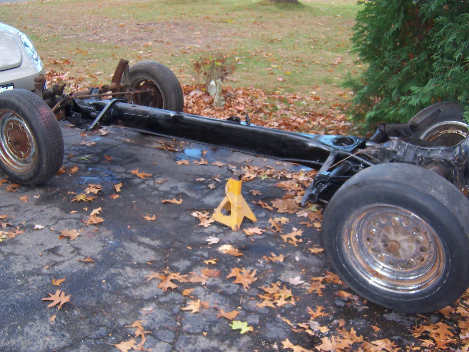

The chassis I got with the Zwitter was a 58 and very butchered, all conduit tubes rusted, broken or clogged, trans mount hacked. So I found a 53 one! I got a great deal on it from Clay Smith in CT, thank you again Sir! I put on a roller front end and tranny to make it mobile while I fix it. It has a few holes here and there to weld up. The Napoleon hat was also hacked. I located some original floor pans, ebrake, shifter and looking for a pedal assembly. Here it is so far.
Still a long way to go!

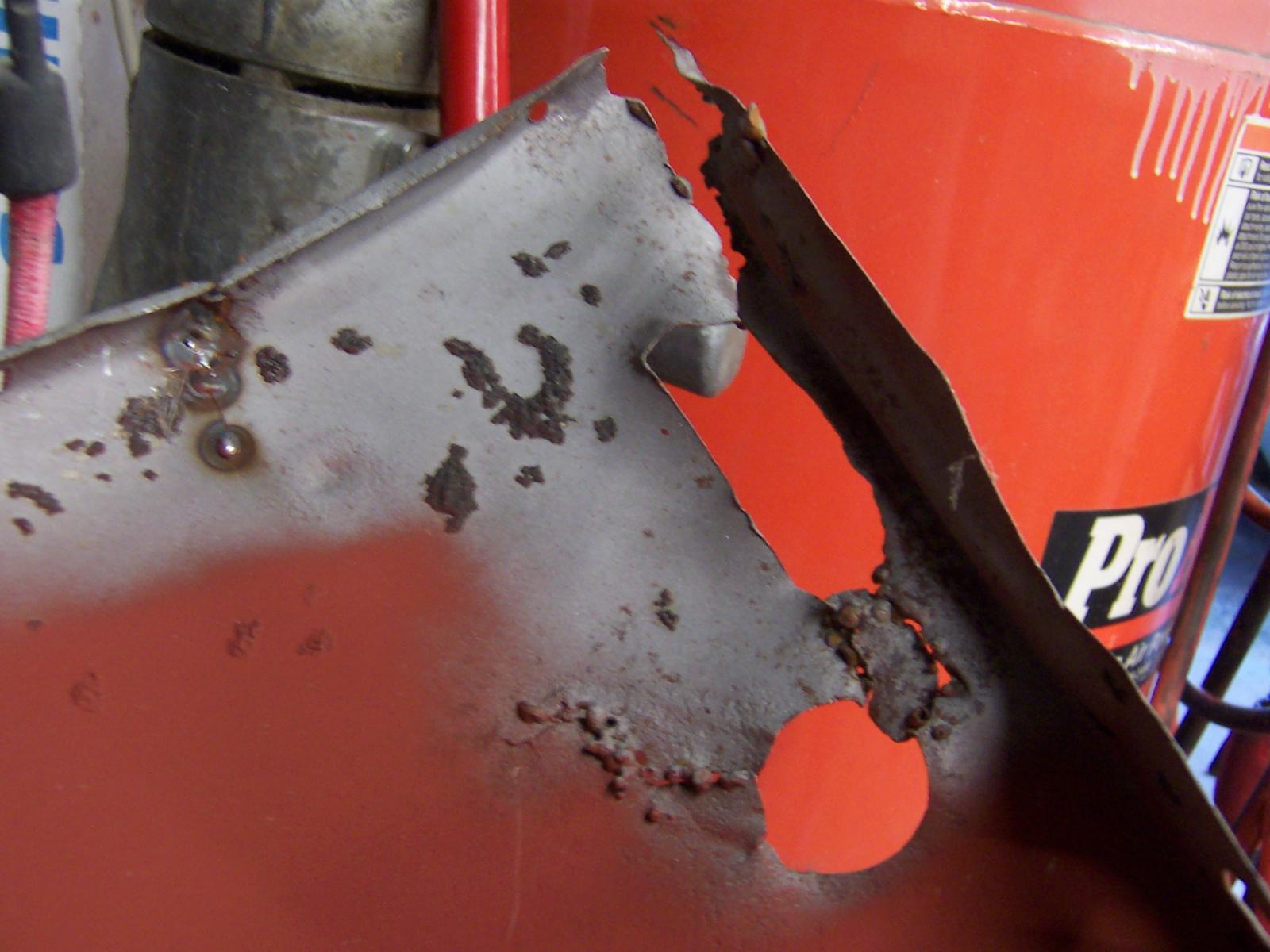

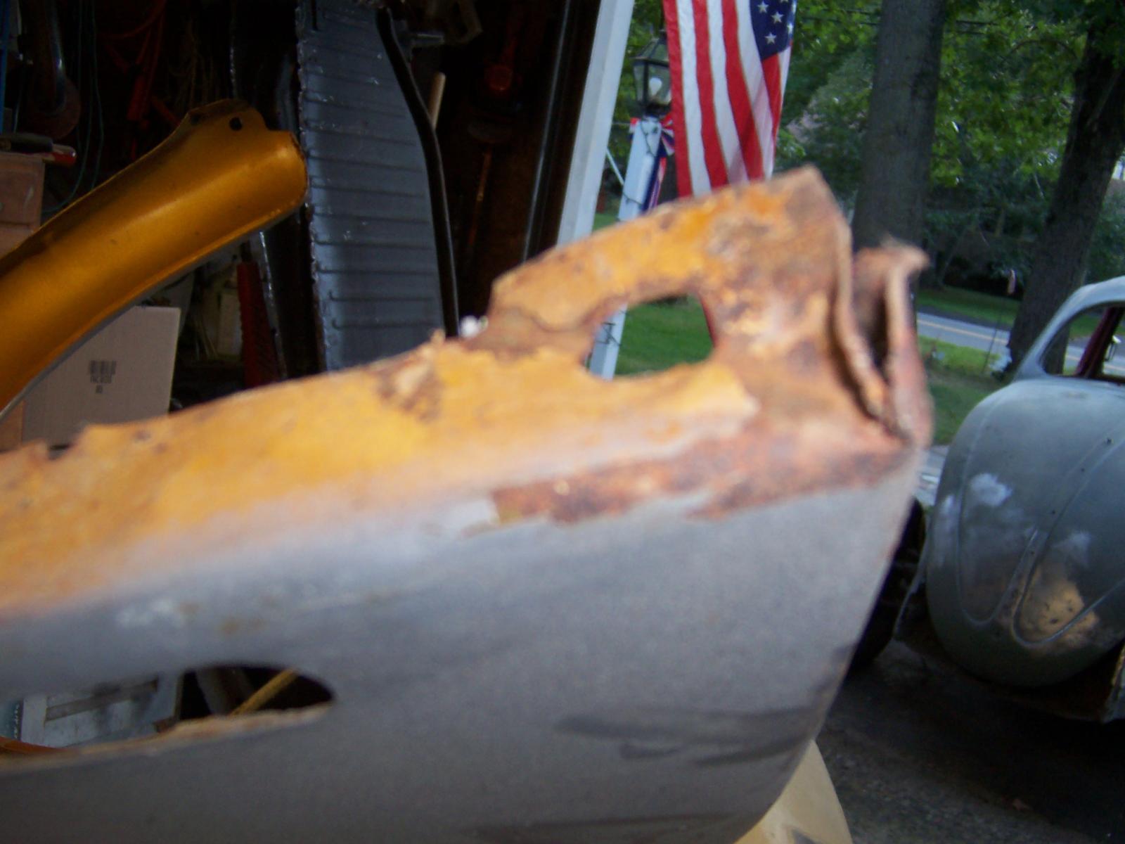

I took a break from soul crushing sanding to start fixing my bargain rear fenders. The left was the worst so I am starting there.
There were issues allover the fender but the rear section was the worst. Mangled, hacked and with chunks snot welded on.
The back was nice too. I had added a couple quick spots to keep the cracks from getting worse.

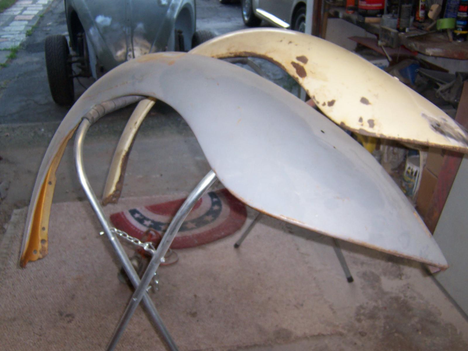

The original idea was just to cut out that section and splice it in from this original junkyard bargain (free) fender I had. Upon sanding over 1/4 inch of bondo I found it was just as mangled. So that was that.
Then I remembered the pair of rear fenders that came with this car, they were repro and I had no worries over hacking them up.
There's the left one, doesn't look too bad!
You can tell it was from this car... friggin GOLD.
Excuse the blurriness! I was amazed at the unbelievably shoddy design and construction of these fenders, thin as a beer can, badly formed, shaped all wrong, even! I couldn't use this!
So here is the old fender, I sectioned a new piece in where the overrider hole was and met it with the bumper bracket hole area. This is after LOTS of cutting welding, grinding hammering out caved in areas and more.
Numerous sections here were gone so I spliced some I had gotten from a nice fellow on this site. So that's it for fenders today as it started to pour out and I had to put the car back inside.

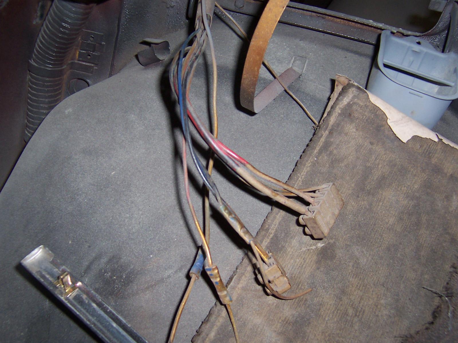

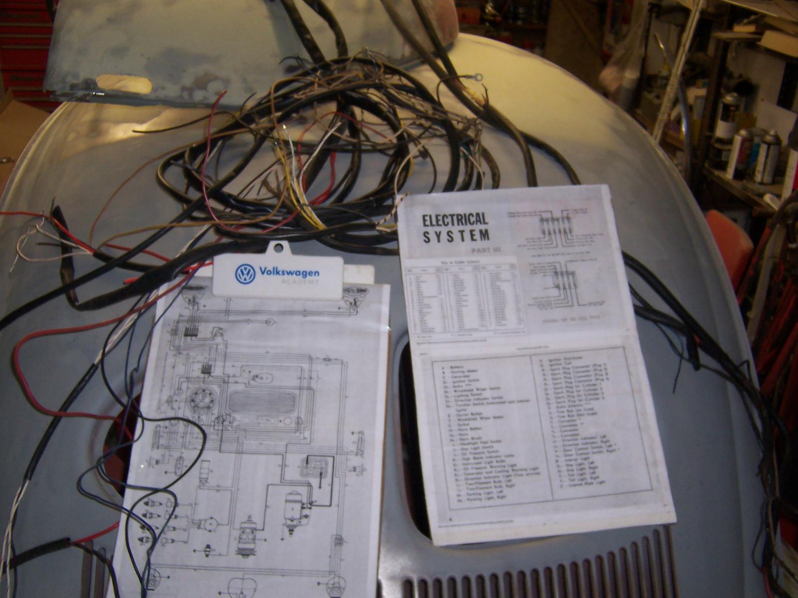

Moving on to the wiring!
The car came with a mystery unidentified but new harness! I had nothing to compare it with as so much of my wiring was missing or butchered! Then I bought a rear clip and remains of a front section form the very kind and excellent Clay Smith in CT! That car's harness was pretty much all there! So I scavenged the entire thing out of it and compared them as it was an early 53 oval which seems to be the same wiring as my (mostly) Dec of 52 car. They're nearly identical! I need to add a couple wires here and there but I think this can be made to work!
Printed out some of the very nice diagrams out of the technical section and did a packing tape laminating job against some cut up FedEx boxes to make handy big diagrams!
Here's the remains of the original rear harness. It's burned, spliced in with all kinds of butt splices, tape, twisted in wires, all very nice!
Here's the remains of the wiring coming out the windshield pillar and all terminating in these blocks. I'm assuming this is wrong? There is nothing beyond this! Someone took the rest of the wiring out, maybe for the bitchin racing wiring that must have once been here?

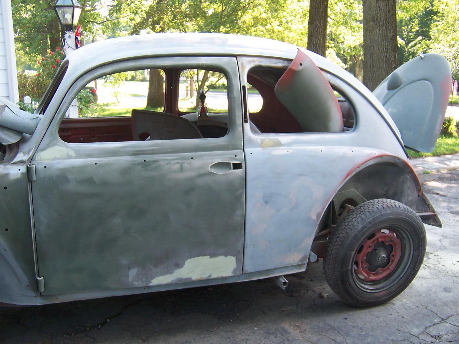

I'm doing more and more work on this mess of a car, trying to straighten and smooth it out.
The right front is more or less done. Have to patch up 3 holes where the spot weld cutter went through.. ooops.
Cleaned up some old but questionable patches in the left front. It is solid and not really noticeable once together so I'm leaving it.
The right quarter is more or less straightened, so is the left one, just need to fix a small rust spot at the end of the driver's heater channel. Oh and converted the right standard door to a deluxe door! It's an arduous process of drilling 5 holes.
Finally today I'm trying to tackle the roof, which is a disaster, can't tell in the pic but it looks like it's been through several hail storms at once.
This is after using a shrinking disc to get the really big dents out! There's a skim coat on there now and I'm sanding and sanding and then sanding more.
