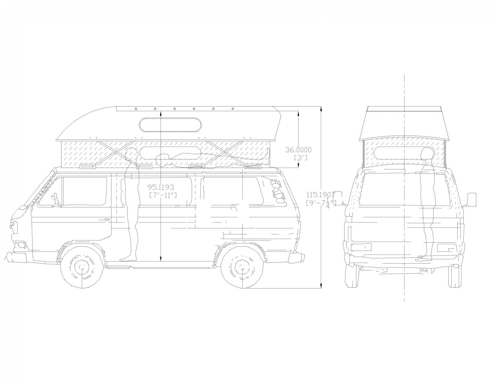

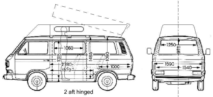

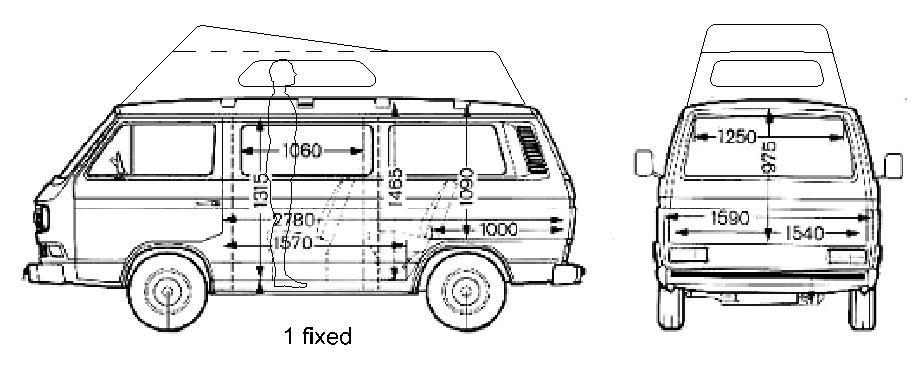

Which hightop version is the best?
I like version 1
1%
 1%  [ 2 ]
I like version 2
13%
 13%  [ 14 ]
I like version 3
39%
 39%  [ 40 ]
I like version 4
24%
 24%  [ 25 ]
I like version 5
0%
 0%  [ 1 ]
I like version 6
18%
 18%  [ 19 ]
Total Votes : 101

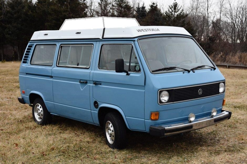

Gruppe B wrote:
OddN wrote:
...more in the lines of the original Joker 5:
Awesome! Is that factory? I've never seen this before.
This was part of the early "mosaic kit" non factory fitting kit.
The higher rear part was for the bed to fold into due to the roof being curved,
not flat like the factory roof.
Westfalia later changed the kit to the folding part of the bed to be in two pieces( hindge in the centre) to allow for the conventional flat roof to be used on aftermarket fitments.

PostPosted: Sat Aug 17, 2019 9:38 am    Post subject: Re: Aluminum High top design Reply with quote
[/quote]
Why do you keep saying "alas"?
Are you upset the project is finished, or unhappy with the final product?[/quote]
I guess I was tired. Not sad the project is over, more relieved. It took so long and it was so embarrassing when people would ask me if my van was done yet and I’d say, ‘not yet’ and they’d look at me with this shocked look like ‘what mess did you get yourself into?’ And I’d feel this shame/anger, then ask 3dig for status etc. things happen, (to some more than others). Eventually I just told my brothers to stop asking me about it and I’d let them know. Haha.
If I were to go back in time I wouldn’t have done it and just figured out a way for my kids to sleep either on the floor or on a cot strung across the front seat or whatever. It’s nice now that it’s done but probably not worth it.
It’s great on the inside now, from the outside it’s just a bit too tall and looks a bit like a kid wearing a top hat or whatever.
I’ll look into that idea of just getting an electric knife and going from there. I’ll try and post a video and photos on here soon.
