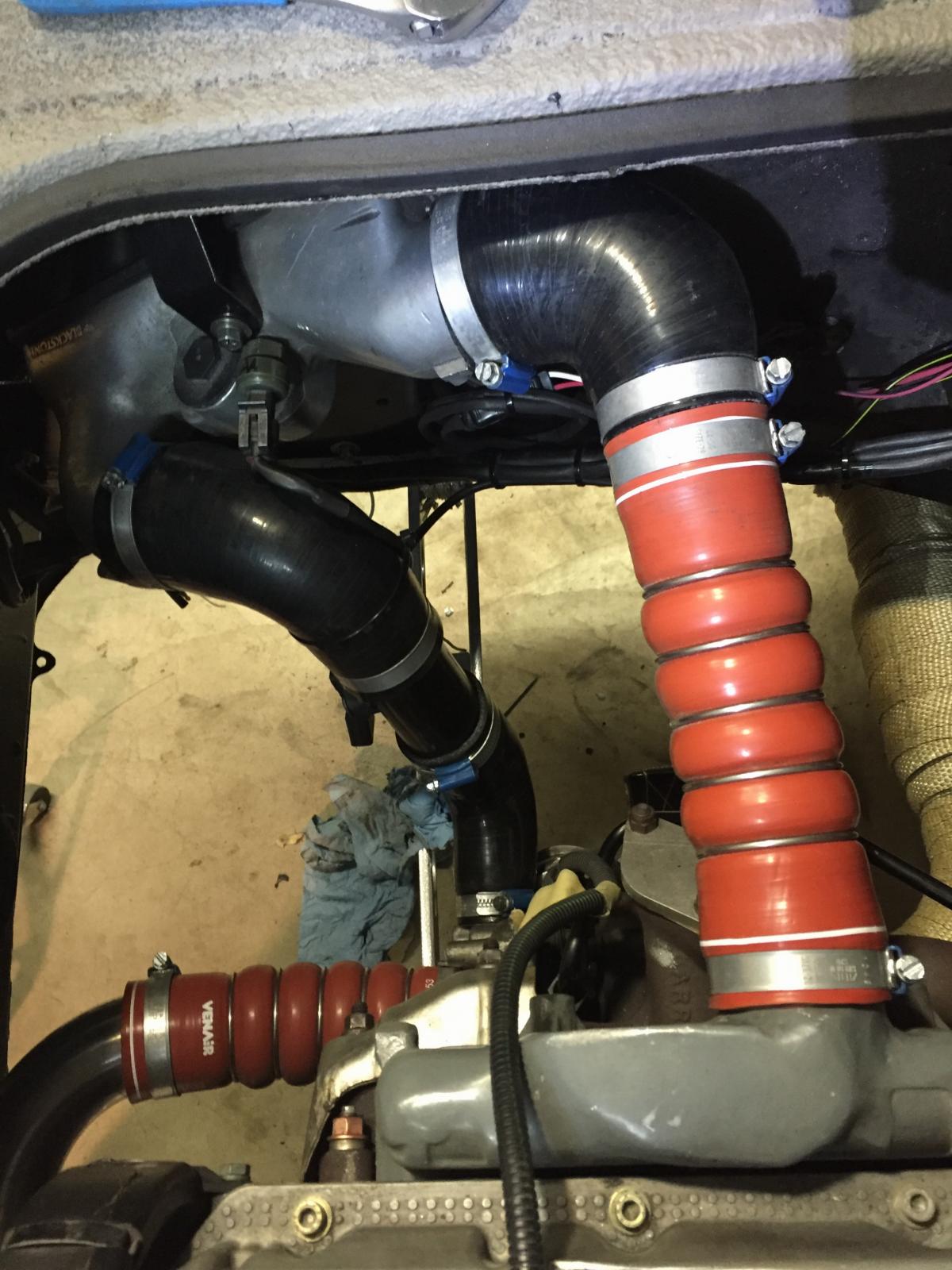

rmcd wrote:
Aaaaaagh. Face slap. I just figured out the systematic error that I have been making this whole time.
I am measuring IATs after the turbo (via the tmap sensor) and before the intercooler.
It took starring at this picture for a minute ....
I need a new temp sender inline AFTER the intercooler. Yes. I'm a dork.

PostPosted: Thu Nov 19, 2020 2:32 pm    Post subject: Re: Air to air intercooler in D pillar ideas please! Reply with quote

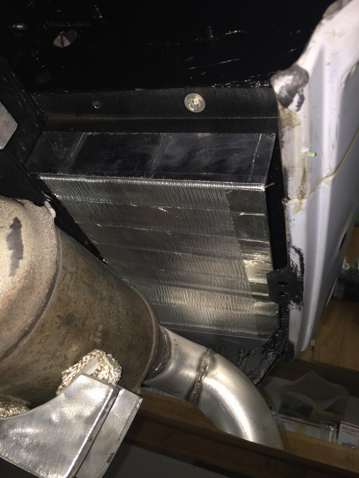

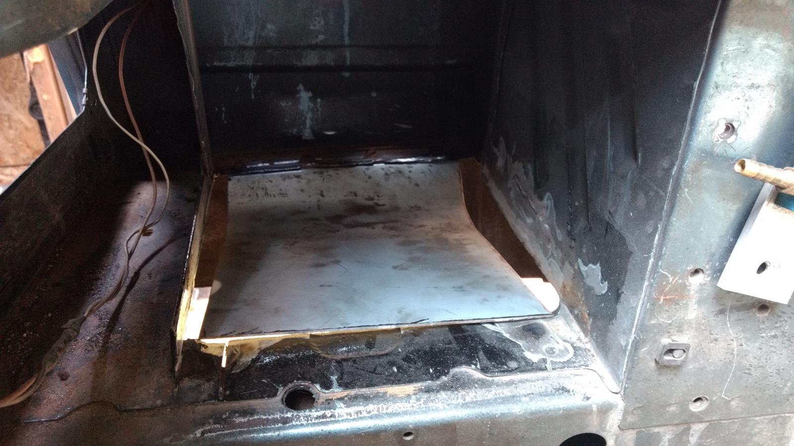

PostPosted: Fri Oct 11, 2019 8:40 pm    Post subject: Re: Air to air intercooler in D pillar ideas please! Reply with quote
I installed an all aluminum Saab intercooler with a puller fan.
The space is completely sealed off from the engine department with fitted aluminum plates on the engine side and 1/4” thick rubber curtains facing the tail light.
The bottom of the pillar is cut out exposing and vent the fan. This is covered with a sheet metal enclosure to provide a heat shield and a low pressure area that is open to the rear of the van via a little fin.
I’m not convinced that this contraption does anything. I’ll run some tests this winter.
