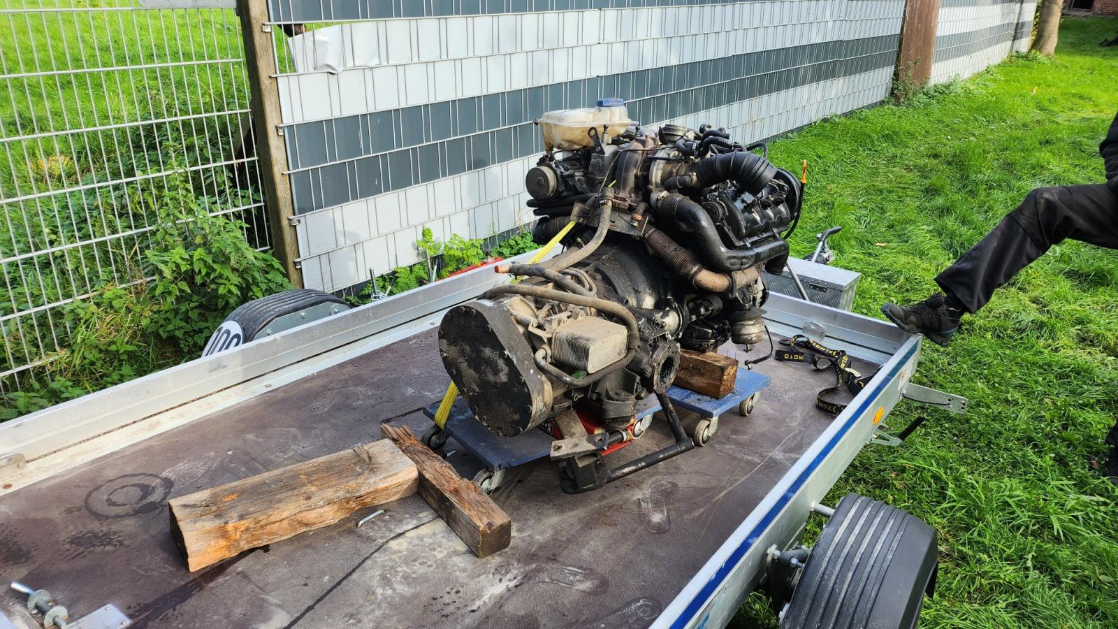

Ray_V6TDI wrote:
The gearbox is a 5HP19FL
"5" speed, "HP19" is the strength (there are 5HP24 also which can take a higher torque), "FL" is frontdrive longitudinal. "FLA" would be all-wheel drive.
The EFR and stuff is the gearbox variation code, just like DG or MV for Waterboxers.
Every code has different ratios, especially in the gears I changed. If you don´t meet the correct ratio for the related trans ECU, and if the trans ECU won´t match your engine ECU, you will get in software trouble and limp modes.
So: Get a pair of engine/trans that belong together. Then get the exact gear ratio re-febricated for reversal of axle output.
A market is non-existant. I built three reversal sets in 2005, that´s it. Yes, i didn´t advertise a lot, but no one was willing to go the whole way.
The website is from 2005, in German, and the technical details should be translateable with modern AI, shouldn´t they?
By the way, attached the outcome of the last two days: All out!
Converter clutch, Turbo and (at least one) rocker arm busted/missing.
So there you go.
That's put pay to that for now then, I was hoping to be able to fit to golf engine but if I need the full lot then it may be in a couple of years time.
Thanks for the response Ray and I wish it had been as djkeev says a plug and play system and good luck with the pending repairs.
So there you go.

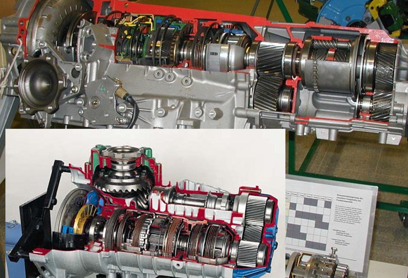

Ok, basic assumption:
you need to use the Audi rear diff on a vanagon´s front anyway, as the stock vanagon´s front diff won´t match ratios and tear you Van apart (or crunches it shorter...)
Now, say you reverse only the audi´s front output to use in a Vanagon´s rear:
the 2WD part (Audi front) now pushes the Vanagon forward,
the 4WD part (Audi rear) still pushes the Vanagon backwards.
...not good.
You need to reverse both (which, BTW, opens a new can of worms: adding a third gear to those you question-marked).
Or, the clever mean trick: You reverse only Audi´s front, and put Audi´s rear diff into the Vanagon´s front, but upside down!
Confused?!
You´re welcome Wink
...been through all these thoughts, wanting to build a Vanagon quattro!
Still leaves the problem of the 4WD gearbox crashing into the vanagons´rear frame and your rear heat exchanger.

Ok so the question would be if the "Stirntrieb hinten", german for (?) spur drive rear (?) need to be reversed?
I think not
Please excuse my ignorance
Roger
Had a Carbureted ABA after engoing the heck out of it now going for ABA 2.0 Jetta EFI ill put a garrett in to the tin can later or maybe go electric?
View user's profile Send private message MSN Messenger Twitter Gallery Classifieds Feedback
Ray_V6TDI
Joined: January 12, 2012
Posts: 24
Location: Bremen, Germany
Ray_V6TDI is offline
PostPosted: Thu Mar 23, 2023 12:51 pm    Post subject: Re: Tiptronic-Modification now public Domain Reply with quote
Your circle shows the end of the 2WD version gearbox. Everything right of it is the 4WD content.
The two extra gears with the question mark are another ratio for the rear diff. The propshaft output flange is not directly behind the "drum" of the torsen diff, but on the lower gear (out of photo´s right side edge).
Those two gears are the ones named "Stirntrieb hinten", german for (?) spur drive rear (?)
Just imagine the picture flipped left to right, and it matches the photos.

Ray_V6TDI wrote:
The circles:
On 2WD, the planetary output shaft drives the first of the three middle gears.
On 4WD, that shaft runs THROUGH the first gear into the torsen diff, which is then driving both the first gear and the propshaft flange.
Clearly visible on the schematic drawing I am showing in the posts above.

The circles:
What other question mark are you referring to?

Question is the red circle the ones that you were refering to?
Also what about the question mark that Ive placed, I imagine that does to have to ve modified?

Ray_V6TDI wrote:
xoo00oox wrote:
If you go with a manual transmission, the 4mot works reversed in a Vanagon.
I doubt that, unless we are thinking different solutions.
The Subaru gearbox uses new ring/pinion in the diff. And a flipped diff cage.
Audi/Passat do not have the room in the gearbox casing to allow the diff cage to be flipped. If those had, people would have done it decades ago.
While Subarus allow machining the gearbox shell to make room, the Audi doesn´t. You can see the bulge for the crown wheel in the lower right of this picture:
https://www.google.com/imgres?imgurl=http%3A%2F%2F...egUIARDIAg
Also, the clutch arm is in the way to create room for a new bulge on the lower left bellhousing.
All you could do (and people have done) is to mount the gearbox upside down...incl all the caveats
Yes, different solution. I'm talking about engine running counter clockwise and transmission and rear diff (now in the front) remaining unmodified.

PostPosted: Wed Mar 22, 2023 1:47 pm    Post subject: Re: Tiptronic-Modification now public Domain Reply with quote
