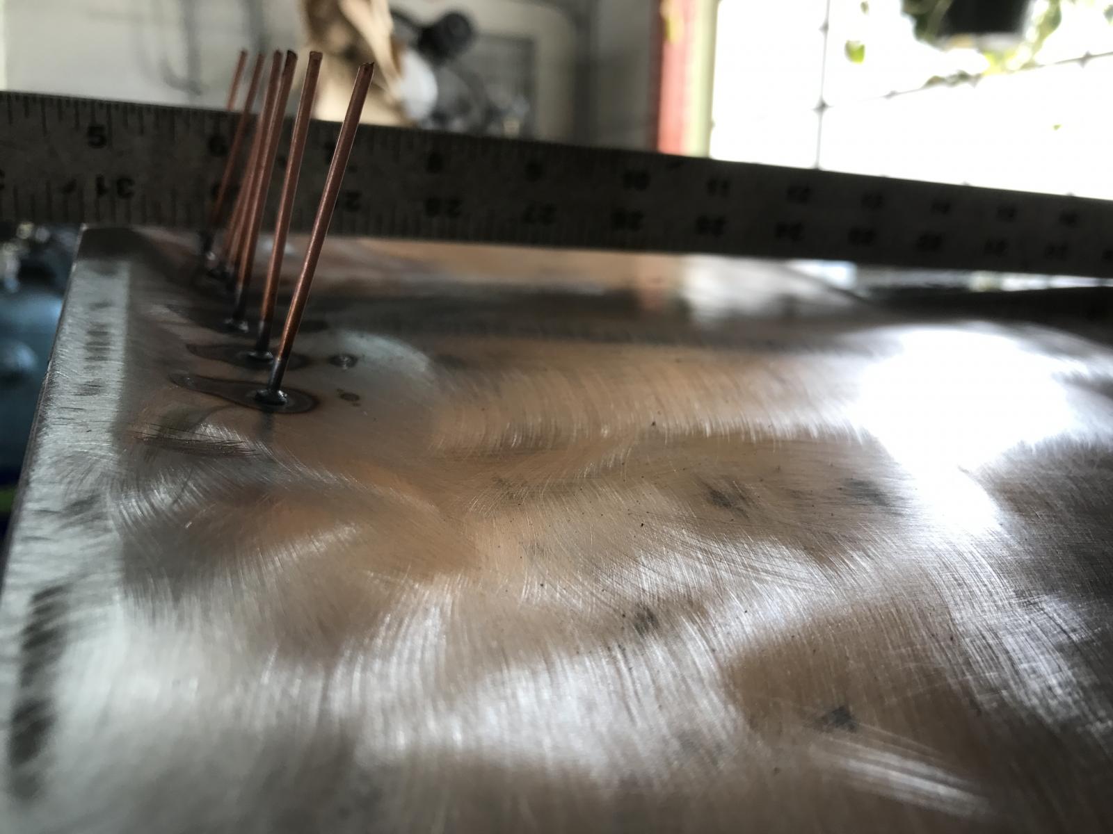

The suggested method of a (yes, get a new one) plumbing plunger is a good one, indeed! There is some fineness needed on that as well tho... you don't just squish the plunger on there and pull it out... you got to get something to tap at the outer edge of the dent as you gently put pressure on the metal. I've had great luck using a plunger and a body hammer with a rounded face, -- put some thin spongy tape on that face -- pull gently on the plunger and tap lightly around the edge. It will start coming up. One other thing tho: plungers come in "sink size" too, much smaller. Very convenient!
https://www.amazon.com/Martin-168G-Finishing-Hamme...ody+hammer

Some good tips here
One other useful tip is if you end up with a raised surface - I call this a positive bump - a depression is a negative
To lower/ flatten a positive bump I have had great success with a shrinking disc.
Amazing at how it quickly and effortlessly reduces a bump.
Brought mine here - Australia
But you can get them there in the US
Just brilliant
Peter
http://www.metalmantools.com.au/shop/prod/shrinking-disc.html
