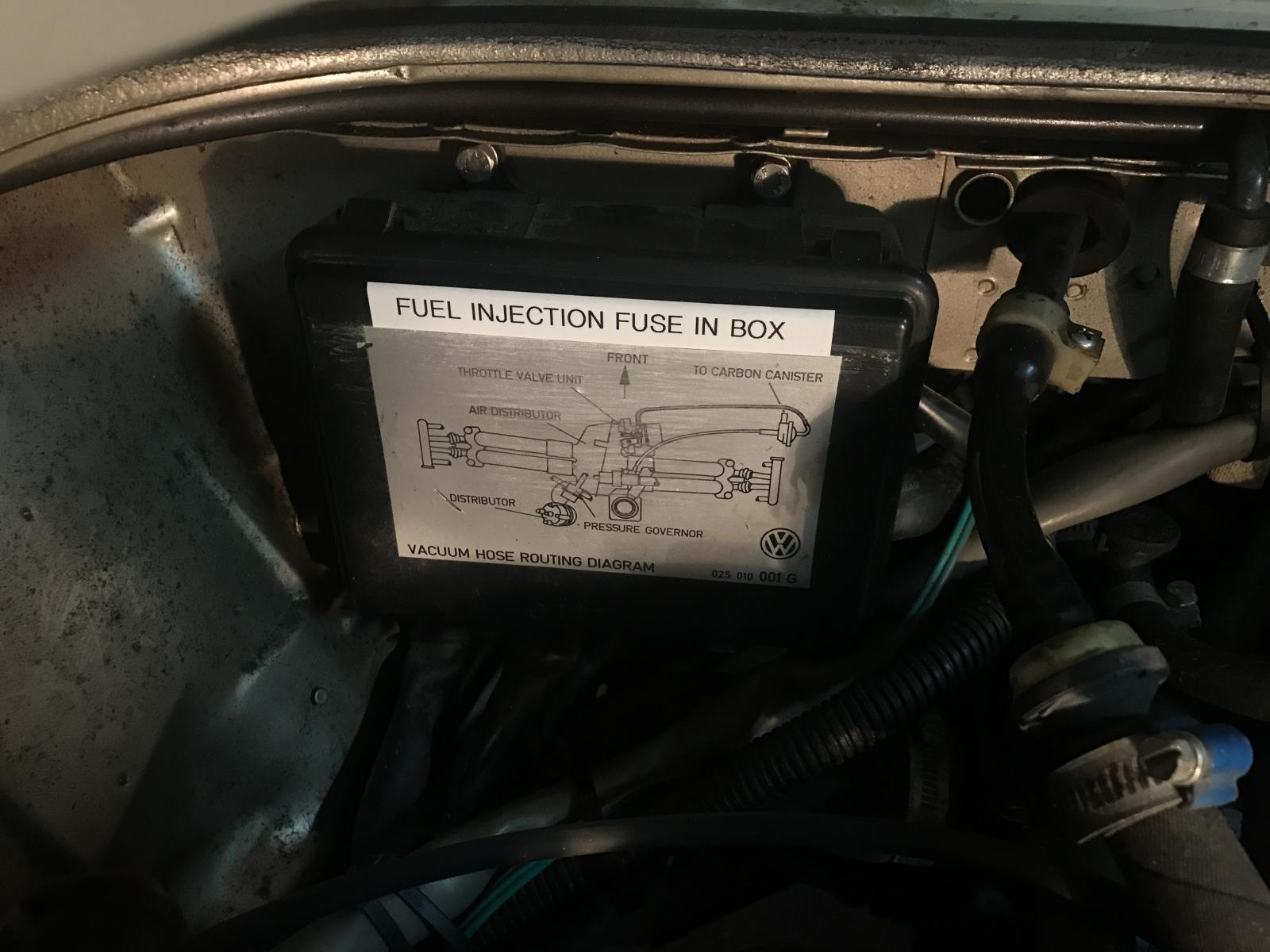

djkeev wrote:
I installed a fuse but because having a fuse is NOT expected by anyone, I clearly marked the box with a label clearly stating that there is a fuel injection fuse.
Dave
That's a really good idea. I had a friend wash his engine bay and then his van wouldn't start. Took a long time to remember that fuse was installed and of course it was the reason it wouldn't start. It did it's job!
djkeev
Joined: September 30, 2007
Posts: 32989
djkeev is offline
PostPosted: Wed Jun 26, 2019 5:04 pm    Post subject: Re: ATTN: Check Your Power Steering Switch Wiring!!! Reply with quote
Dave

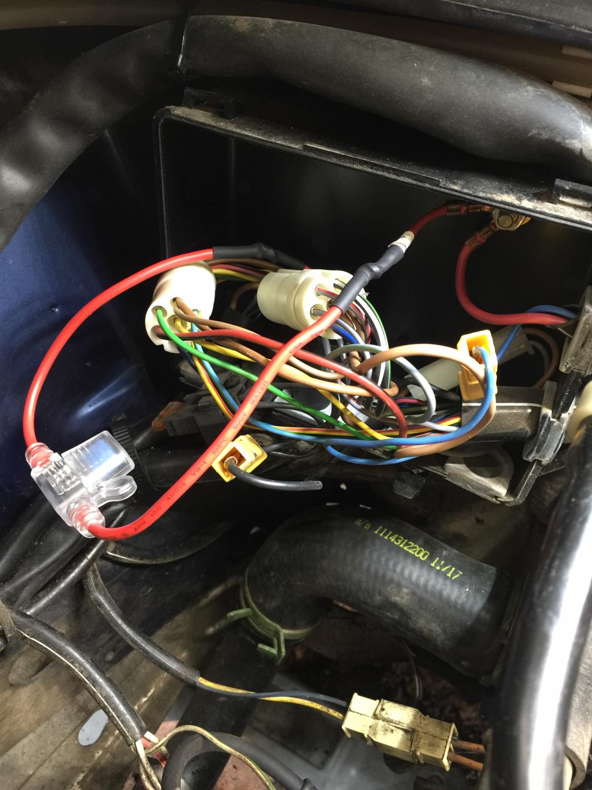

PostPosted: Wed Jun 26, 2019 9:26 am    Post subject: Re: ATTN: Check Your Power Steering Switch Wiring!!! Reply with quote
Yesterday I added insulation to the power steering contacts.
djkeev wrote:
I would suggest that everyone install a 7.5 amp inline fuse for the fuel injection / fuel pump circuit.
It is cheap insurance warding off potentially big problems.
Keep in mind that If the fuse does blow, your engine shuts off.
But for me, better that than a fire!
Dave
On my “to-do” list today!
Here’s the quality install I’m aiming for;
dhaavers wrote:
FWIW: Member farfromslow recently posted a pic of a perfect install:
- nice heat shrink on connectors...
- clear fuse holder (assume for "glows-when-it-blows" type fuse)...
- nothing more or less than needed...
Git 'r done! Cool
- Dave
SteveMc wrote:
And mark up your Bentley wiring diagram for when your van dies and you forgot you installed a fuse.
Seems like an excellent idea (thinking of future owner -me- lying in a puddle in the side of the road changing out a fuel pump - to no avail)
My question is this the proper spot in the Bentley - 97.124? Pretty sure it is, but would like to post the correct spot shown in farfromslow’s post above. ‘91 2.1l auto (Canadian)
