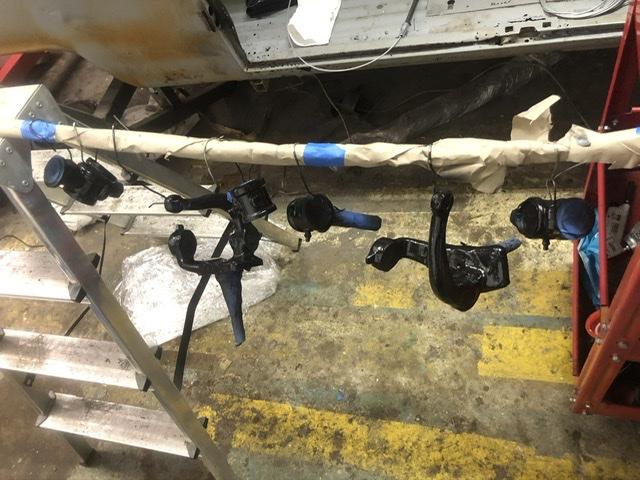

I did work on my front axle after moving the rear one to the shelf. Thanks to Michael, a fellow member of thesamba with his nice former fire brigade bus, I could borrow the press tools from him to rebuild all the parts. Thank you!
Taking off all the dirt first and preparing the big tube for the blaster guy (making sure nothing goes inside).
Nicely shining back and ready for paint work.
In parallel working on the smaller parts.
All painted and starting assembly.

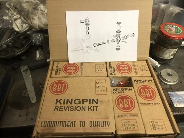

Got the king/link pin revision kit from BBT, nice set but used some NOS rubber rings as the provided ones were not up to my expectations.
The center pin worked well with the right reamer and is moving perfect. I just opened up those groves at the end of the bushings. Lower is how it came and the upper is grinded. I thought there might be issues with the grease flow without taking of some material on the edges.

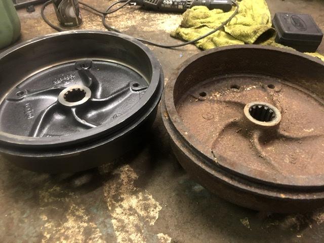

Update to my post two years ago. I found out what the issue with the break drums was. I had used some nice NOS drums, but I didn‘t look close enough to the parts revision letter. They were for early bay window buses, which have a shorter center piece. So I went to a shop to get my correct good used drums machined and all went well. My rear axle is sitting now, ready to go camping somewhen. I have a set of never used bay drums, if someone in my region is looking for those Smile.
Difference:

I removed the paint layers from the backing plate area where the drum touches, but it is still a too tight fit. I‘m wondering if the axle spacer should come more outward, so the drum would have more clearance. What do you think?

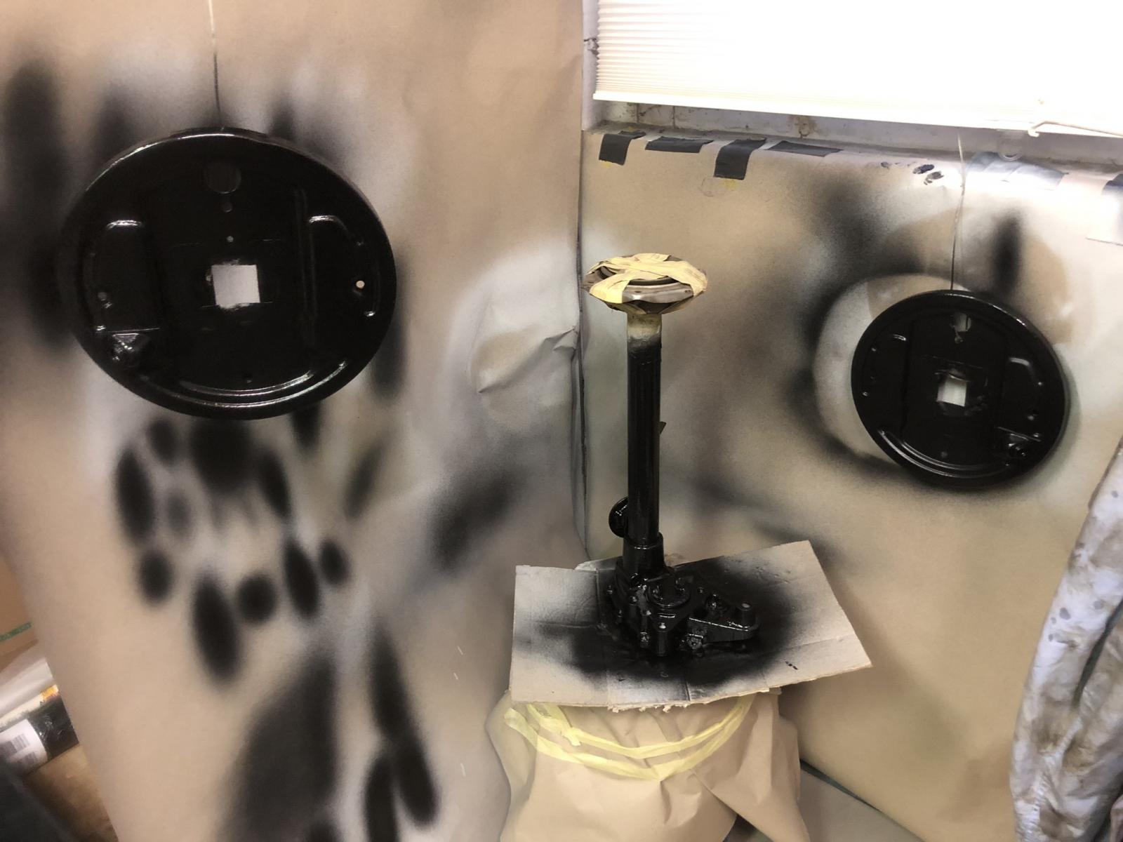

Long time no update. I was always working on stuff, but not too focused and this means less results. We worked out a small plan now and do focus more on one thing at a time.

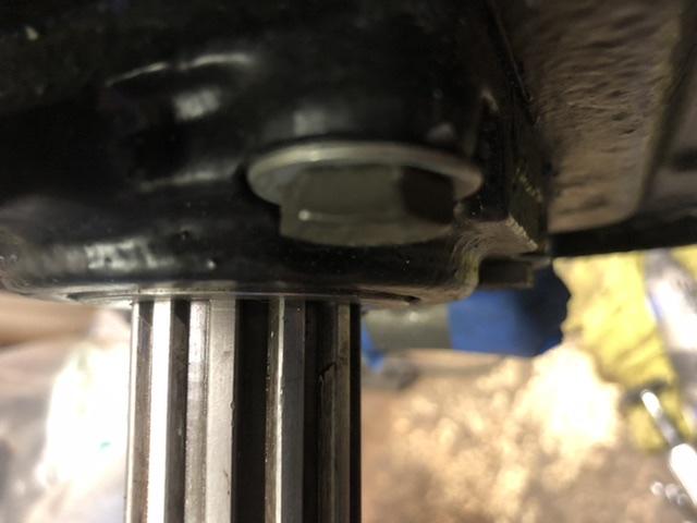

I was so proud finally having rebuilt my transaxle. Unfortunately, there is still one issue left Sad.
After cutting down the axle shaft and buying a second transaxle for spares, I started cleaning, blasting and painting things. The core was given to a local VW specialist with the correct tools for rebuilding a transmission. Without the internals I could blast the shell with glas.
I also did fix a previous bad welding job for the handbrake cable inlet on the backing plate. I needed to bring everything straight again and simulate the spot welds.
Blasting with my small cabin is a lot of work, but seeing the parts nicely shining in the end is rewarding Smile.
Well, probably due to some poor drying or the rust prevention product my paint was not holding good at some places. So remove paint with a paint stripper and do it again *yipiii*.
I'm learning so much about all this stuff and I think my next piece, the front beam, will be less of a pain due to my gained process understandings...
It makes me so happy every time I bring back a VW logo on the parts Smile

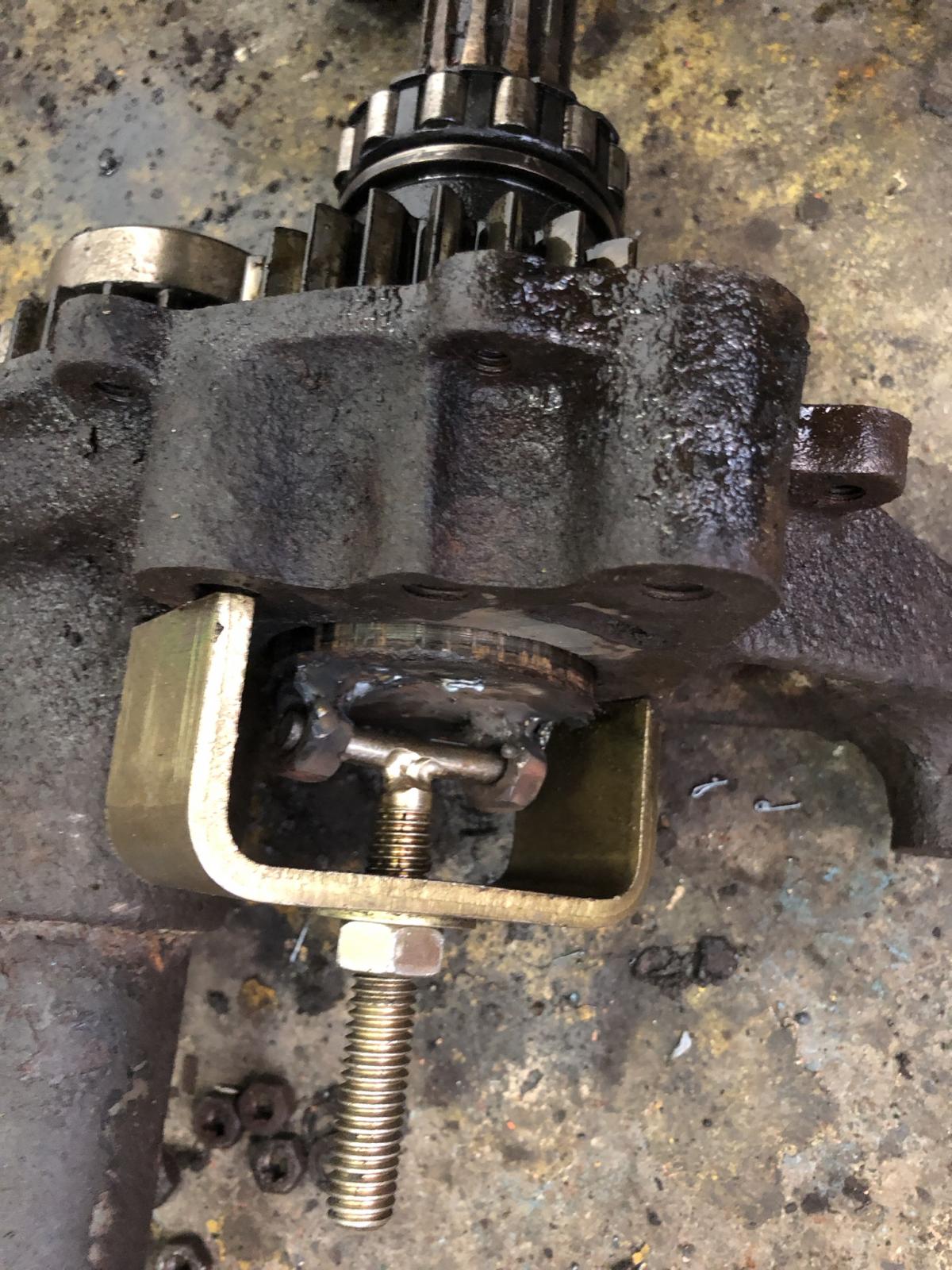

Some tools I used during my work:
Oil pump removal tool can be used as plug extractor when welding on two nuts
To bring the outer upper bearing of the RGB on the axle shaft, I used a T-pipe connector with a threaded bar, some spacers and nuts. Worked really well. You can put e.g. a wooden piece in the T part to have more leverage force.
And the threads on one axle shaft wasn't good to easily put a new nut on. So I bought an oversized threading tool.

Is it normal, that the gap between the rear ring face of the drum and the backing plate surface is such small or should there be more freeplay?

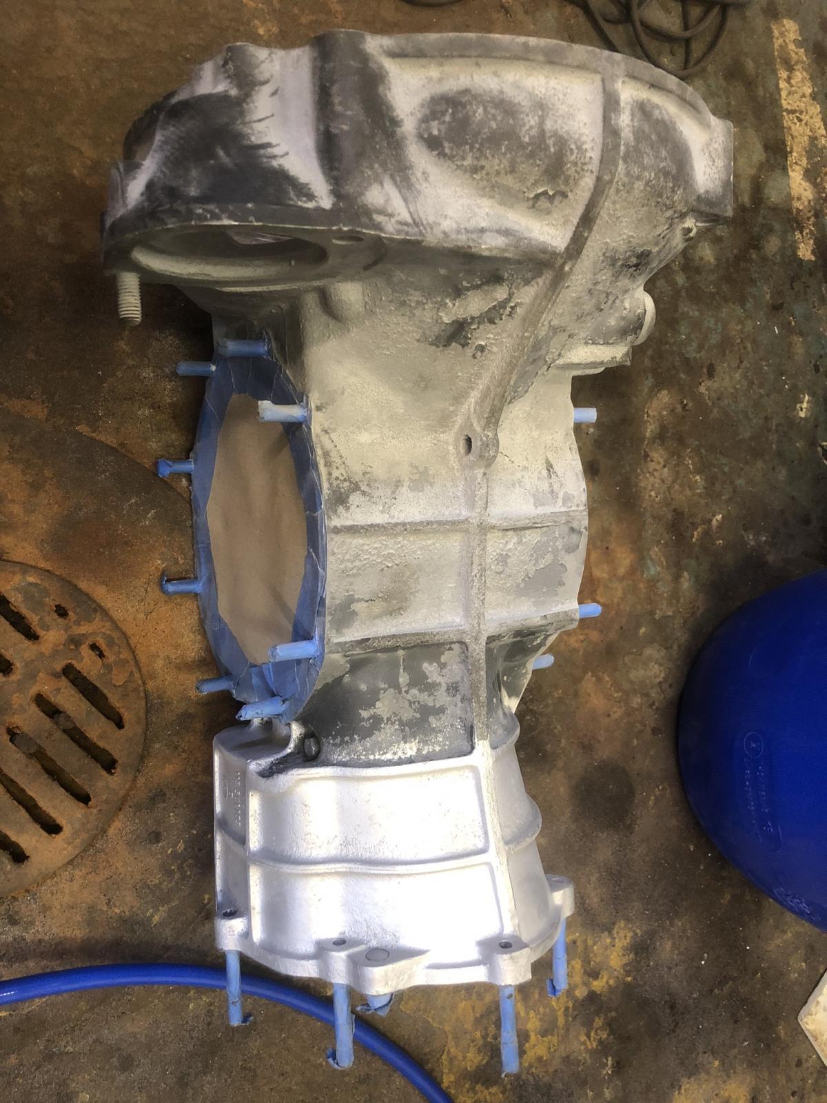

Is a 320 grit fine enough to seal properly with the gaskets back in place?
Finer might be better. 320 is ok. Perfectly flat to mate is where it's at.

Thanks BarryL, I tried to move the blaster around the mating surfaces to leave them untouched. Going forward I will even tape them so the chance is smaller I hurt them. Is a 320 grit fine enough to seal properly with the gaskets back in place?

Can't say I've ever seen a drum removed like that ever before but it proves you can cut through the spacer/slinger and shaft.
Maybe don't blast the mating surfaces of the RGB halves then lap them on a sheet of glass with 320 grit if you can get the dowels out.

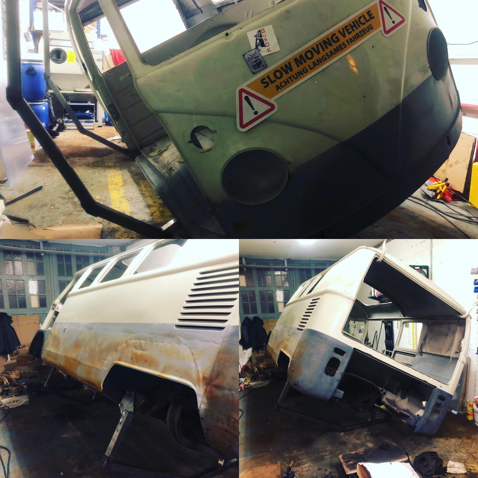

It is quite a while ago I posted the last time on my build thread. It happened a lot behind the scenes. I bought a good stack of parts including some nice stuff like an original Neiman steering lock and some ambulance fans. But I didn‘t focus enough on the build itself. I was really good in disambling everything, but now I will get to the harder part. Start rebuilding stuff and weld sheet metal. Also I needed to buy a lot of tools for my garage, but finally I have a solid base. With a workshop press, a sandblasting cabin and the necessary air tools.
What happened in the meantime. I removed the engine and gearbox. The transaxle was a small nut version, so not correct for my bus. Not far from me I found a guy who wanted to trade with me and I got a correct H-coded one with 46mm nuts. As I didn‘t know how the transmission was handled and I want to put everything back to 0 miles (or at least as good as possible), I decided for a rebuild. Well, removing the brake drums was the first hurdle. One side was going fine, with some pressure on it. But the other side was so rusted, nothing I did helped. What does a dumb man do? Yes, I took my angle grinder and killed the axle shaft.
As result I had to find another transmission as the only one in the area who had an axle shaft wanted 350$ for it Evil or Very Mad. I got another complete setup for only 100$ more and now have a lot of spare parts Very Happy. But also the spare one has it downsides as those bearings clearly show.
But again, I found some NOS German SKF bearings and will renew everything. It was also the first time I could test my blasting cabin. I will soon blast all the parts and get them some nice new paint.
Last but not least, I used a plan for a rotisserie from this site and built me these great helpers:
Hopefully my posts will show more progress in the near future. I have to anyway as I heared from the property owner that the land was sold and there is a plan to build a few houses on it, where I rented my garage. They still have to wait for some more acres still not in their hands, but I have to make progress now. Hopefully, I can stay for a year or even longer. It is nearly impossible to find a payable spot in my region to work on such a project...

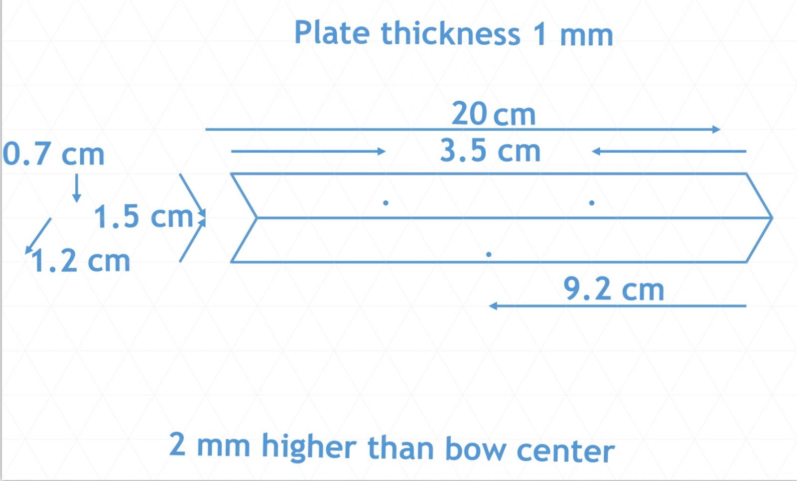

I tried to make a drawing of the bracket with an app on my mobile. Not the best experience, but I hope it helps someone.
All measures are metric. Metal is around 1 mm thick, 20 cm long and 1.5 cm for each arm. Upper part is riveted to the metal bow with the same style rivets as for the curtain rails. The bracket is around 2 mm up from the bow. Rivets are 3.5 cm from both sides each and 0.7 cm from the top. The screw hole for the panel might be differently drilled on every bracket. Mine is 9.2 cm from right and 1.2 cm from the bow.

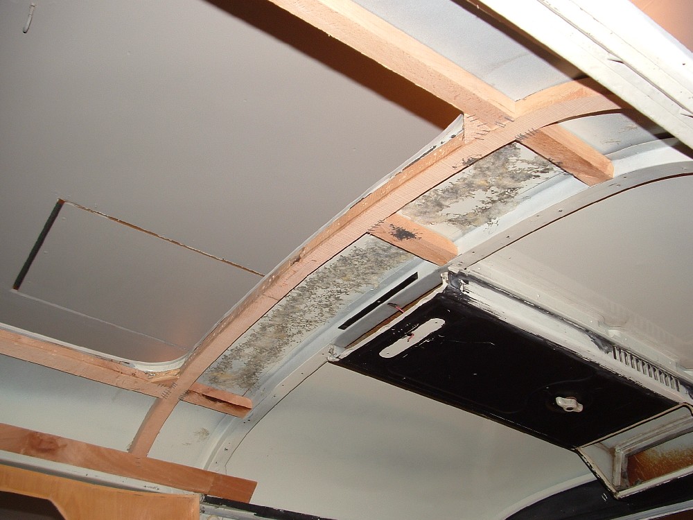

Its stapled as usual, just hard to see in that photo is the canvas is similar color to the wood:

PostPosted: Sat Mar 03, 2018 6:57 am    Post subject: Re: Swiss cheese - 1967 westy Reply with quote
How is the canvas poptop tent secured to the wooden frame in this photo? It appears to be behind it.
