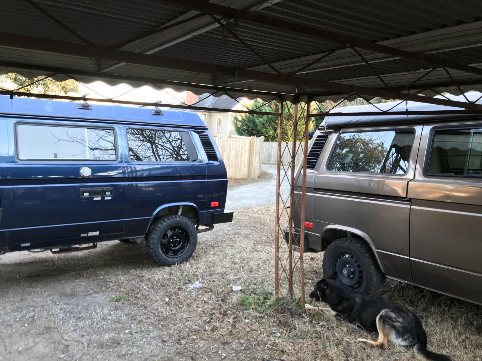

On topic: Orly Blue with 20-year-old (at least) tint, minus the front windows thanks to California's anal law:

Thats a very pretty colour scheme, methinks.

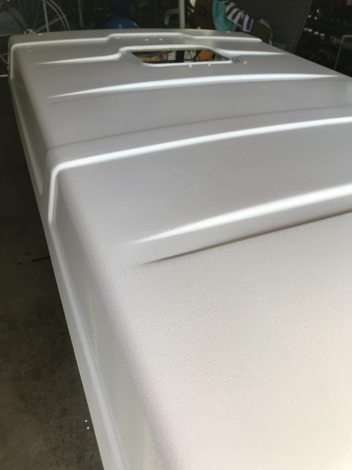

Here is my top primered and ready for paint. I used the whole quart of primer. I added 10% penetrol into the pan and it worked like a charm- no need to tip after brushing it on. I’ll be doing the same for the paint.
Question I have: should I paint the underside white as well? I think it would not look as good with the blue showing whenever I have the top up. I’m likely going to just rattle can the underside with Rustoleum Primer+Paint. Won’t be as nice as the topside but no one will notice it on a galloping horse.
BTW, I got the top painted while at the painter so that it’s better protected from the elements. When I took the luggage top off, it was full of debris and dead leaves. Looked pretty weathered. Now the roof looks nice and spangley! (Yeah except for the bird turd that already got me!!)

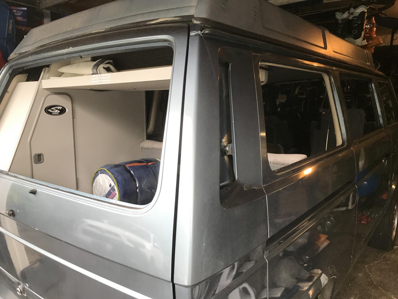

Tinting the windows before install is the best way to get full coverage and best look.
Decent quality tint will hold up fine to glass installation.
Last year I took the rear driver's side window out to install tint that had been poorly applied to a in-place window (because of closet), reinstalling those side windows with the built in vent can be a real pain. No damage to the tint.
Besides, taking the windows out for the paint job gives best results.
As for the degree of tint, that's a personal decision, but less is usually better, but having a dark enough tint to help with privacy is nice.
Here in BC, we're not allowed a dark tint on windscreen or front side windows.
In this picture you can see the edge of the tint on the side window over the sink, the result of tinting the glass in place. If I ever do a complete respray of the van those windows will come out and be tinted before reinstallation.
