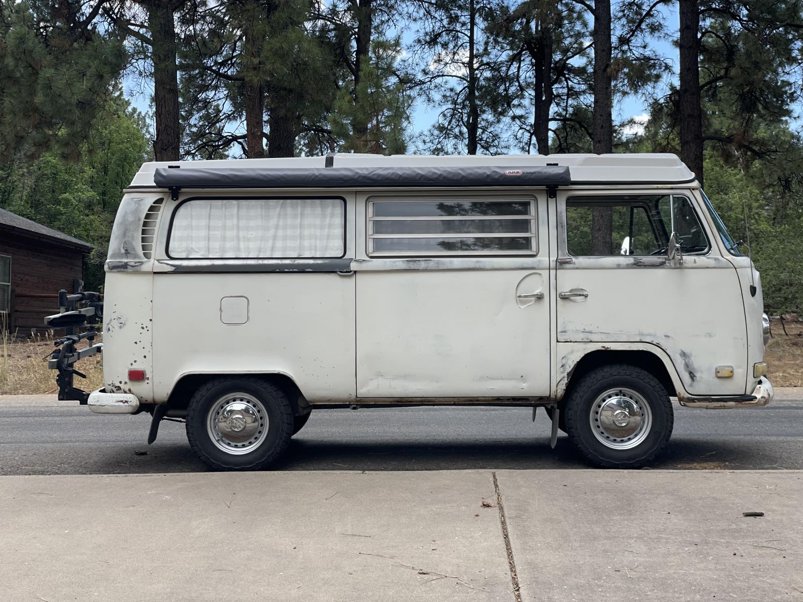

Ive been wanting to repaint the pop top, the sun killed the gel coat and it was looking pretty rough. With 2 events in the Southwest coming up and possibly another Cali trip over Thanksgiving, I figured now’s as good of time as any.
I sanded it with 120 grit, cleaned it with mineral spirits and got busy painting. I put 3 coats of Majic oil based tractor enamel on it. I let ot cure for 24 hrs inbetween coats. Wonder how long it will last?
I also installed a new ARB awning cover. Like the gel coat on the pop top, the sun killed that too.
Both look pretty good, more stuff to do next weekend.

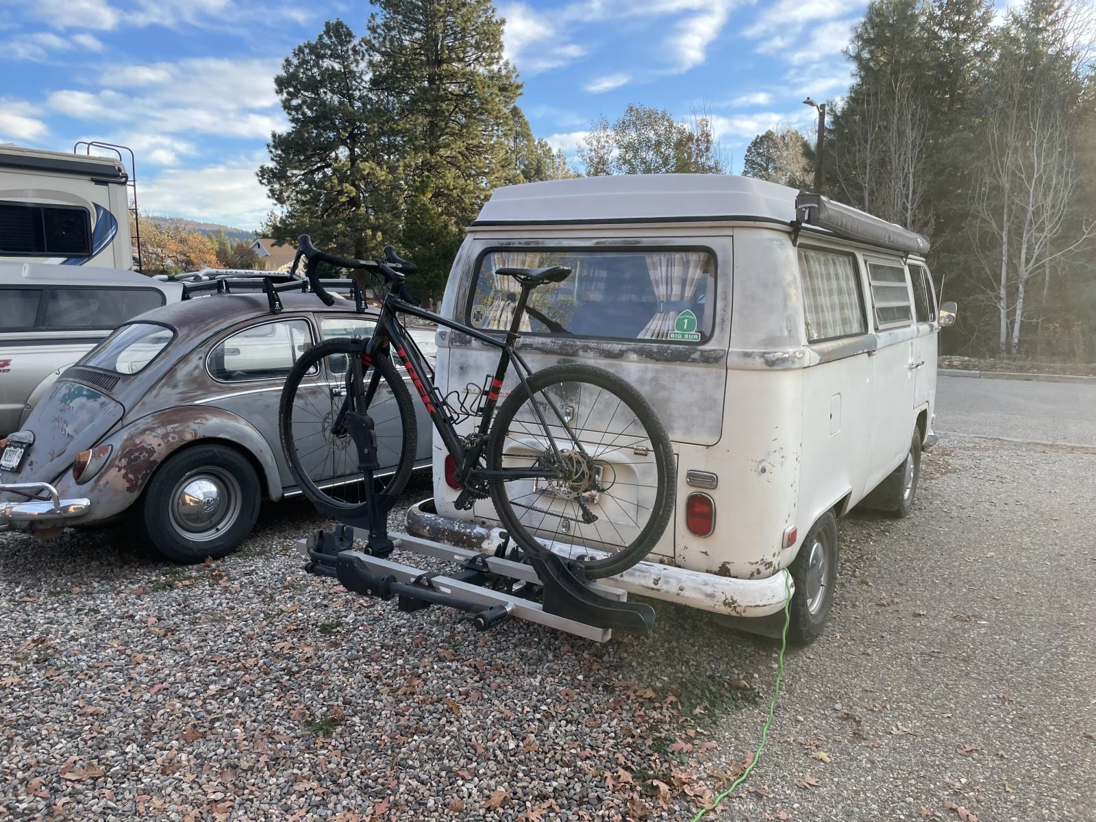

Good looking rides (all three)! What's the green wire going towards the battery? Trickle charger? Sorry if you've already covered that and I missed it.
Missed this, sorry. It’s an extension cord that I have plugged into a Kats VW-15 sump heater.

Nicholas D Premium Member
Joined: November 06, 2012
Posts: 265
Location: Charleston, SC
Nicholas D is offline
PostPosted: Tue Nov 05, 2024 2:22 pm    Post subject: Re: Scored a local ‘71 Westy Reply with quote
