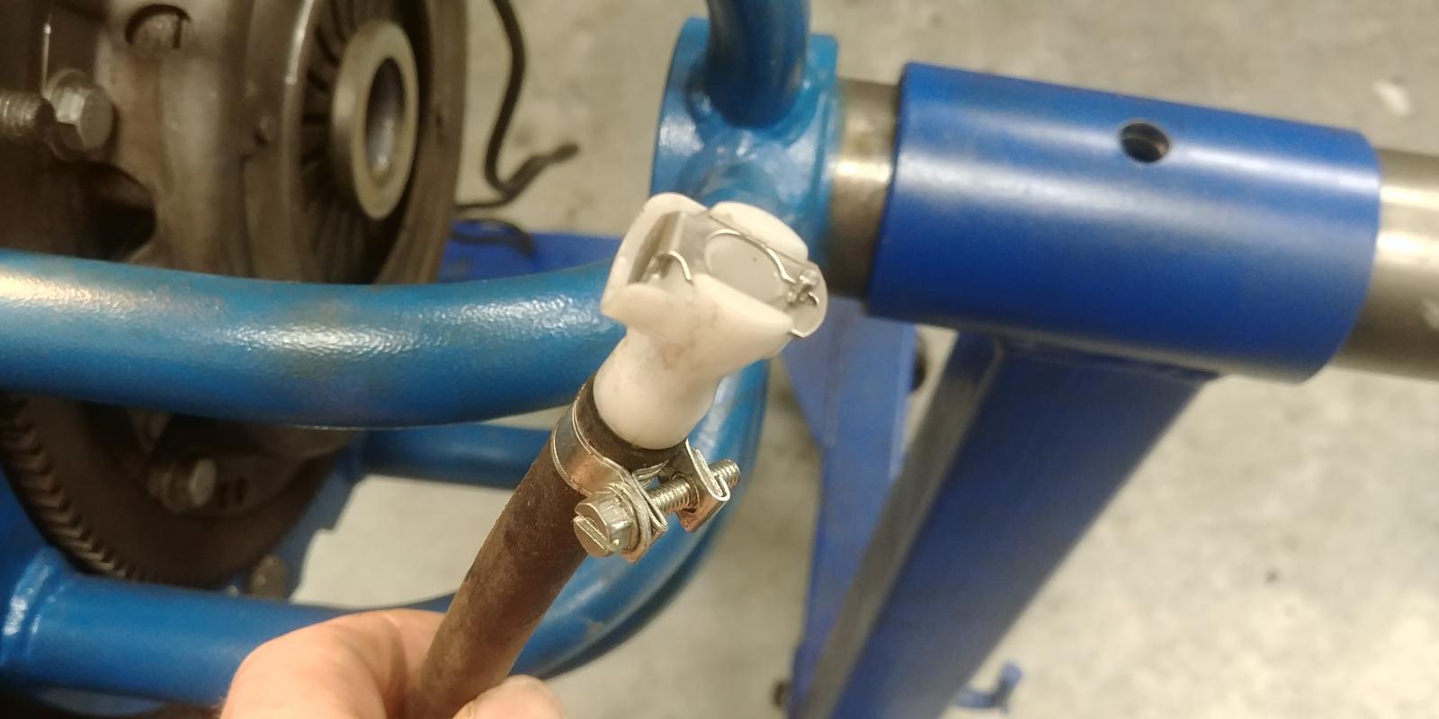

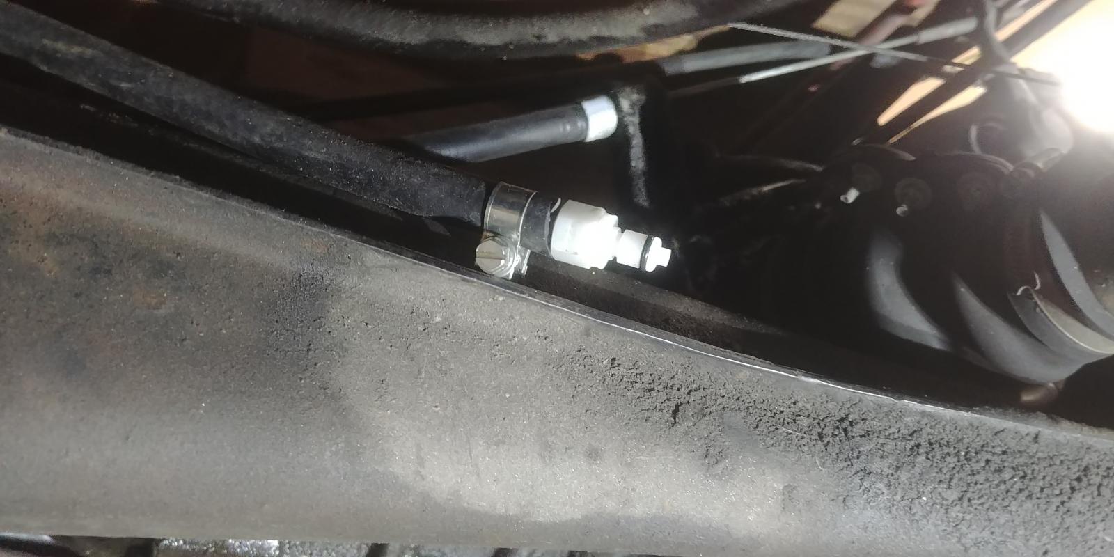

old_man wrote:
I also installed a quick disconnect on the fuel line running from the tunnel to the engine. I did this because 1) It is hard to reach either end that section of fuel line to disconnect the line in case of engine drop, and 2) when I do disconnect them I am left with fuel coming out of the gas tank end that needs to be stopped somehow. Now I just press the detent and it does it all.
Are you planning on dropping the engine that often? Seems like it from here, adding those fittings to the lines.

Out of boredom I also re greased my throw out bearing as per some instructions I found on this site. Hopefully I didn't make things worse.

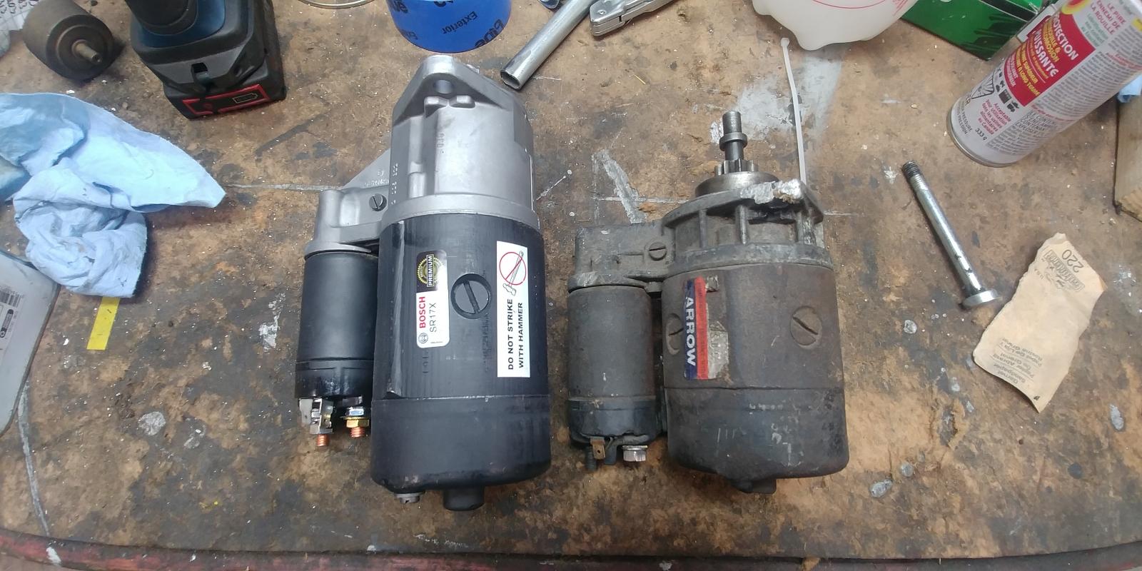

old_man wrote:
Out with the old and in with the new (well, rebuilt anyways). The old one was giving me troubles every now and then necessitating a gentle tap with a hammer to get it working. Not fun in a rainy parking lot. I took it apart and the wires on the brushes that, I think, were contacting the housing. It helped but it still gave me trouble.
Amazon had a sale on this thing so I went for it. Hopefully it doesn't give me troubles. Not sure what I should do with the old one.
Is the new for an automatic? Just asking as it's very large. As for the old one, I'd hang on to it, as it does work (sometimes). Maybe rebuild it.
