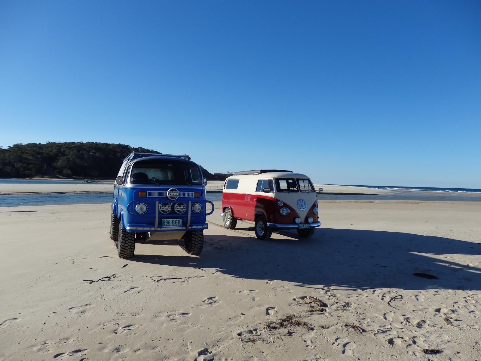

PostPosted: Fri Jan 25, 2019 4:07 pm    Post subject: Re: Convert at Subaru boxer to run backwards / CCW ? Reply with quote
I missed the bit about the reduction boxes . That will bring the ratios up to suit the bigger tyres.
I own the Split ,it has bay running gear with 002 gears . A good friend owns the Bay ,it has reductions boxes with an upside-down 091 box . He made his own stub axles for the reductions by cutting down the swing axle and getting splines cut to suit a gearbox CV flange .
He's moving to a Renault UN5 without the reductions in the next rebuild . with 35in tyres and a lot of weight the boxes flex and brake gears .
For CV joints I would recommend going straight to 930 CV's for the extra movement . BlindChickenRacing.com has a lot of info on CV angles .
