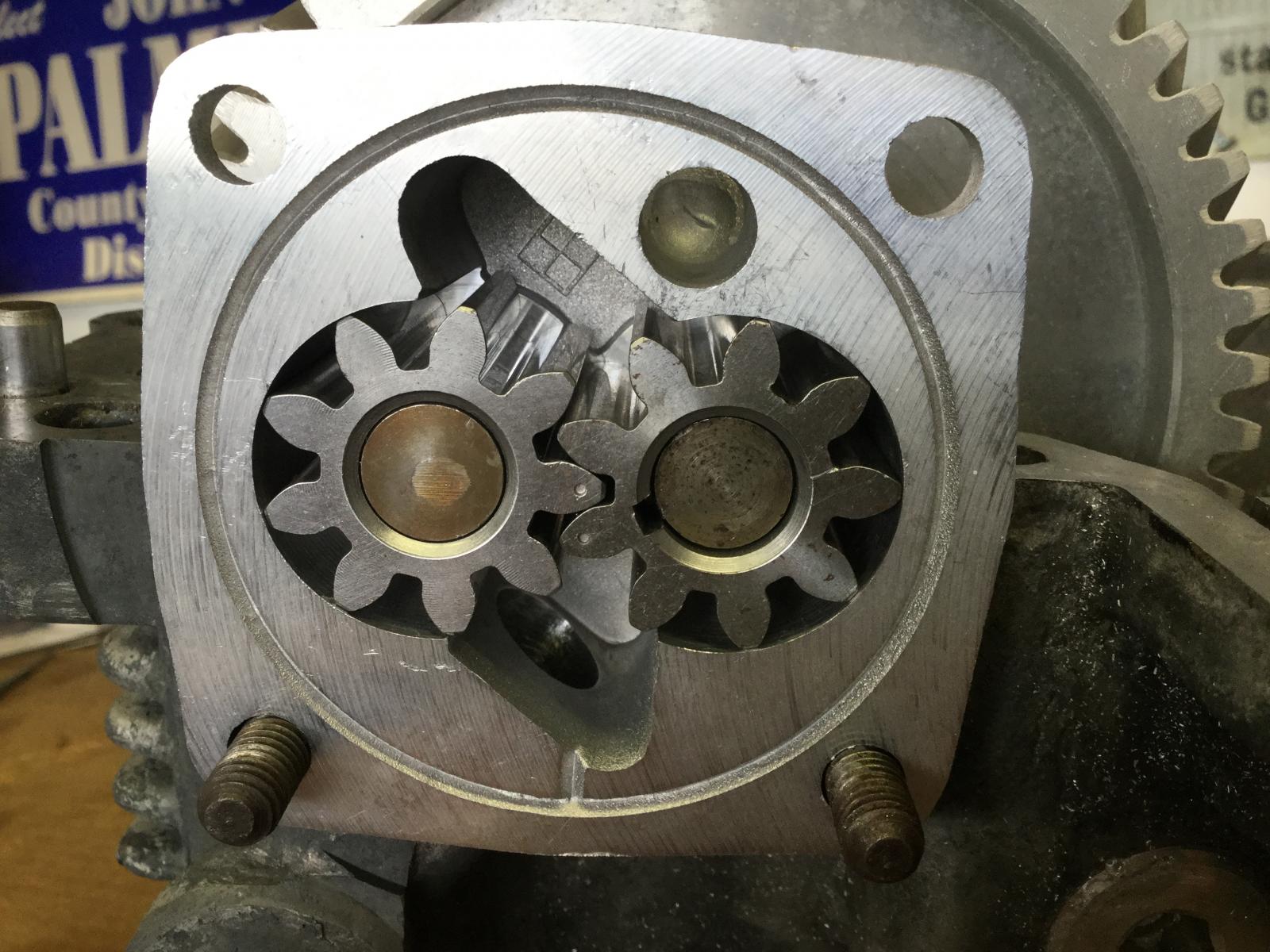

So, getting all excited I put the cam bearings back in the box and decided to check out the oil pump. It’s a cb maxi 5. I wanted to see how well the hole lined up with the hole in the case. I had read where the hole sometimes didn’t line up with the oil pump so I pushed it in.
Uh oh...
BEFORE:
AFTER:
To get it cleaned up I wound up taking my dental pick and running it down inside the hole. I could feel a lip at both ends. I scribed a line and pulled the pump out.
I took my Dremel and a carbide bit and opened it up to match the case. I then opened the case hole up to blend with the pump hole. (I’m deadly with a Dremel I swear!!)
Slid the pump back into the case and it turned out pretty damn good. I then took Clatter’s advice from his thread (scotch brite on a wooden dowel with a slit in it) and cleaned up the pump hole and the case hole.
Since I was on a roll. I put the cam back in with the cam gear and wanted to see if the oil pump bottomed out in the slotted end of the cam. I had read a few things about the cam gear BOLTS hitting the oil pump case sometimes and the drive gear of the oil pump bottoming out in the slotted part of the cam.
Anyway.........
I had no issues with the cam gears hitting-not even close. When do people have issues with them hitting?
And the drive gear sits fine in the cam without bottoming out. Yeahhhhhh!
I put the gears back in the pump and ran the face over more wet/dry and a piece of glass to get it super flat.
I took the pump and cleaned it up really well with hot water and dishwashing detergent. Dried it and put into a ziplock bag.
