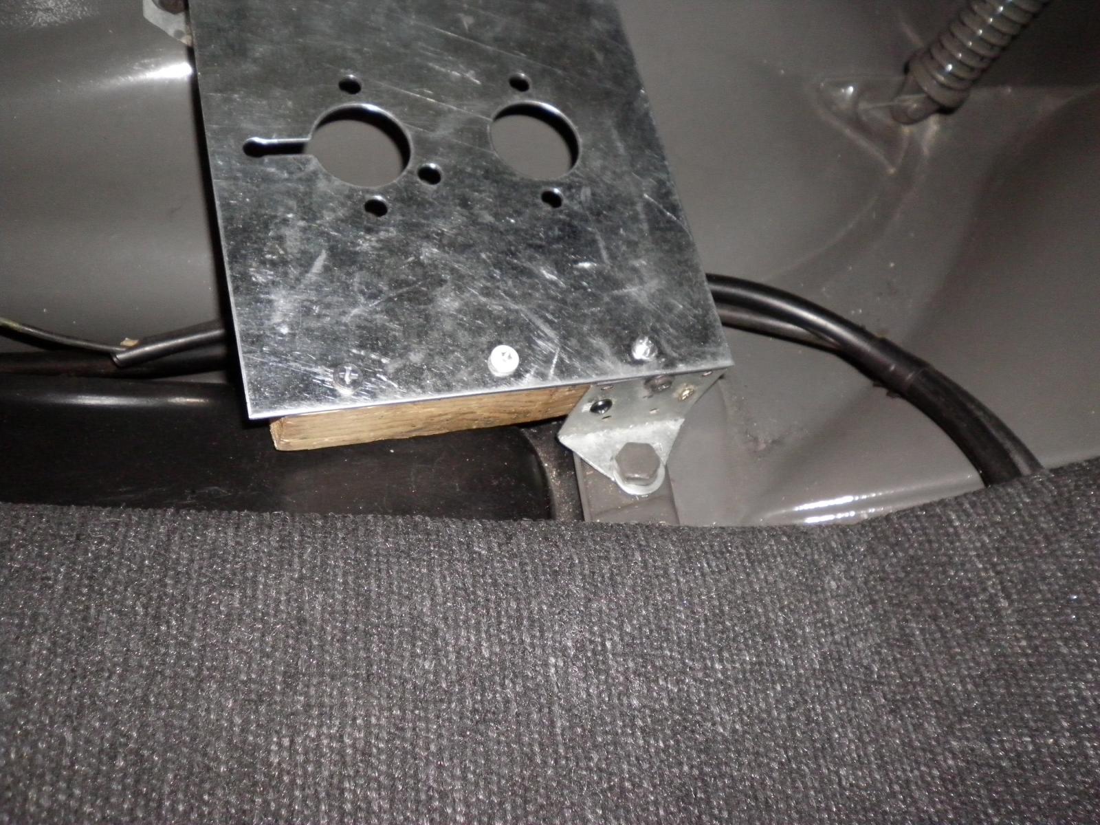

I did a very much easier install. This thing fits exactly in the spare tire well, bolted down with 4 x 6mm bolts. I haven't plumbed it into the defrost yet.. not sure if I will need to.
But, I sort of feel bad about the 3" duct hole I had to make. But...life is life and this was a pretty roached car I resurrected, AND daily driver.
I wanted to be able to remove the entire thing in the spring- and that takes about 5 minutes. The install took maybe an hour.
I did relocate the controls to where I can use them under the dash, but with the remote and bluetooth it's not even needed.

thomas.
Joined: July 31, 2010
Posts: 1383
Location: South West (Pa.)
thomas. is offline
PostPosted: Mon Nov 18, 2019 9:31 am    Post subject: Re: Diesel heater in a '62 ragtop Reply with quote
A guy messaged me wanting to know if I had any more photos of the install. I figured I would just post here in case someone else was interested.
The fuel line runs behind the spare where it won't get kinked. then up to the bottom of the heater where the heater is raised up high enough for the fuel line to go in and not kink there either. I made a copy of the intake and exhaust holes on cardboard to check where I would drill the holes. Once the heater mounting plate was mounted I used a small harbor freight flashlight pushed through the holes to get it close. I also made two brackets to hold the heater plate down one of which goes to the front 1/4 panel the other to the bugs fuel tank hold down bracket. The fuel tank (for the heater)I had to make a bracket out of some galvanized brackets I had laying around. I mounted that to two fender bolts. I guess that's about it.
