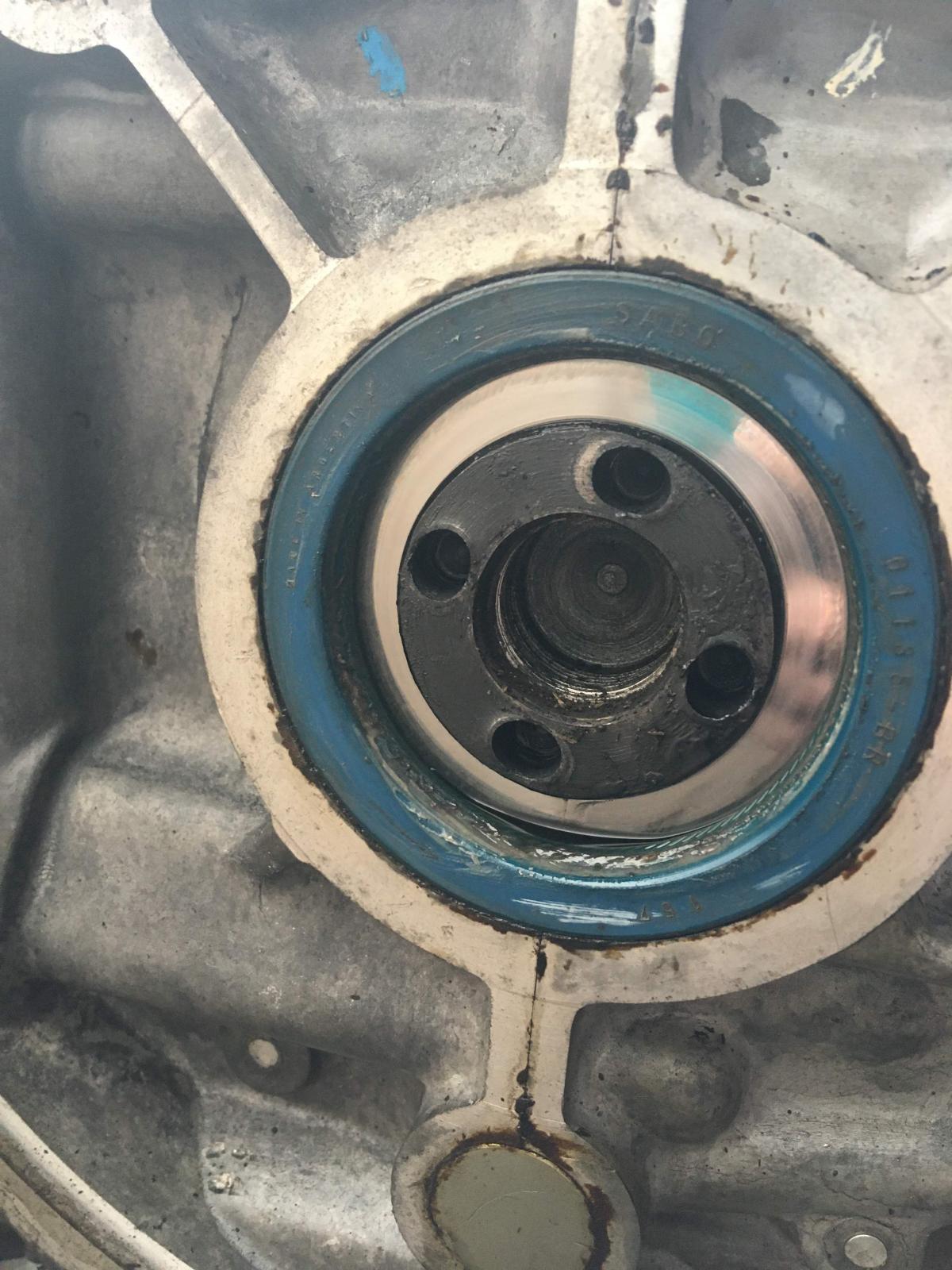

UPDATE:
Engine Is Running in top form.
Drilled to 8 dowel & New clutch assembly.
Rear Seal in great shape.
HOWEVER: the Oil leak persisted.
Took it back to Jerry & He noticed that one of the oil galley plugs was pushed in a little too far & Oil was seeping/Pushing/Gushing Past & it presented as a Main Seal Leak would.
Back in 2014, I had a Post about seasonal maintenance issues. Back then I didn't have an issue with the Flywheel coming loose, but I was under the impression that every main seal I put in leaked...
I had done about 3 I think to try to solve the issue.
It was back then that I again replaced the main seal & didn't get the torque of the flywheel correct, which caused my gland nut to loosen and flywheel to wobble -> which in turn caused the ovaled out dowel pin holes in the crankshaft.
@72Pstroke Made mention of it back then in 2014, but I didn't really know what I was looking at or for, AND "Assumed" that because the case was a new Mag AS41 that was not drilled for full flow, that the oil galley plugs would have been pressed in and installed correctly from the factory...
They were not.
If you care to see that thread, it is here:
https://www.thesamba.com/vw/forum/viewtopic.php?t=...p;start=20
Regardless. It has been a long journey to get this thing Potty Trained, but as of now, it is no longer marking it's the spot.

Tim Donahoe wrote:
After you have new dowel holes drilled, buy a new set of dowels, and maybe new crank shims, a new flywheel, and flywheel seal (get the orange Elring one, and don’t forget the o-ring), do yourself a favor—especially since you saved so much money on a new motor you didn’t really need.
Buy a Torquemeister tool. Actually, EMPI makes a good knockoff for $95–no shipping or tax from Cipi1. Use this tool to set your flywheel gland nut to 253 ft. lbs. It’s easy to use. Just set your torque wrench to 28 ft. lbs. and that gets you to 252 ft. lbs. on the nut. Tighten a hair more and you’re home free. No measuring your weight, or standing on a 3/4 inch breaker bar, X number of inches away from the center of the gland nut. None of that.
Easy-peasy.
Tim
Tim- Jerry is going to button the whole thing up and install it for me.
He's going to get new dowel pins, do the seal, the shims, set endplay and install a new gland nut along with a matched and mated flywheel.
He's an engine builder as well, renowned as the go-to guy in our area. I thought he had retired because the old number I had didn't work, Confident I'm in good hands.
I'd buy more tool's If I had a place for them.
As it stands now, I'm selling all my tools.
I'll just buy more later when I get a house...
I don't have enough good stuff to hold on to that's worth 120 a month for the next few years until I save a for a house. ha!
Hopfully though, this will be enough to get her back on the road - then the list continues I guess! Ha! It's always something!

Yep, your dowel holes are all ovaled out.
When getting the new holes drilled, let the shop to supply new dowels, and even consider letting them install the new oil seal, dowels, flywheel, and gland nut. I'd go with a new gland nut/washer too.

UPDATE:
After some research looking for a long block or complete motor yesterday, and some phone calls . . .
I made it back up to the shop this morning . . .
Funny enough, they called me as I was about a mile away.
What they said and what I (originally) heard was 2 different things.
I heard bent Crank, needs total rebuild over the phone.
What they told me in the shop & on that 2nd call was: "no not bent crank, bent dowel pins.
Then, I got to the shop moments later (930 AM) & Talked with them there - (Pictures If I can figure how to Post them...)
So here's the deal (Long story Tolerable)
They are not a machine shop and for them to guarantee the work, it would need full rebuild - Because, even if they found a shop to drill out the bad holes, they couldn't warranty the motor. So for them, there is too much risk.
Makes sense enough.
SO They Recommended a machine shop (Who, by the way, I thought retired because the last time I tried to reach out to Jerry his number was dead...)
Turns out Jerry is in his 3rd location since I last had him do any work.
Since he has been threating to retire the last 13 years, I figured he did when I couldn't reach him about 5 years ago...
Regardless - I got Jerry's new number (NW connecting Rod) from the Guys at the shop and after 3 calls and VM I finally connected with him.
Anyone that's met Jerry knows he's a Straight shooter and a No BS guy. If he says he can, he can, if he says he can't, he cant & If he doesn't want to, he'll tell you.
His shop is set up to drill crank shafts for 8 dowels pins with the Crank in the Case. He can resurface and mate and match without splitting the case halves.
it was sometime after noon when I finally got ahold of Jerry.
So then I drove the motor from Edmonds to Auburn (35 miles or so) and scheduled a Tow Truck to take the body down later in the day.
Jerry is booked solid about 2.5 weeks out but should have some answers from him Wednesday the 11th (+/- a day or so).
I think the 70 might get through this after all...
We'll know more in early Dec.

The bent crank scenario is complete bullshit, never seen it or heard of it before. If they’ll BS about that what other lies are told. ? Seen more than one loose flywheel problem fixed by dressing end of crank flat, four new holes, use new dowels and a serviceable flywheel. This assumes end play was correct before the carnage. Pack the end with grease to catch metal shavings from drilling new dowel holes. Been there done it way less than 3800. Somebody is getting hosed here. Sad

J-Gaz. wrote:
@Cusser,
Yeah, he pulled it.
and last I ran it I did notice the Front (Rear) Crank Pully Wobble so bad it through the Generator Belt.
I didn't know what to make of the wobble but do now.
It's not something I mentioned to the Shop when I took it in either...
So is that engine still out? If so I'd like to see photos of the front end of the crankshaft and corresponding surface of the flywheel.
Please don't tell us that they re-installed the poor-functioning engine !!!!

@ Floating VW
Thanks for this
I have to say though, The Shop is connected to the VW club scene & really don't believe they are just making up a number to get me to walk.
If it did bend the flywheel, then none of the journals will be aligned & it will either need to be Bored - or a new case.
My understanding is that the price tag is for a ground-up new motor & Already told me he sends stuff out to a machine shop if it needs the case split.
Floating VW wrote:
... That $3800 price tag sounds like what we call in the business "F-off money." When a mechanic doesn't really want to do a job, he tells the owner of the car it will cost an outrageous amount of money to fix it, in the hopes that the owner will just take his car and "f-off", and if he's a big enough sucker to actually pay it, then what the hell, at least the mechanic will make bank on the job.
It wouldn't surprise me if your engine just needed to have the flywheel and crank cleaned up and re-doweled. It's not difficult to do, but it's a pain in the ass and your mechanic won't make any money doing it, nor will he be able to guarantee the work. As mentioned above, you can buy brand new engines for less than $3800.
Good luck with whatever you decide to do!

@Cusser,
Yeah, he pulled it.
Cusser wrote:
J-Gaz. wrote:
Gland nut came loose and apparently the Flywheel bent the Crankshaft.
Just got the report from George @ Porbug.
Did George pull the engine to make this determination?
How did George make this determination? Did he just try to turn the engine with a wrench on the crankshaft pulley bolt?
Because I wonder if this could be an instance of just needing to drill new dowel holes and bolt together?
