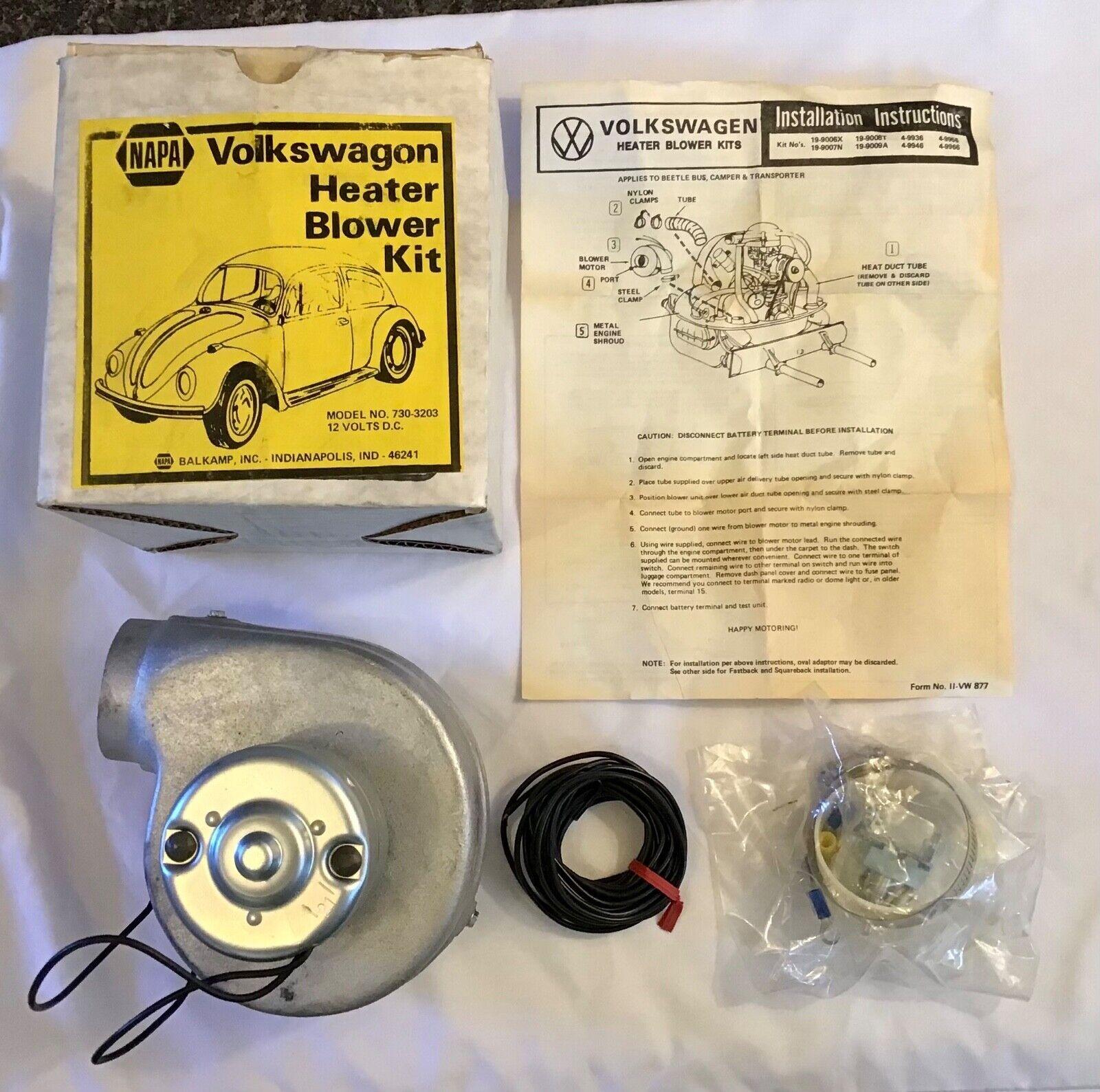

Eric&Barb wrote:
Also found these NAPA heater blower
Seems NAPA doesn't know how to spell Volkswagen

PostPosted: Sun Sep 21, 2025 10:35 am    Post subject: Re: Heater blower motor mounted under rear seat Reply with quote
Also found these NAPA heater blower images that so far seem to have not been added to a thread:

PostPosted: Sun Sep 21, 2025 10:31 am    Post subject: Re: Heater blower motor mounted under rear seat Reply with quote
Hopefully OP found a different blower kit. That Ebay auction is still up, so figured on saving the images from it.
