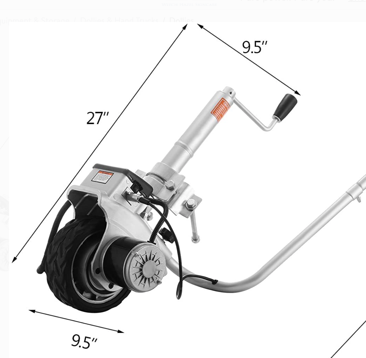

The more I think of this, the better I like it. All RC controlled. A back-up wireless cam mounted on the trailer so you can position the hitch exactly. It can have a platform so once on the trailer at elevation, you can roll forwards on the trailer--backwards while sitting?--and put enough weight on the steerable motorized wheel that you will have plenty of traction. Maybe a knobby tire.
And it has a top, so if you want, you can put the wheelchair back on the trailer once you are inside and leave it there overnight even if it rains.
AND the front of the trailer has room for a small Honda if you want 110 at the site--and propane so there is an opportunity for the cooking and in fact a complete kitchen to serve all your buddies with a decent reefer and pressure H & C water and stowage for everything a fella could ever want.
Price?-----------Zero. We draw this up with some nice renderings--probably just the basic covered unit and do a Go Fund Me campaign. With your medical condition and your story plus with the understanding of the entire world now in the Covid time how important socializing is, I see no problem raising the 3/6K this might cost. Then the buddies help build the kitchen and so on.
Part of the deal to attract benefactors is that you will leave this as a legacy for anyone else in your condition so they can experience and enjoy the wilderness up close and personal while sharing it with their best friends.
With your permission, I'd like to do a few engineering sketches to outline the idea better.

This truck lift is brilliant----but I noticed that the motorized pivot mechanism seems about 6" high and there is a large platform covering the motor mechanism where the wheelchair is lowered. He also has a remote door opener and a seriously tilting steering wheel. This musta cost beaucoup bucks.
Such an idea could be done on a Vanagon with the pivot in the area of the DS rain gutter. An external beam would need to be welded from the B to C pillar and a hydraulic lifter attached. Then you would need a sliding platform to come out of the floor for you to land on before disconnecting and wheeling inside.
Had another thought. I wonder if there is a way to tow a small motorized trailer which is essentially a ramp. The idea is you wheel yourself onto the ramp and move it to the side where you enter. Then you back around and remotely rehitch the trailer and off you go. Probably big bucks too, but no modes to the car itself. I envision a remote operated screw jack at the hitch with a good sized steerable powered driving wheel. To rehitch, you would need a backup camera to be able to maneuver the hitch back over the ball or whatever the hitch point is. A mirror mounted at a 45º angle on the rear hatch might work too.
Or the motorized trailer could have a lift platform on it so you are always level. This way you back onto the lowered platform and wheel into the car facing forward. No awkwardness avoiding the hitch this way. And if the platform is then lowered remotely, you can easily drive off and not worry about scraping the car against the trailer. A combo of these two ideas. By the way, the trailer mover is $215. Needs a bigger pneumatic tire, though.

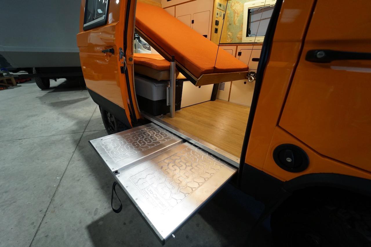

Had another crazy idea--not expensive, but seriously oggilie. A pair of aluminum ramps which hinge to a permanent bracket welded underneath the slider sill and low enough to handle the slider to open. A couple of small additional pieces to cross the gap hinged on the ramps so they automatically allow the chair to enter. A winch under the galley with a remote and a cord so you can pull the hook out and hook onto the chair. Up the ramp, close the slider and push a button which operates a second winch. The Dynama cord fastened to the ramps goes up over the car and down to the second winch. Dynema is quite floppy and is as strong as steel and so can easily go over pulleys and through fairleads. It is also soft, so it won't scratch the paint should it rub some as it goes over the curve of the roof. I imagine gutter attached pulleys as the loads are not high. The terrible part is you have a pair of ramps folded up alongside the slider looking like hell and preventing you from seeing out its window.
Be in good health and keep us posted as to how you are doing.
Duncan

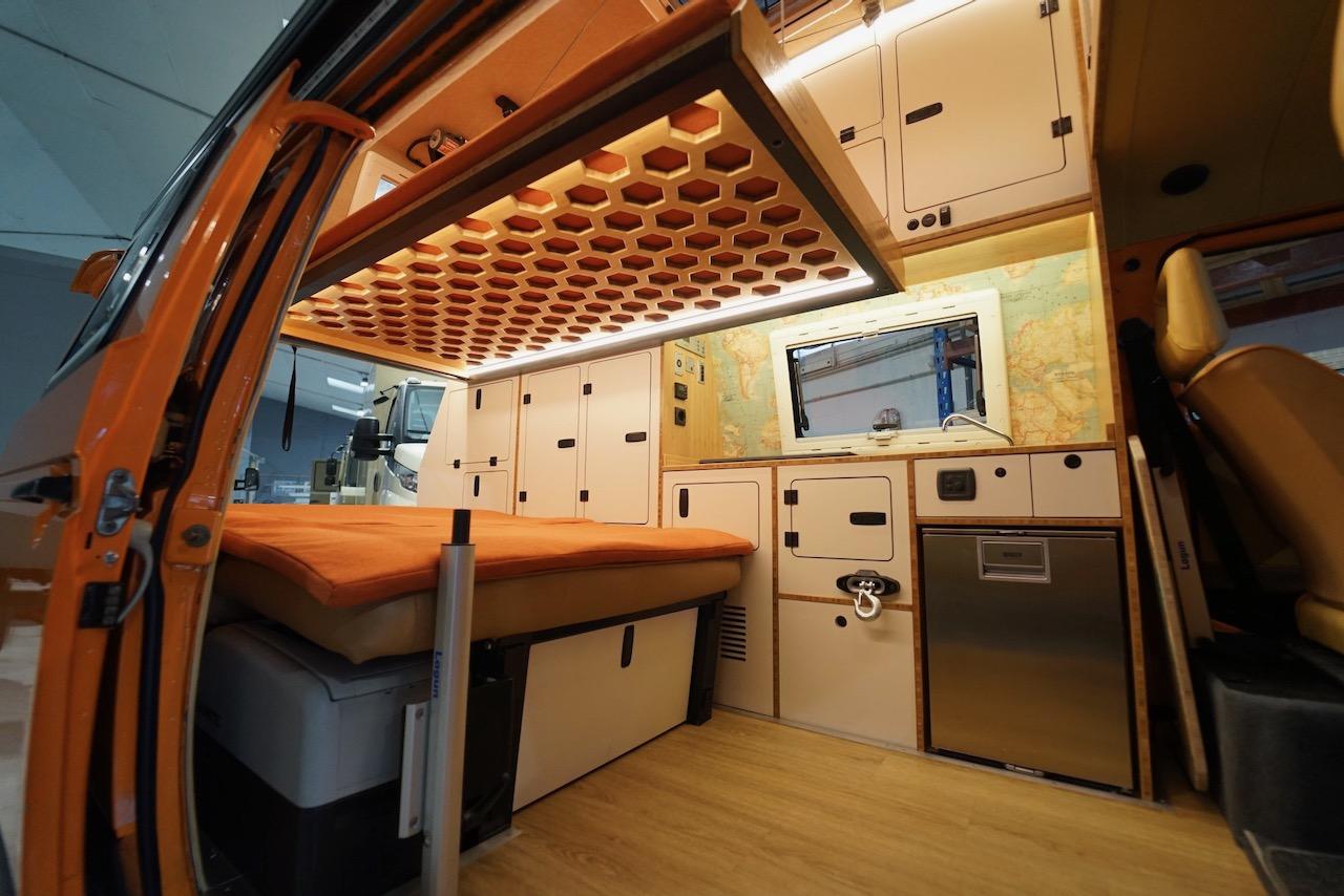

I understand the associations with the Vanagons and the Uplander.
I wonder if perhaps, then, you'd be better served buying a Vanagon already equipped with a lift and installing a back seat bed in it? You'd end up with more floor space for the chairs and you could have the bed custom made to be full-width!
It also seems like you'd have an easier time finding someone who is willing and able to help put a bed in a wheelchair van, than putting a wheelchair lift in a Westy. There are even more people on the forums who have done things like install a pop-top or high-top (as I'm writing this, it seems perhaps a high-top might be a good option in case decreased muscle mass makes lifting a pop top difficult) on a passenger van, than have installed a wheel chair lift.
It appears there may be at least a couple options on this page.
