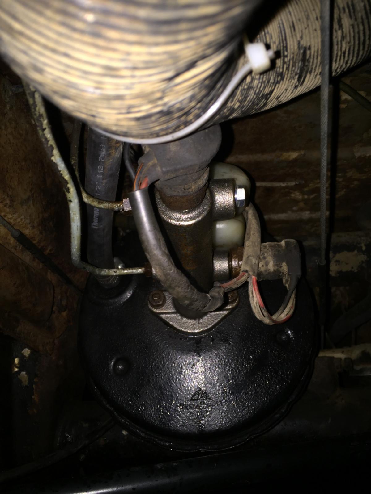

PostPosted: Mon Jan 18, 2021 2:45 pm    Post subject: Re: 1976 Bus - Brakes Mysteriously Faded, Then Came Back - Reply with quote
Thanks all. We had a father/daughter brake bleeding day and the brakes came back fully. Daughter got to experience both scenarios, pumping the brakes and bleeding the calipers. She's also a dab hand now at removing/fitting heavy bus wheels. Smile
We did not have to bench bleed the master cylinder, but took out a lot of air when bleeding. Thankfully the bleed screws came undone easily after soaking all night in PB Blaster.
Test drive and the bus stopped true and straight, no heat generated on the wheels from sticking brakes, etc. We're back in business. Smile
Thanks!

PostPosted: Fri Jan 15, 2021 1:52 pm    Post subject: Re: 1976 Bus - Brakes Mysteriously Faded, Then Came Back - Reply with quote
So I got the old MC off and everything came off fairly easily. The only possible issue was removing the filler tube. There appears to be a "shouldered, black rubber, inner insert at the inlet and the shoulder area is torn up or deteriorated. How crucial is this, can I reasonably use as pictured, and in the pic do I have it the right way around?
Inner booster was dry.
Thanks for your attention.

PostPosted: Thu Jan 14, 2021 6:18 pm    Post subject: Re: 1976 Bus - Brakes Mysteriously Faded, Then Came Back - Reply with quote
Thanks all, New MC should be here tomorrow. I just soaked the brake pipe nuts in PB Blaster for the night in prep.
On a side note, I'm using newly purchased Harbor Freight 6" ramps, should have bought them years ago. Drive right on, rock solid, and lots of work room. Great deal for $45 and rated for 13000 lbs.
I'm getting older and need a little more room. Wink

wagohn
Joined: June 24, 2014
Posts: 744
Location: United States
wagohn is offline
PostPosted: Tue Jan 12, 2021 9:36 pm    Post subject: Re: 1976 Bus - Brakes Mysteriously Faded, Then Came Back - Reply with quote
kreemoweet wrote:
There isn't really a prospect of "refreshing" the M/C, as rebuild kits are not available. I've never had the slightest trouble bleeding system with new M/C with no
"bench bleed" involved. After install and filling the reservoir, air in M/C will just naturally bubble up and out (assuming bus is level, and not at some weird angle).
Rarely, the internal pushrod in booster will be too long to suit the M/C, causing the M/C compensating port to be blocked with resulting eventual brake lockup.
You can somewhat feel that happening by just holding M/C (sans o-ring seal) onto booster in installed position. You should feel no resistance from booster pushrod
in doing so.
Inside of booster should be checked for leaked brake fluid, and cleaned out if present - not too easy if installed.
Take it easy when manipulating metal brakelines, as they will kink all too readily. The metal lines have to be aligned almost perfectly to be able to start the nuts, and
sometimes takes a deal of fiddling to get it right.
