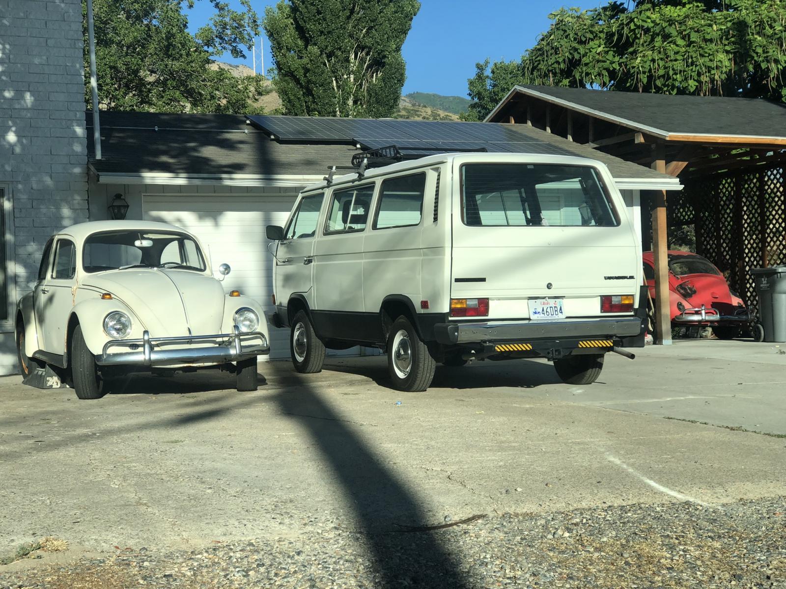

This Sunday we did a 50 mile round trip in Freddie. It was the hottest day of the year, at 103F.
Fun had: Bucket loads
Issues arisen: 0
He ran like a swiss watch, so we are very glad about that.
Here he is, sitting proudly after his run, with the ever increasing Volkswagen contingency at our house.
Hope you are all keeping safe and well, and cool!

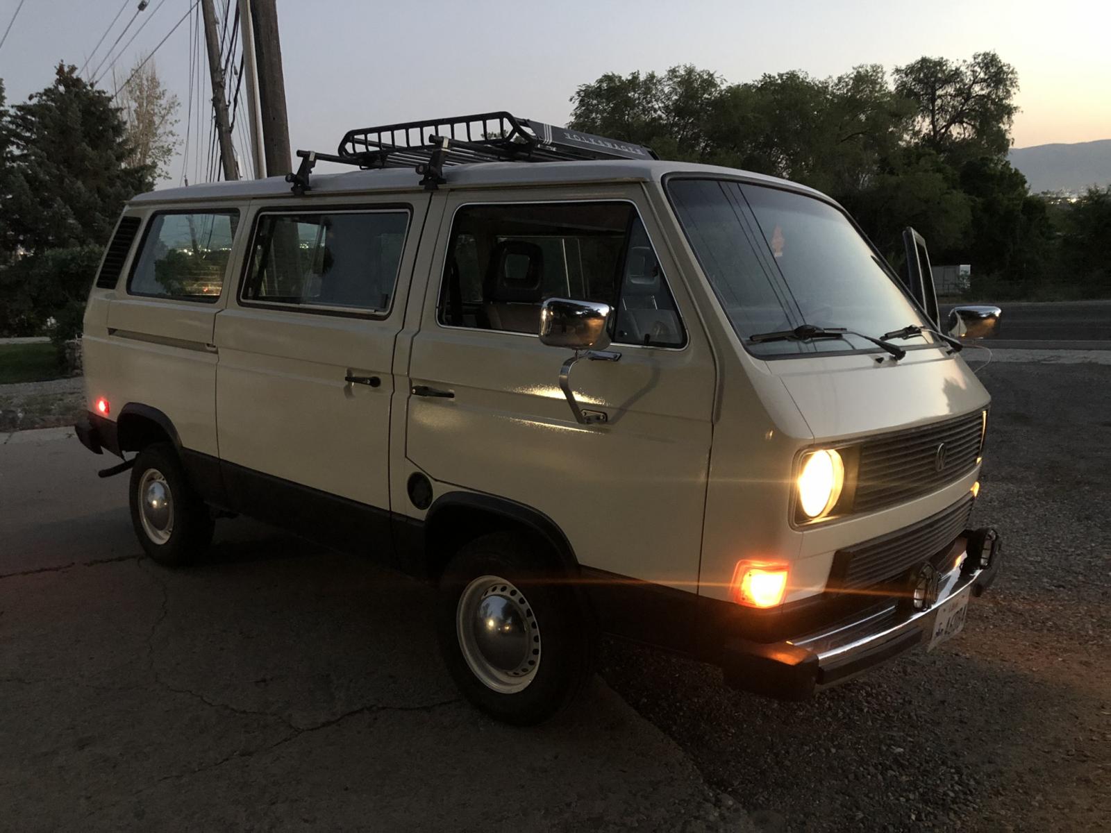

On Saturday, it was a miserable 105F here in Utah. I know there are hotter places but Moses Sandals it was uncomfortable. So with limited time due to imminent death, I ran to a few stores to see how to spruce up the rear side marker lenses.
I went for a $2.79 punt, on this tosh...
Which actually didn't look too bad...
It doesn't dissipate the light particularly well, but I think that's more down to the tired old lenses than the film. Still, does the job for now!
We drove Freddie hard this evening, got him wound up, and then checked the cooling system with a flashlight for leaks...no leaks, or steam, so I think we can say, for now, the expansion tank debacle is behind us. But make no mistake, we have our beady eyes on him, we listen to him, and most of all we love driving him.
That's all for now fella's, cheers and have a blessed week.
