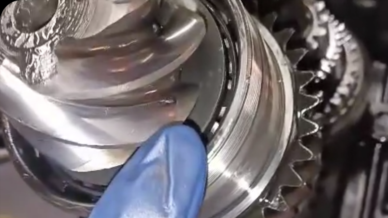

Here is a nice little video on tranny synchronizers you all may enjoy.. Even has strobe light action video!
https://m.youtube.com/watch?v=e-Lk3FXHubw

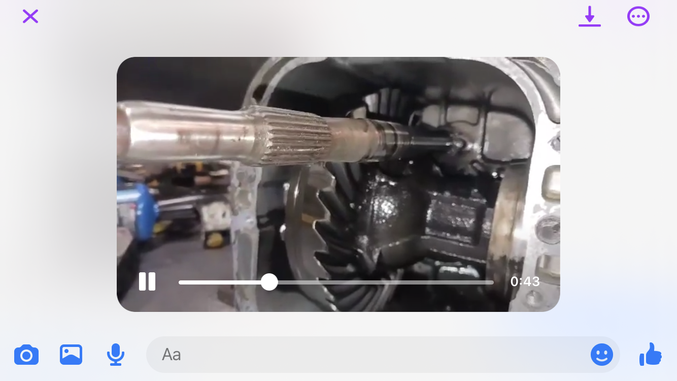

Bummer about the R&P.
Thass why I say keep clean oil in it.
Theres no economy in running contaminated gear oil longer when clean oil is only $30.
Especially in an old trans that may have an old gear or 2 ready to start shedding steel into the oil at any time.
Well at least you have an Aluminum case!!
Those are hard to find.
Big engine fellers be envious.
Good thing you didn’t “exchange” it away.
I just saw a video where an aussie guy used a compressed air nozzle to force oil out of a soda bottle, up a tube into a gearbox.
It looked like a great DIY trick.

Well a bit of an update. Not ideal news on my transaxle teardown at builder. Ring and pinion damaged. Potentially a couple other issues. Turns out someone had “hodgepodged” together the transaxle at some point. 4.83 r&p, 2 spider gear diff, with aluminum case. All on my 84 westy. I guess its good that it was discovered as part of a rebuild not after a breakdown across the country..
Might be needing to locate another core. Leads welcome.. Very Happy
