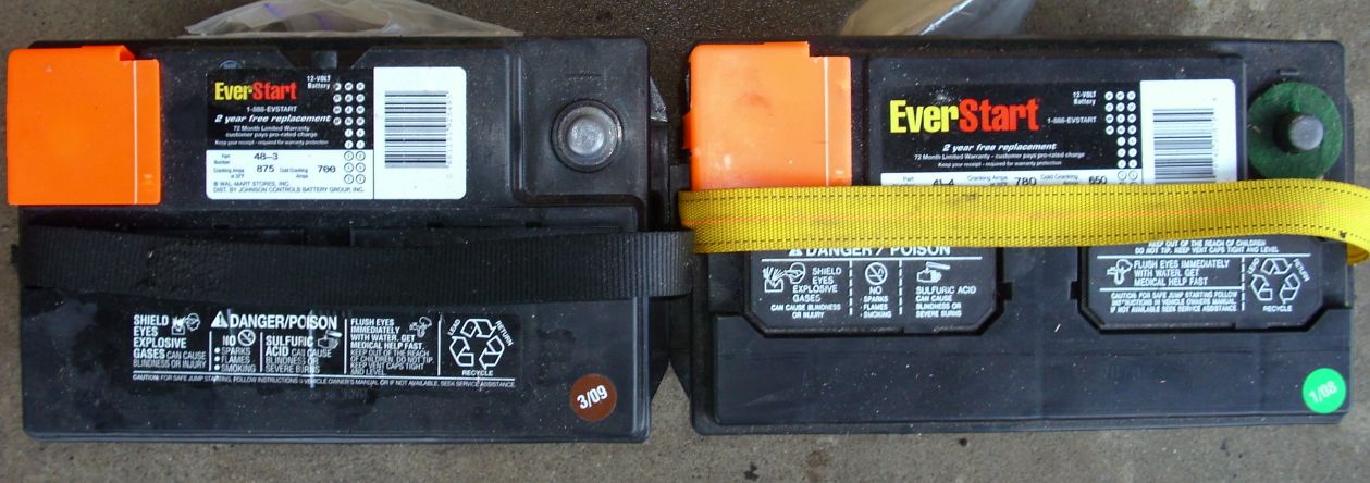

It is weird that the holes for the plastic positive terminal cover that comes on group 41 batteries are missing. Battery shorts are bad.
Picture borrowed from the gallery

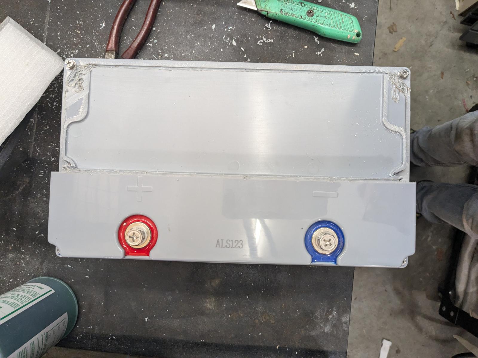

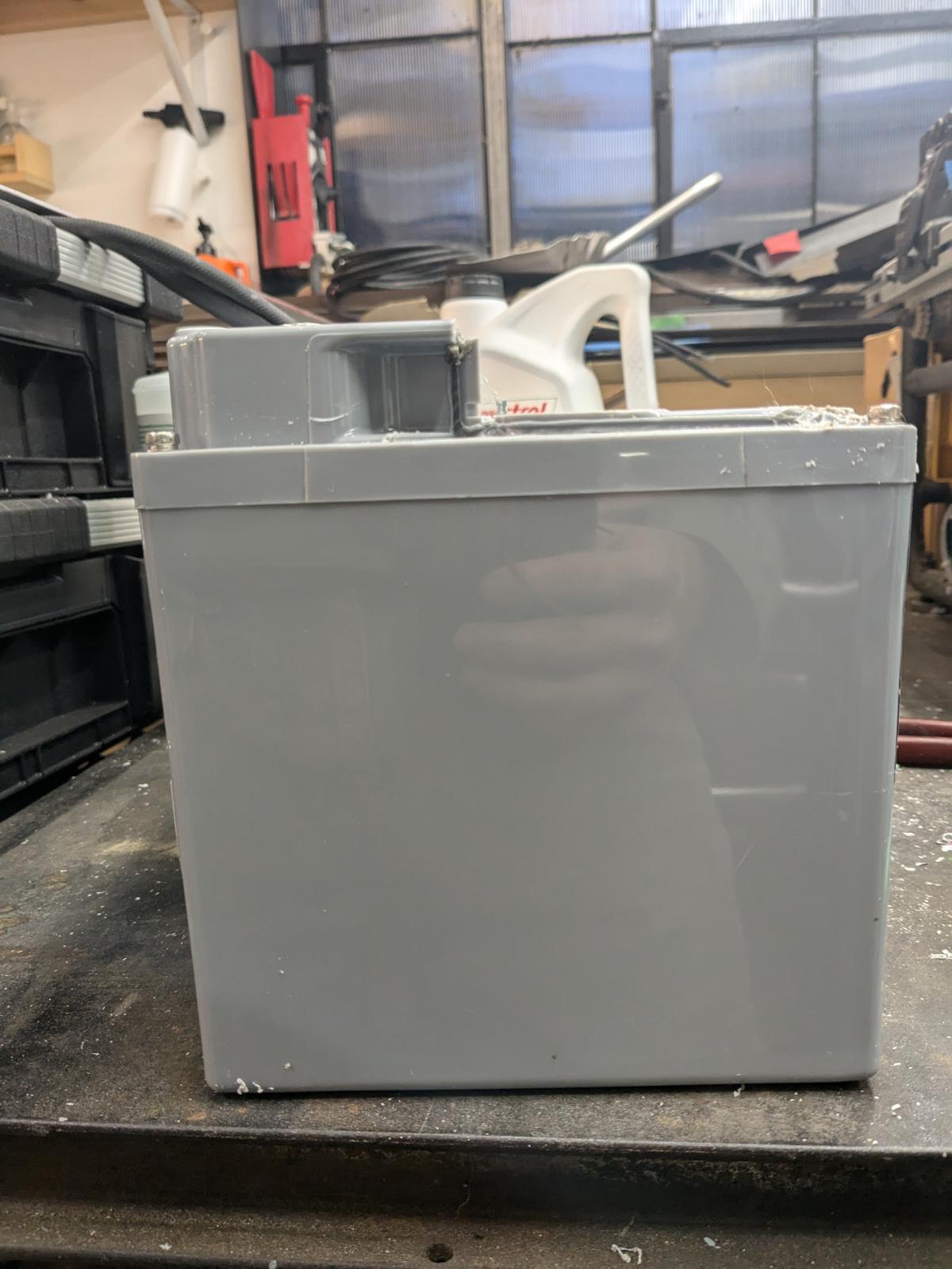

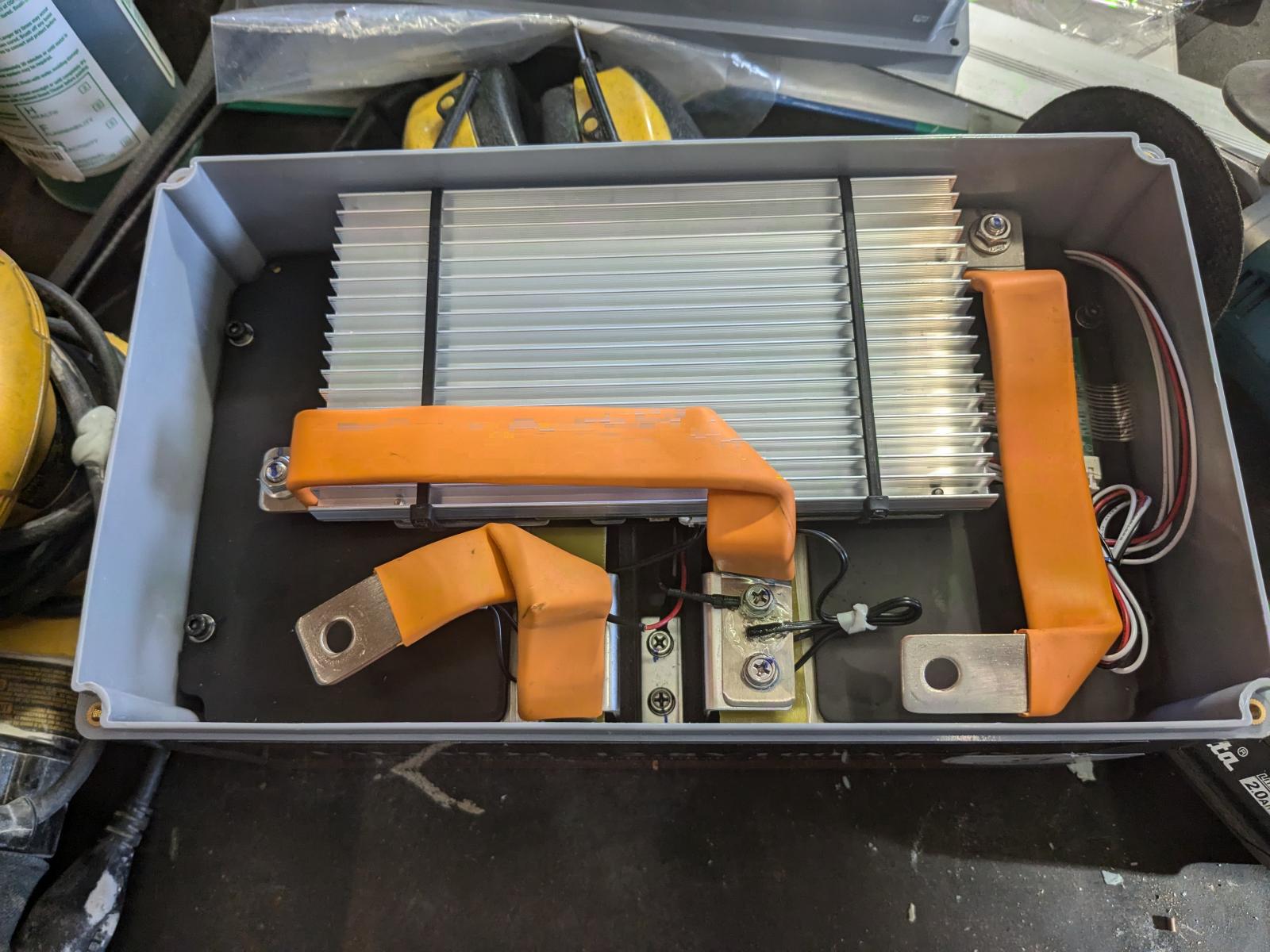

Well everybody, It was reported to me on Samba that this thing fits, but a better description would be that it *almost* fits. i have been here before and learned a long time ago on other vws to modify the tech, not the bus, so i dont regret it in the future that i hacked up a classic for a trendy new piece of tech.
So this AO lithium ion battery is a very close fit, but i saw on here one solution of someone hammering away at their battery box to gain the couple millimeters and opening a body seam in the process and decided i didnt want to go that route. I am currently prepping the car for paint and dont want to invite new problems since its Syncro and is super rust free, so i started looking at this battery....
There's an inch or more of clear space above the control panel and heat dissipator inside.
So i pulled out the tablesaw.... and the lid of the battery...
and flipped the part i cut off to provide lower profile in the battery compartment.
Then used the soldering iron as a plastic welder....at 750 degrees worked best.
It is hooked up to solar and so far works fine. i do not however have loads on it to monitor for any temperature impacts to my 'adjustments'. The battery now fits with 3/4" inch to spare, mounted sideways. room for soundproofing on the wheel well box.
Voided the warranty? surely. But i am invested in this battery 169 dollars ( a lot less than the car investment) . It seems like a responsible abuse of technology.
Cut the syncro? Nope.
Whenever this battery dies, the next generation from AO or another manufacturer will surely be smaller. I think they already have the next gen out, and that is the reason for the fire sale on these units.
Hopefully this helps others not chop up their vans to make this work, but may be dangerous and irresponsible attack on a plastic box. It is now kind of a hybrid of unit battery and custom set up. i am not a battery nerd i just wanted something for a reasonable price with good capacity for a house battery that fits under the drivers seat, as the title of the thread suggests.
