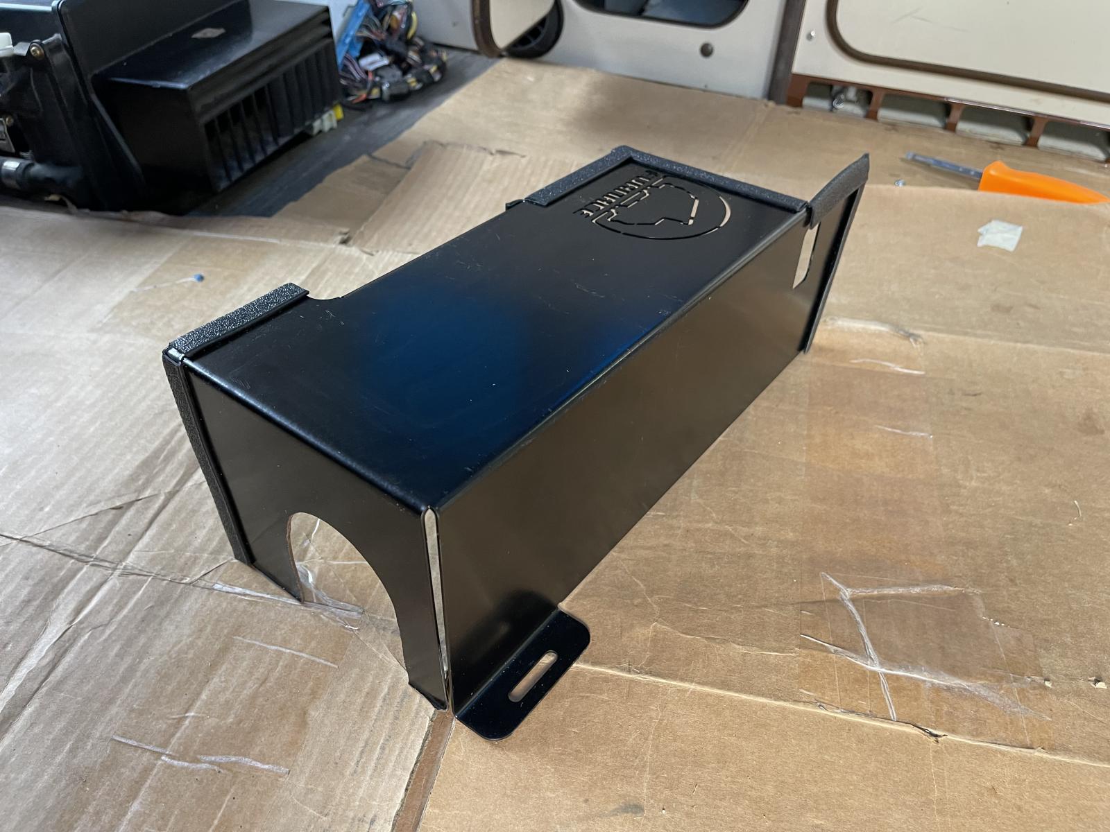

Dimensions? For those that have one of these, could someone please post the physical dimensions of the unit? I'm trying to see if it will fit underneath a Truckfridge49 (either with or without the slight mods mentioned in this thread)

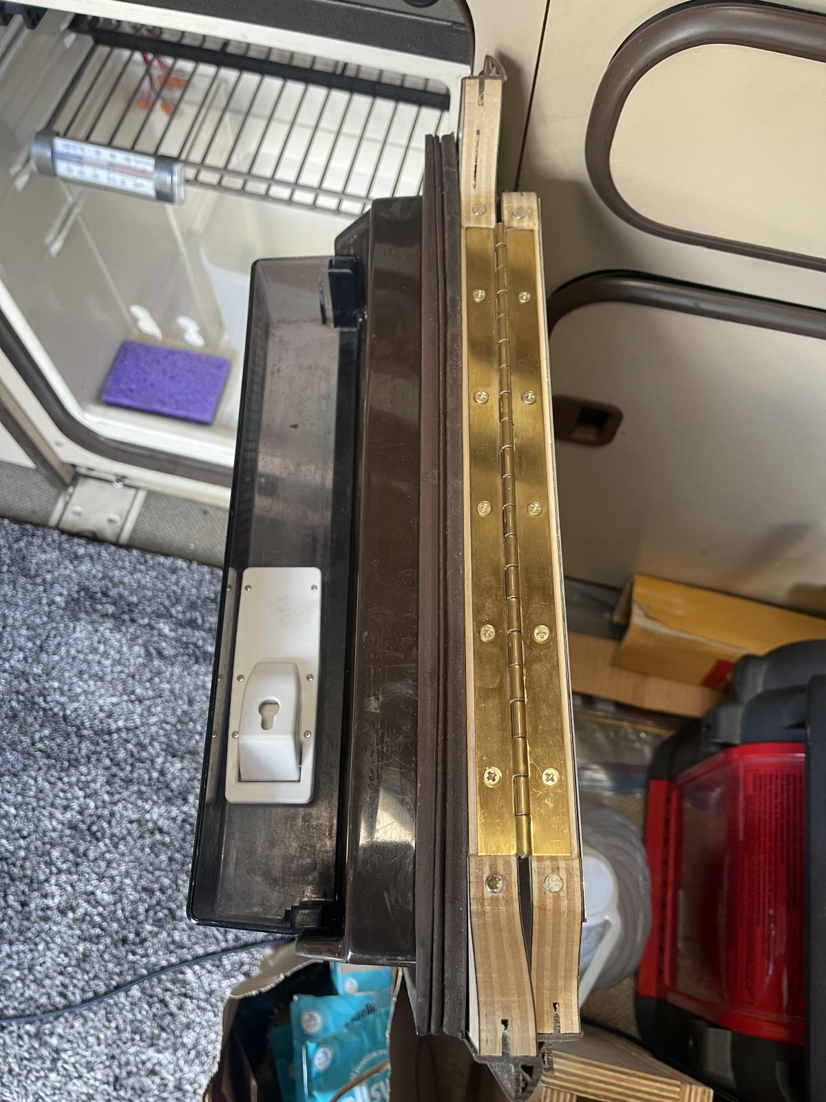

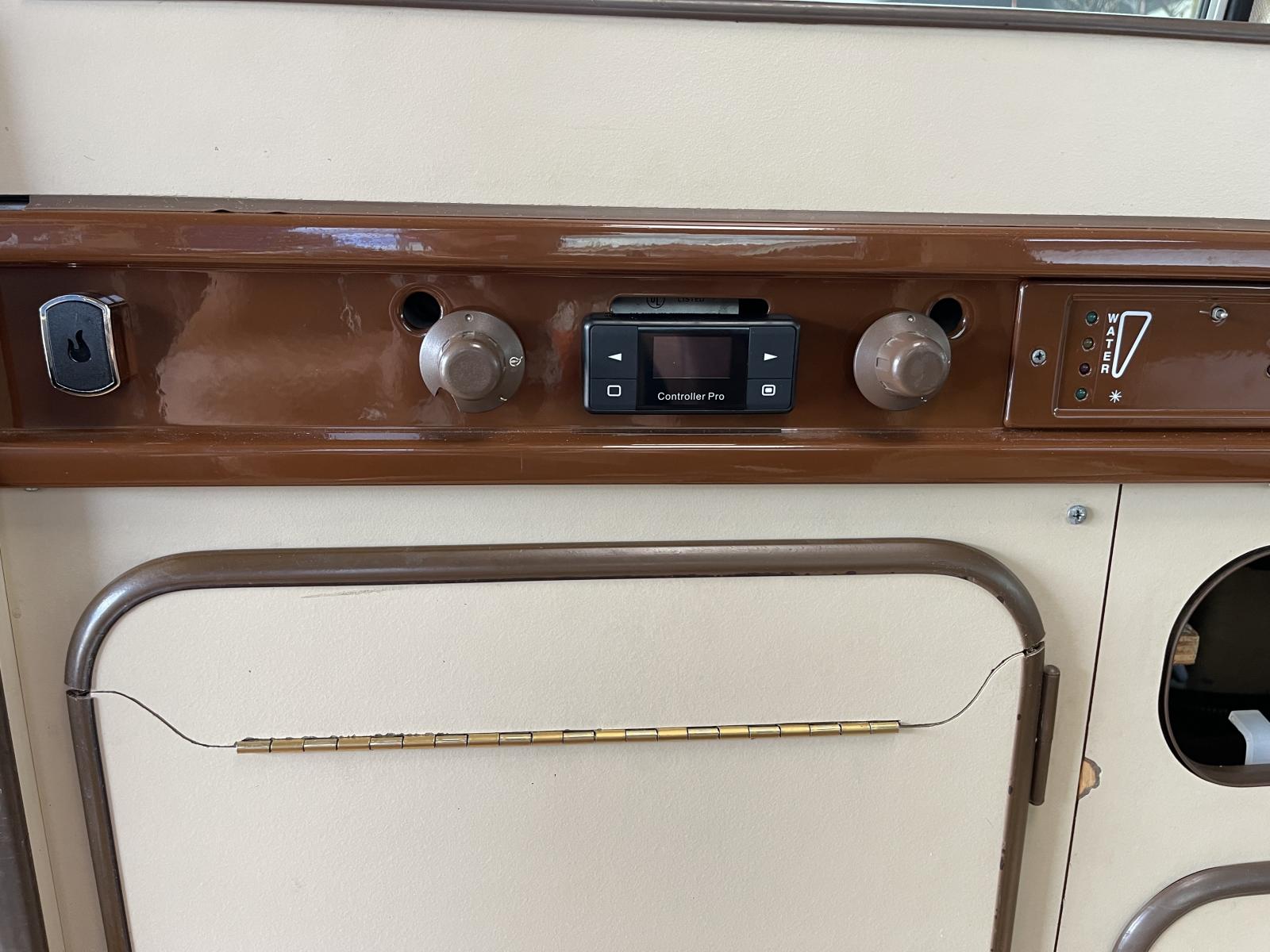

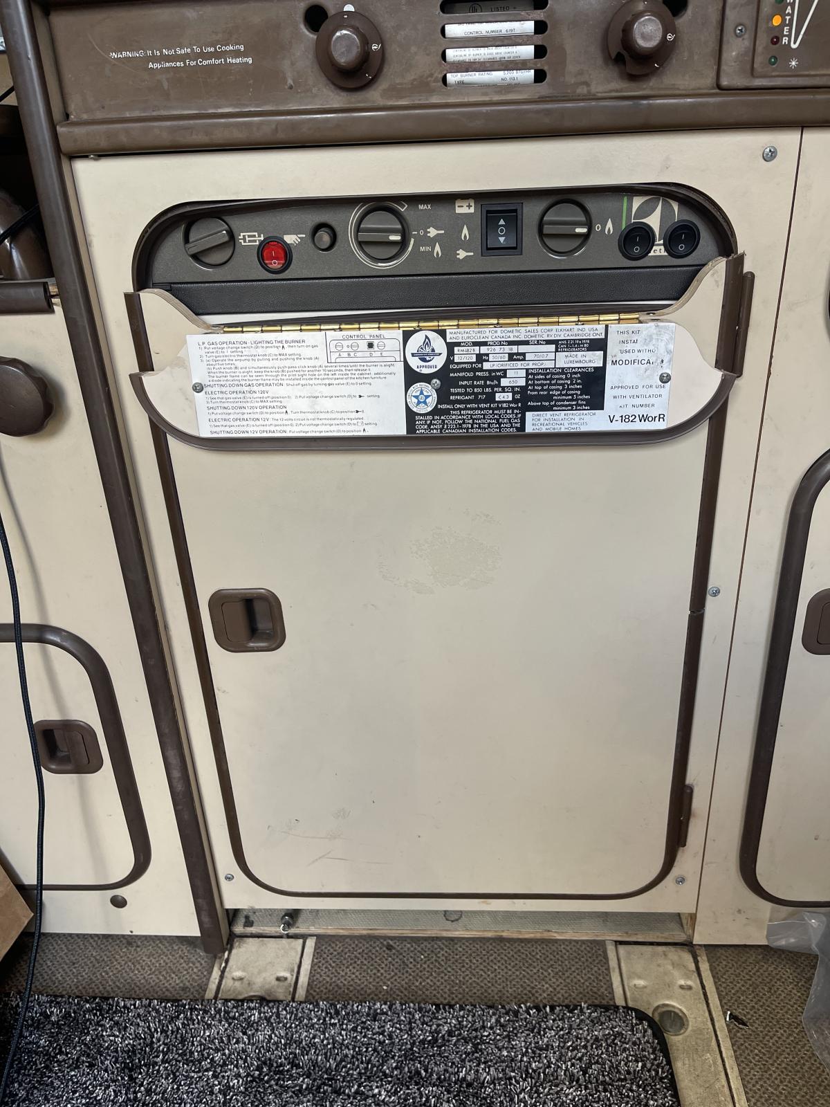

PostPosted: Tue Nov 18, 2025 8:15 am    Post subject: Re: GoWesty Gas/Petrol Heater Kit - 4 year warranty Reply with quote
Yes to better clamps and fuel pump mount!
The hinge on the fridge door, allows me to access the controls without having to dump all the cold air out of the fridge. Neodymium magnets countersunk in the door to keep the panel upright while traveling.
Here’s the origin of the idea:
https://www.griffco.ca/VW/vwfridgemods.html
(More good stuff): https://www.griffco.ca/VW/vwmods.html
From the left, the red switch is my automatic igniter. If the flame in the combustion chamber goes out, the igniter automatically strikes and keeps the fridge lit. Also, no more need to click the left knob to ignite, auto piezo strikes every 3x/seconds. The other two switches are an internal fan, and two rear fans. The rear fans switch overrides the thermal sensor, but if you leave the switch off, the fans turn on when the thermal sensor circuit closes.

PostPosted: Tue Nov 18, 2025 8:10 am    Post subject: Re: GoWesty Gas/Petrol Heater Kit - 4 year warranty Reply with quote
I've installed furnaces with the thermostat in the back, at the kitchen, and on the dash.
On the kitchen is my most loved install location. It's very convenient.

PostPosted: Tue Nov 18, 2025 4:33 am    Post subject: Re: GoWesty Gas/Petrol Heater Kit - 4 year warranty Reply with quote
I’ve thought about moving my controller to the front of the stove, I like that.
What’s with the hinged panel on the front of the fridge cabinet?

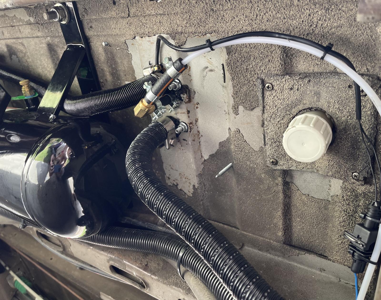

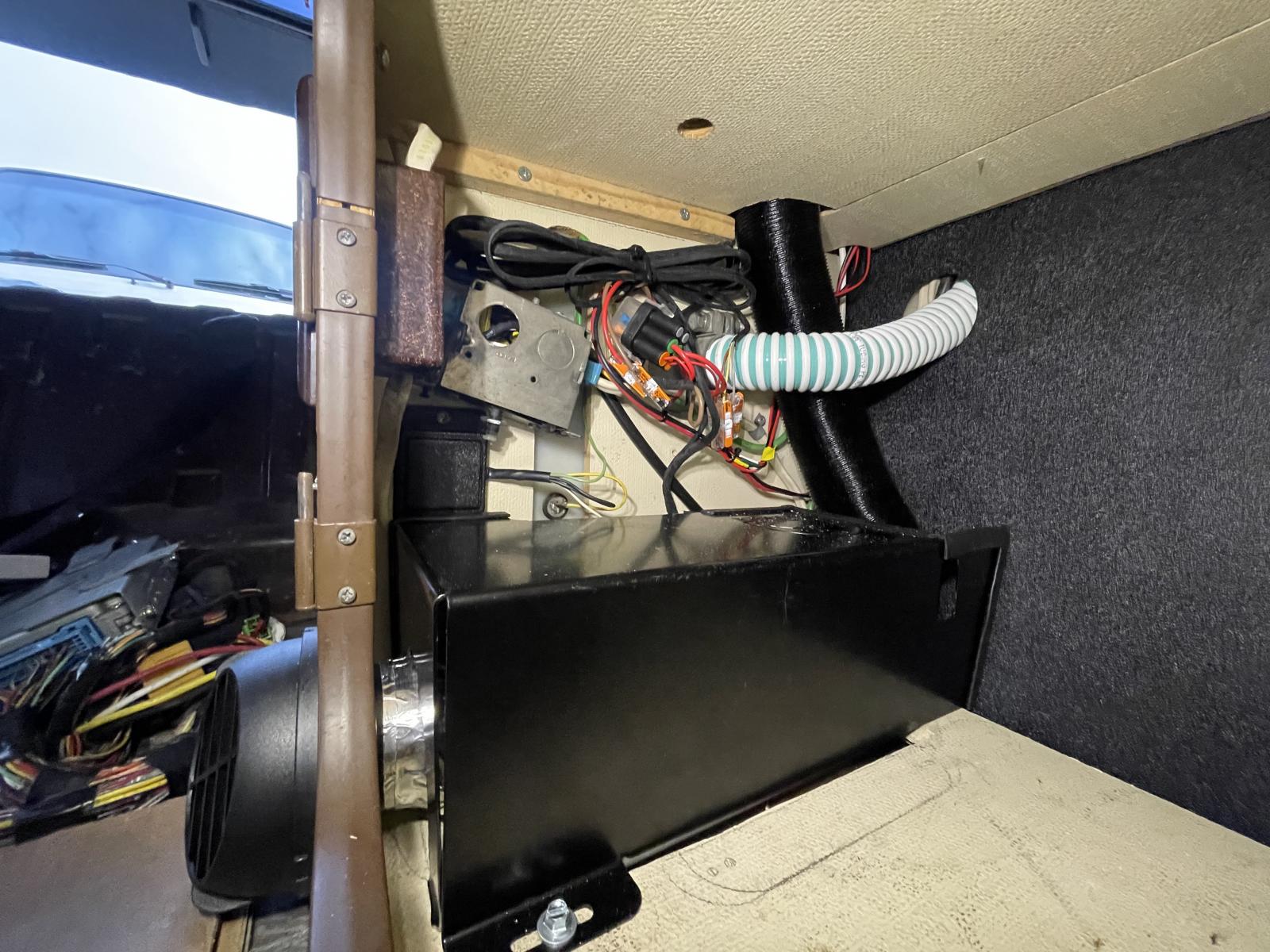

PostPosted: Mon Nov 17, 2025 7:13 pm    Post subject: Re: GoWesty Gas/Petrol Heater Kit - 4 year warranty Reply with quote
Nice install. The furnace looks like it was made for that closet space..
Cool
One cautionary note…The fuel pump mount in your picture is tearing, I’d recommend new ones soon.

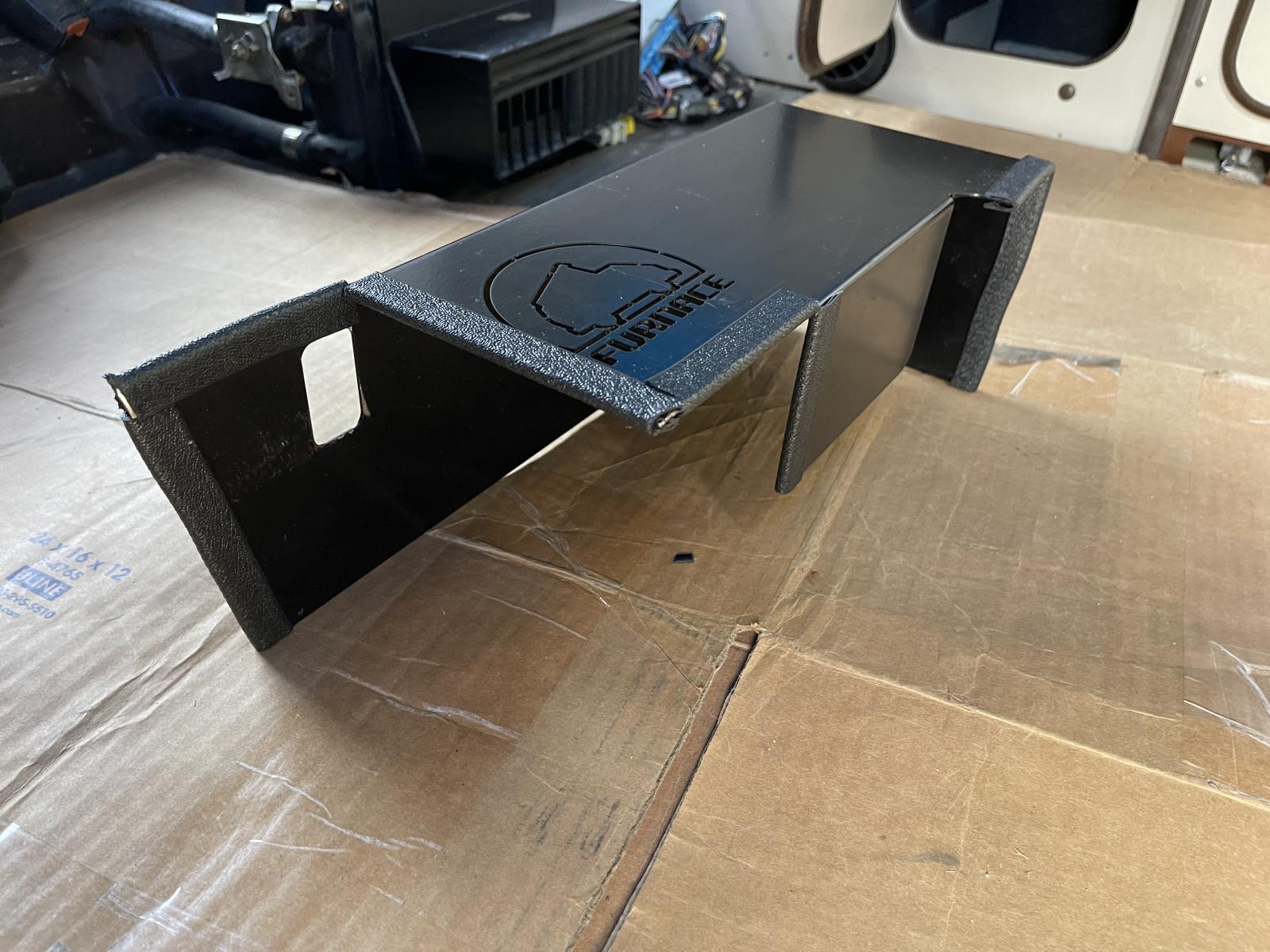

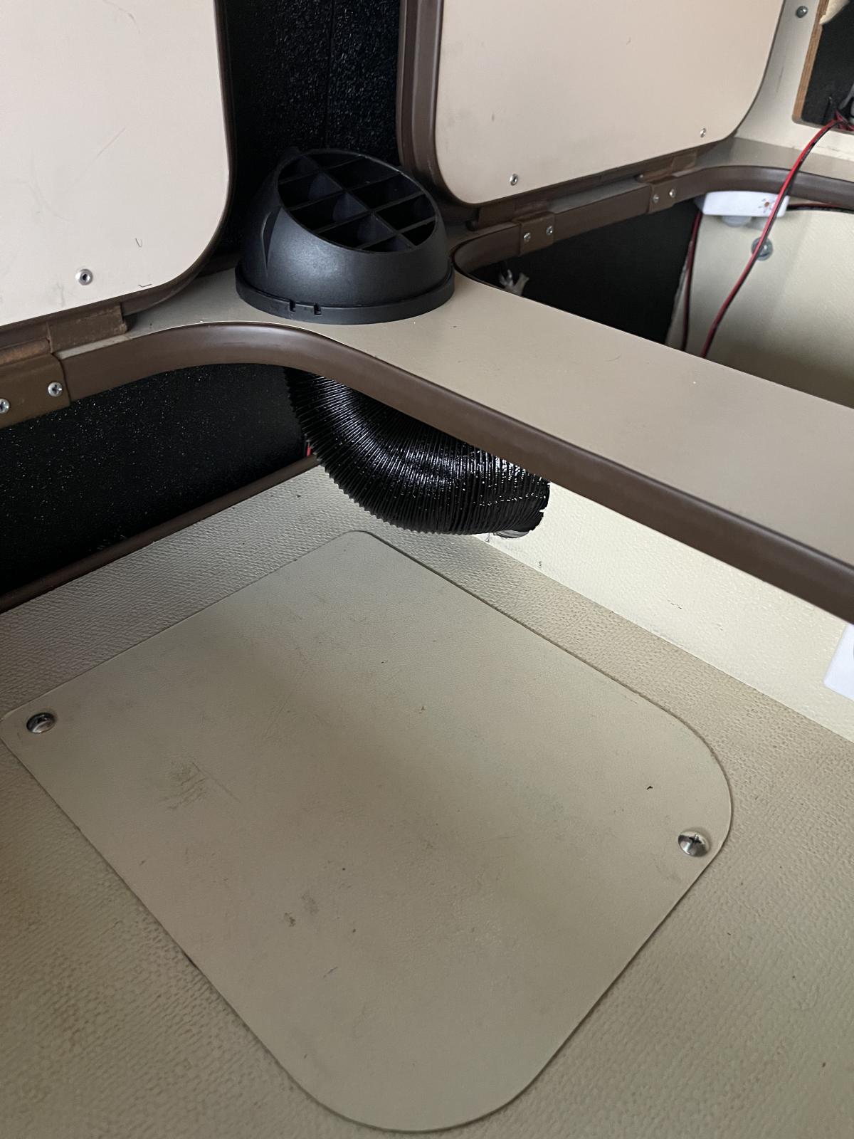

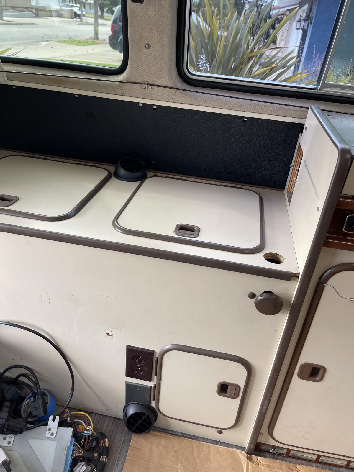

PostPosted: Mon Nov 17, 2025 3:21 pm    Post subject: Re: GoWesty Gas/Petrol Heater Kit - 4 year warranty Reply with quote
Here’s my attempt. I always felt like the hidden electrical cupboard was a waste of space. I once saw someone else use that space, and knew I’d use it someday. Turns out it was the furnace. (Sorry, my bench seat isn’t back in yet)
I was at the very start of repairing seam rust on the driver side when GoWesty came out with the furnace. It was the perfect opportunity with all the cabinets out. This one took a lot of modification of the water tank cupboard as well as the GoWesty furnace cover.
Hot air blows at your toe’s, cold air return is on top.
This one is going to be photo heavy.
Thinking about a heat shield between the propane tank and the furnace exhaust.
Instead of the in-line T before the fuel pump and filter, I opted for a Y with a shut off.

PostPosted: Mon Nov 17, 2025 5:00 am    Post subject: Re: GoWesty Gas/Petrol Heater Kit - 4 year warranty Reply with quote
The tee should be the first connection after the tank, before the fuel pump.

Chilepines wrote:
rowan wrote:
Should I cut the fuel line and install the t-fitting between the tank and the fuel pump, after the fuel pump but before the fuel filter, or after the fuel filter? Does anyone know?
In my installation using the GW instructions, the fuel line T goes between the tank and the main fuel pump. I'd think that is the case regardless of engine or drive mechanism (I have a 2WD with a Subaru)
That's what made sense to me but I always like to check.
thanks,
r

PostPosted: Sun Nov 16, 2025 8:58 pm    Post subject: Re: GoWesty Gas/Petrol Heater Kit - 4 year warranty Reply with quote
