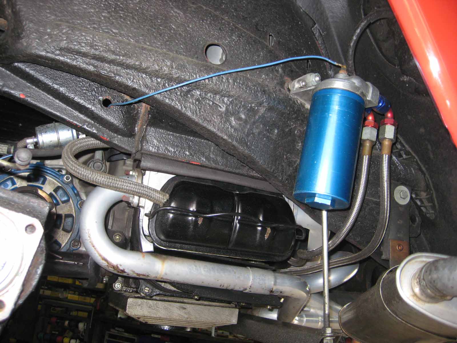

The only thing that's hard is getting to the #1 and #3 plugs. I cut 1.5" holes on the fender and can easily access the plugs with a socket that has a built in swivel and a locking extension. I use a piece of hose, on the engine of the plug to get then started when reinstalling.
If you want easy access, then drive a Ghia.
