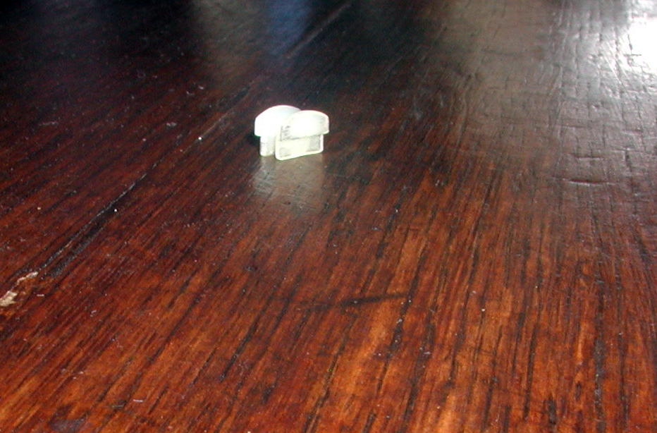

The PO hacked in some bay bungees and drilled holes four inches higher and on every window. Just wish people would do things right the first time.
Any ways, I'm searching for bungee retaining clips:) if anyone has any they could part with please PM me!!
Borrowed picture from above!!
Jacek in Poland makes an excellent reproduction of these two clamps as well as an awesome reproduction of the entire bungee cord kit ready to install.
Bill Bowman
Super hard to find although they do come up occasionally. These work from Home Depot as a temporary solution:
I used them until I was able to find some originals.
That's a nice substitute!! I got lucky and ended up finding a set of originals threw a connection I made at OCTO!!

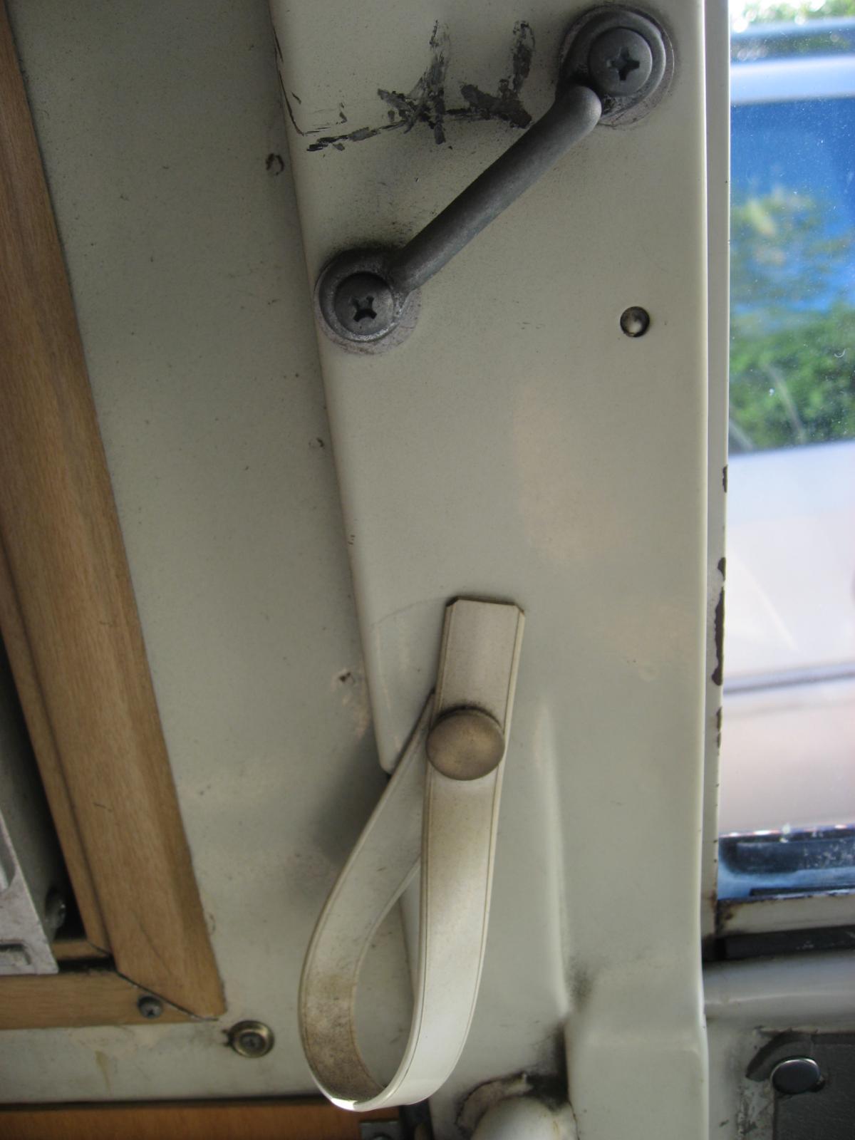

epayne611
Joined: February 09, 2011
Posts: 316
Location: Orange County, CA
epayne611 is offline
PostPosted: Wed Jun 03, 2015 8:30 pm    Post subject: Reply with quote
Surfndoc sent me a pic of his last night, I went out to my bus and was able to locate my original holes hidden by bondo with a dental pick and flashlight. Glad I asked first and didn't drill the upper hole. So any ideas what that upper hole is, with the metal behind?
srfndoc
Joined: August 21, 2010
Posts: 3414
Location: SoCal
srfndoc is offline
PostPosted: Wed Jun 03, 2015 7:23 pm    Post subject: Reply with quote
Mine are similar:
BarryL Premium Member
Joined: November 01, 2004
Posts: 15469
BarryL is offline
PostPosted: Wed Jun 03, 2015 6:34 pm    Post subject: Reply with quote
Never removed straps on my original '67 SO-42. They are facing the way they hold the curtains back from getting hung up when you get out, too.
