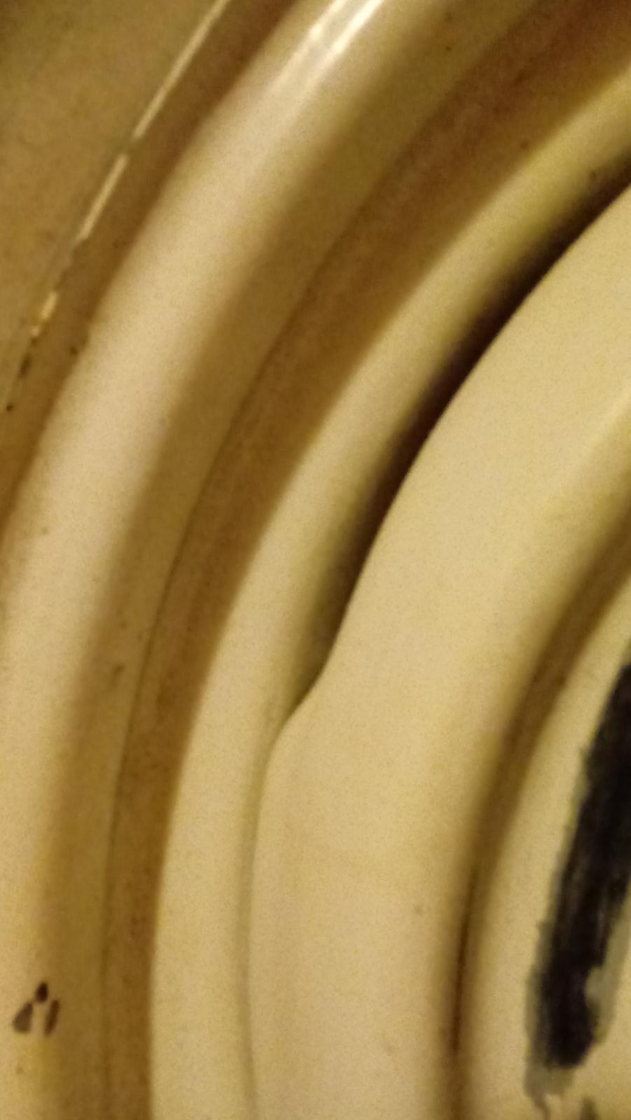

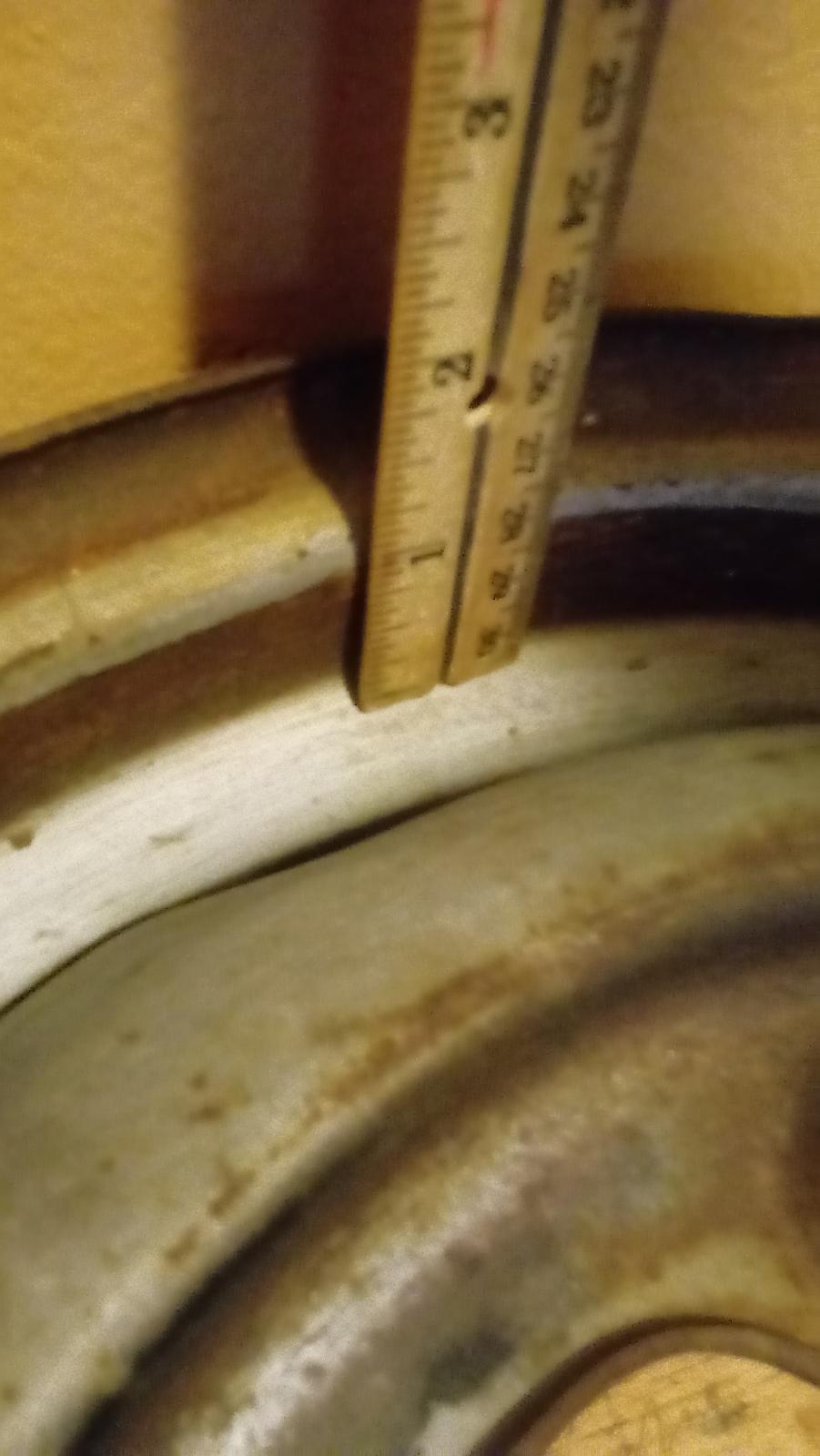

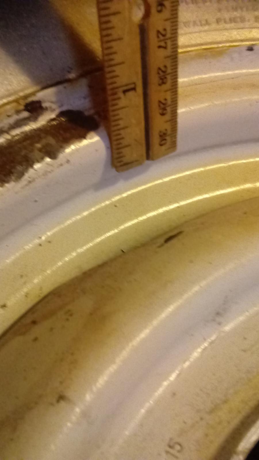

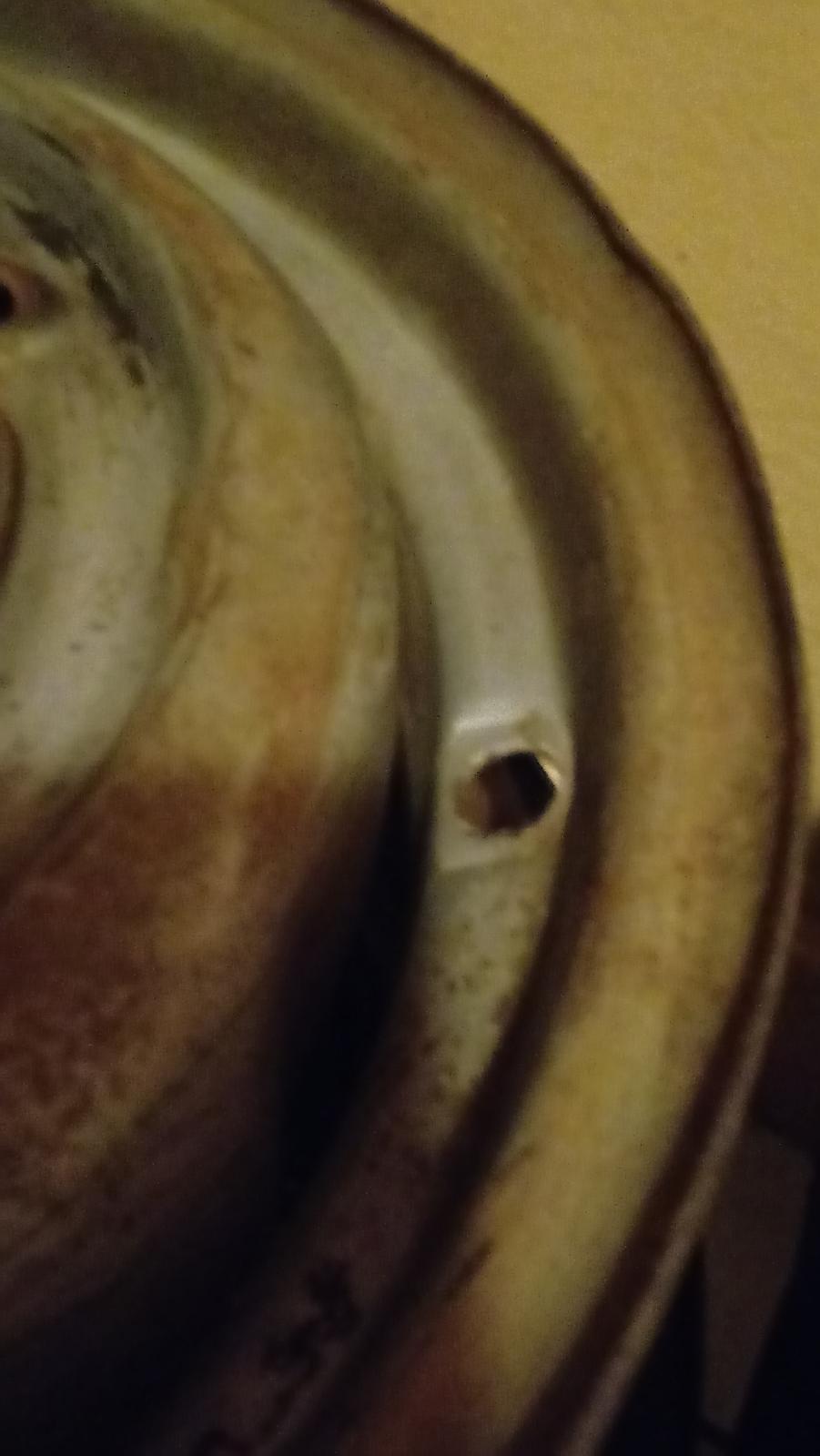

Nancy08
Joined: March 31, 2011
Posts: 9
Location: Bell GArdens
Nancy08 is offline
PostPosted: Mon May 08, 2017 10:17 pm    Post subject: Re: Notch wheels Reply with quote
His 61 different lip as a 62 or 63 wheel i have a slotted wheel but the one as a smaller lip its about. 1/2 and the ither is like One inch
Posts: 71830
PostPosted: Tue May 09, 2017 8:36 am    Post subject: Re: Notch wheels Reply with quote
I don't think so but post a photo so we can see what you are talking about.
Is the wheel dated 1961? They have a date stamp on the face between 2 of the lug nut holes
Nancy08
Posts: 9
Nancy08 is offline
PostPosted: Tue May 09, 2017 10:04 am    Post subject: Re: Notch wheels Reply with quote
Has u could see the lips are different
I can see the date one the white rim can any one tell me if this is a 61 rim because of the lip
Posts: 71830
PostPosted: Tue May 09, 2017 5:17 pm    Post subject: Re: Notch wheels Reply with quote
I don't know but I can't see the difference in that photo either.
Nancy08
Posts: 9
Nancy08 is offline
PostPosted: Tue May 09, 2017 5:48 pm    Post subject: Re: Notch wheels Reply with quote
U can see the lip
Nancy08
Posts: 9
Nancy08 is offline
PostPosted: Tue May 09, 2017 6:08 pm    Post subject: Re: Notch wheels Reply with quote
Has u can see the lip ends at the valve stem hole and the white rims. The lip is different
Nancy08
Posts: 9
Nancy08 is offline
PostPosted: Tue May 09, 2017 6:34 pm    Post subject: Re: Notch wheels Reply with quote
The lip is 1 inch
The lip is 1/2
