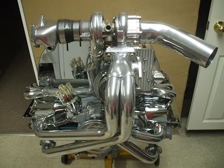

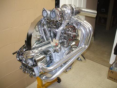

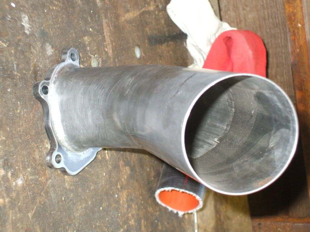

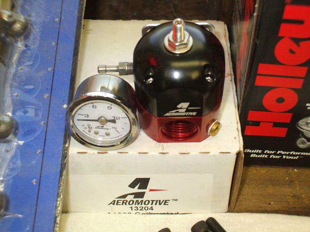

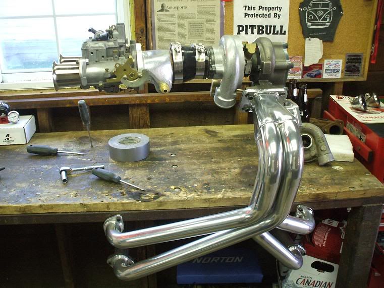

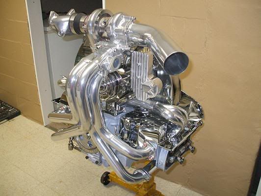

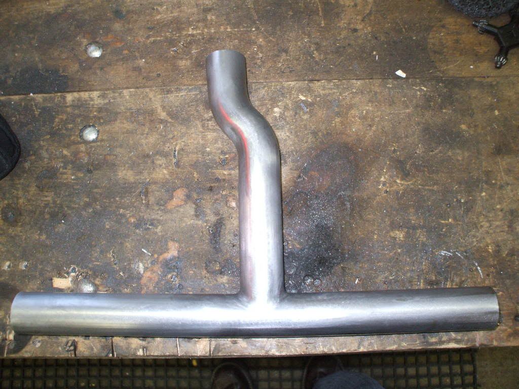

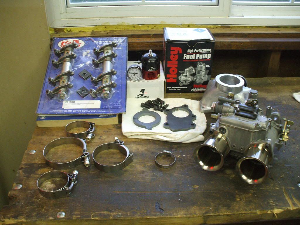

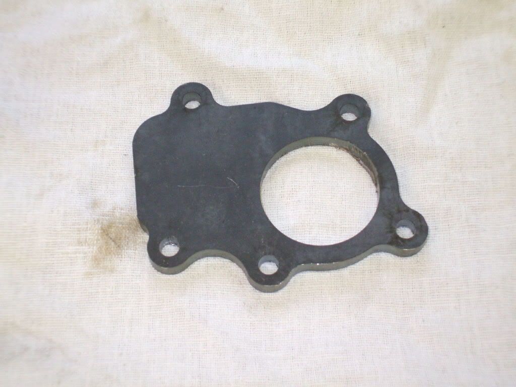

heres a few pics of the progress ive made on the 1600 turbo build im doing.im still waiting for parts but its going along real well so far.yesterday i welded up the t-section intake,it curves a bit to clear the alt.i also welded up the dump pipe and im fitting everthing to go out for chrome hopefully this week.i had a local guy cnc the flanges for the dump on the turbo and the compressor side.theres also a pic of the aeromotive fuel pressure regulator(boost sensitive)that im using and other parts.the header and intake that bolts to the carb are pieces from brothers vw shop.the carb is a dell that i got from tkisner a while back.the shroud is getting replaced with one without the duct cutouts.the turbo is a gt25 from garrett.ill keep you posted as to the progress.

NICE Cool where did you get that fuel pressure regulator, and how much do they run, if you don't mind me asking?

its an aeromotive piece that i picked up from a friend that owns a performance shop in town.i paid about 140 with the gauge if i remember right.another friend runs one for FI on his blown mustang and he recommended it.

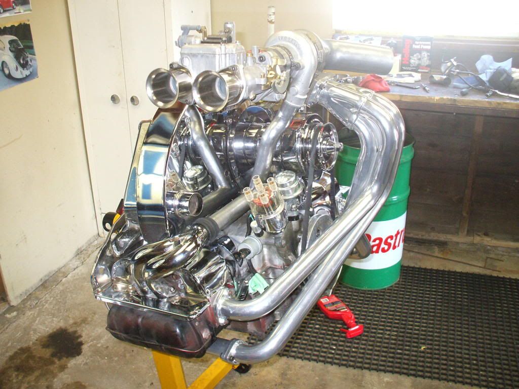

Whatever you do, ditch that distributor cap with the quickness.

Is there ANY real downside of having a transparent dissy cap, or are they just all poorly made? And can you see the sparks when it's running? ^^

you can see some spark in the dark. i have a blue transparent one and i've noticed no difference. i keep the bosch in the car just in case.

I have seen many burned, cracked, etc... stocks are way better.

what are the engine specs? exhaust tubing size (15/8 ?) seems a bit to big for a 1600.

They are junk, pure junk, and nothing but junk.

the headers are 1 5/8 and ya they are on the larger size but i intend on building something a little bigger down the road to use it on.the turbo is a ballbearing unit (as per performance shop and #)so it should hopefully spool up a little quicker to offset the larger exhaust.ignition is going to be a petronix set up in the dist. and an msd 6al btm that im trading a friend for(he needs a 6al).

oh ya the fuel pump is a blue holley unit.i figure that since im going to build a bigger motor eventually id buy the better/bigger stuff once and restrict it ,rather than buy something that is border line usable or not good later on.

what size carb is that?? A buddy and I are working on a turbo set up for his rail. I will post some pics later.
DarthWeber
Joined: November 24, 2007
Posts: 7543
Location: Whittier,CA
DarthWeber is offline
PostPosted: Sat Nov 08, 2008 10:50 am    Post subject: Reply with quote
45DHLA?? My guess.

Funny, I used one for 50,000 miles on a baja bug. Rain, So Cal heat and whatever didn't touch it....
Amazing at how many people play follow the leader here...
Next, I'm sure you'll tell him to ditch his chrome doghouse...
What a joke...
Great job, RAAAID..... Cool I'm sure it's going to be a nice motor. Cool

What turbo is that? Looks like a Nissan T25 or T28?
I love my T25.
It's performed flawlessly on my 1600.
Yours makes mine look like junkyard fodder, though. Very Happy
Go sane on the cam and you're gonna have a blast.
I'm using the stock VW with 1.25's with excellent results.

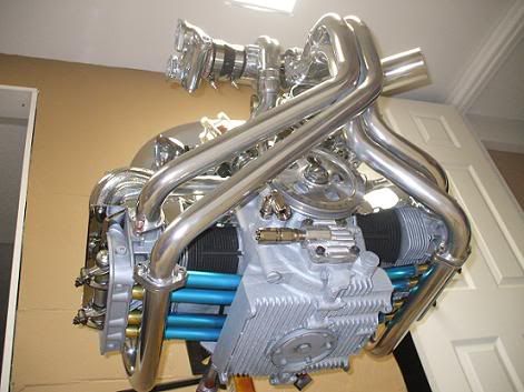

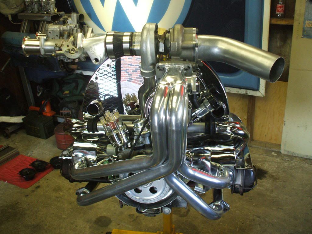

well i finally had some spare time this week so i started getting the motor back together.still not done but progress.some stuff still needs to be fastened but you get the idea.heres some pics.im still cleaning up the carb and stuff but should be on soon.also the wastegate flange will serve for an wideband o2 sensor port.
