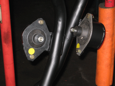

I'd heard of people using Volvo hydraulic mounts from the automatic 740's. That's a lovely set-up.

Erik, I was never able to get a definitive answer on which Volvo model mounts work. I came across some photos that Frank Grunthaner had of adapting the 82 diesel carriers to utilize the saab mounts here on Samba. In one of the pictures I was able to determine the saab part number. In the end, I was not able to adapt the 82 diesel mount brackets to work with the Saab mounts as pictured and ended up cutting the vw brackets off completely and starting from scratch. Here is a picture of Frank's design. While useable, my angles were off because my adapters are custom. I also wanted to better support the saab mount as it was orginally designed for. mark

As for the mounts, I had considered using a simple piece of angle attached to the stock bars which would allow the Volvo pieces to use their vertical mounting stud. Unfortunately my R&D budget is severely limited so for now I live with the stock set-up.
