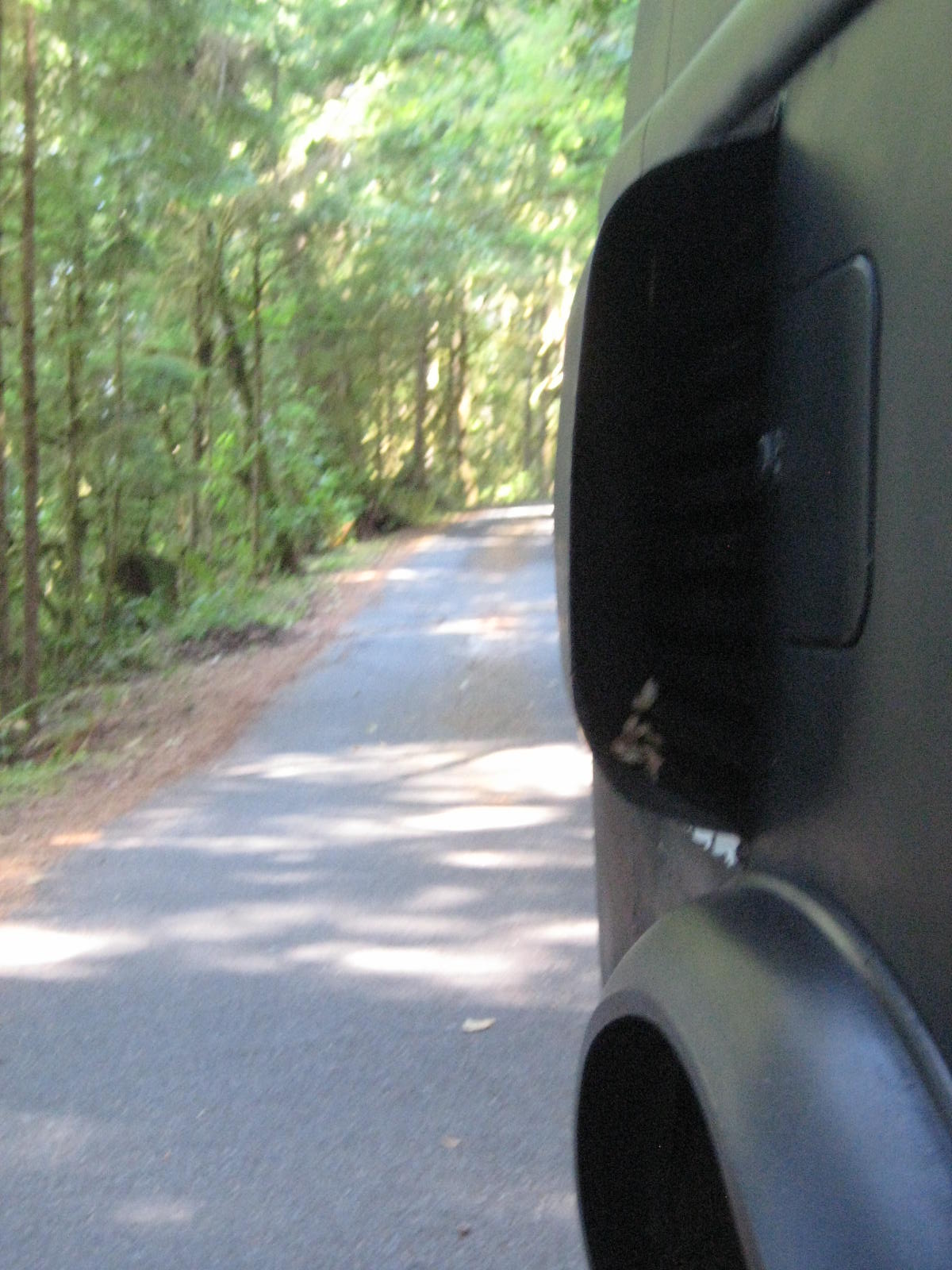

Just got a bus with them and hacked rear arches and an external oil cooler . I am going to rock them and am open to some 70s style glass flares as well. I would never do this to a bus without them but they stay for now.

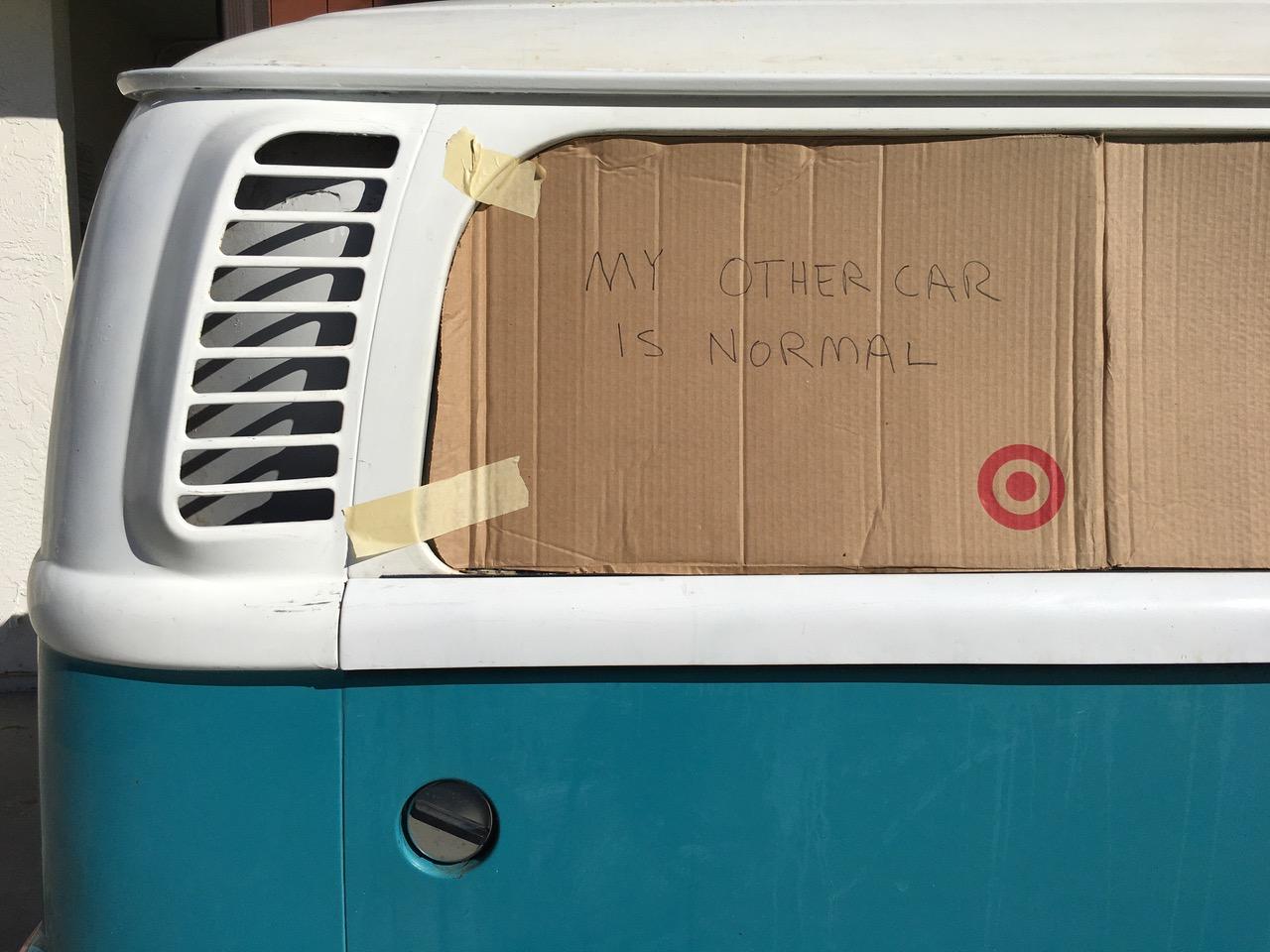

as the bus engines got bigger, they made OG scoops.

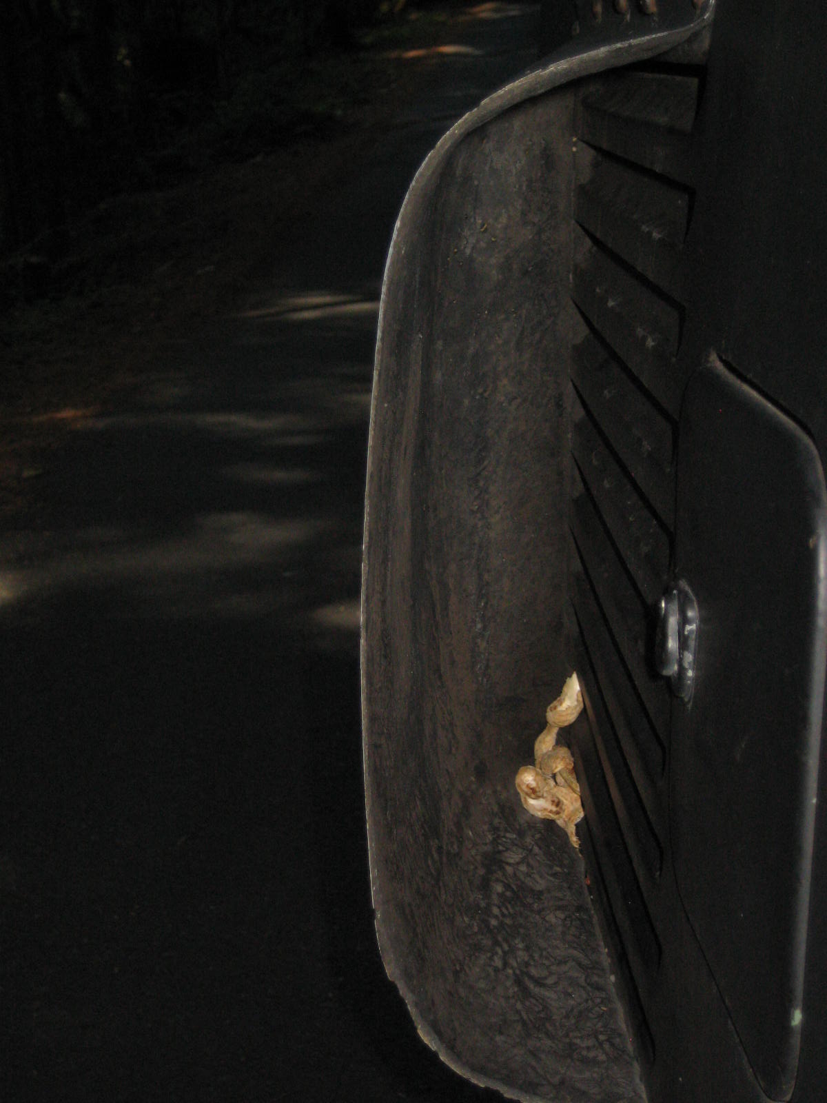

I can’t remember who posted a thread on this… it was like a decade ago on here. I want to say it was Clara or Amskeptic. But I can’t remember. They actually did road tests with cardboard “scoops” and without using a CHT. I’m way too lazy to search for it.
I do remember that they significantly lowered engine temps.
The con is they look lame and put holes in the bus in a noticeable area when the next owner wants to rip them off.

Yes, it was with actual real plastic scoops, and using a thermocoupler on the head. and various other sensors.
It dropped the temp in the engine compartment to match the outside air temp, and dropped the head temps by the same amount. ( w/o scoops the air temp in engine compartment is warmer than outside)
https://www.thesamba.com/vw/forum/viewtopic.php?p=900179&highlight=#900179
so yes they work, but they are ugly. if your engine is actually overheating, first install all the missing tin.
