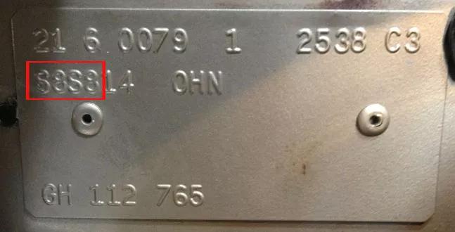

Where to find your T3/T25's paint code
On the build sheet sticker below the fuse panel:
No sticker? Look for the PKN plate under the driver's seat and locate the four-digit sales code:
Find the sales code(s) in the master color list below in this post. Note: A repeated sales code (ex. S8S8) indicates a single paint color; two different sales codes (ex. P6J5) indicates a two-tone paint scheme.

It turns ou the the plate riveted to the body under the seat has the SALES code for paints!
For example, here in my plate under the LF seat...
It turns out the S8 is the sales code for LH1V! (H1V, the L designates Lacquer)
A screen shot to show what I mean......

I was "wasting" even more time online and discovered this scan of a sales brochure on the brick-yard site. It clearly shows that my S8S8 is a one color Savannah beige Metallic.
When the numbers differ such as examples on this screen shot, B5P6 for example, are painted a two tone.
I suspect that the other information on this plate tells me my interior, engine, transmission and options installed but I haven't yet located any information to decode the tag! Sad

The stamped plate is called a PKN.
Google PKN decode and you can get the planned manufacture date from it.
