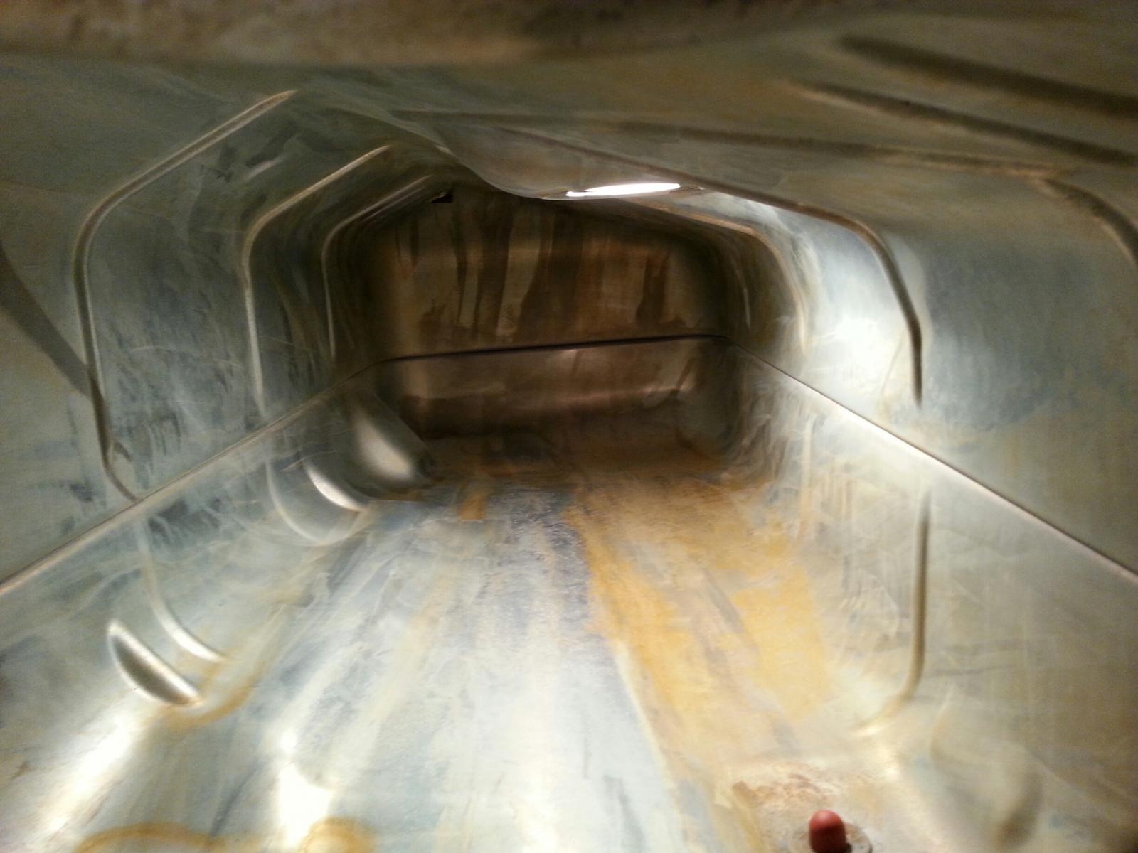

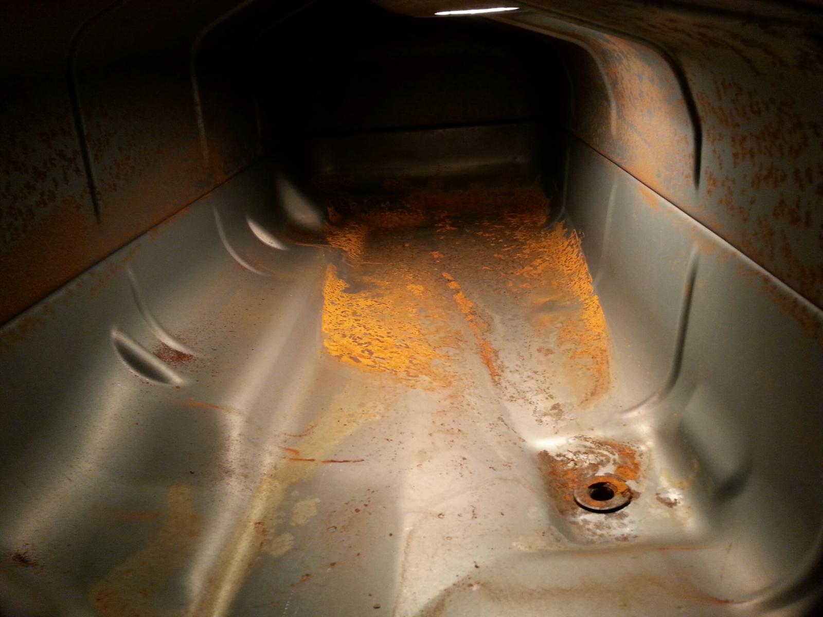

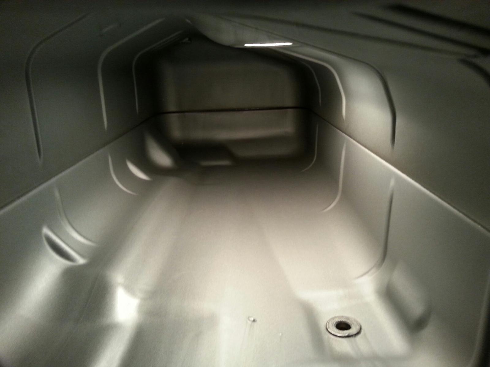

My late 73 Westy is scheduled to have a fuel tank installed tomorrow and I have two tanks that I am having trouble deciding between. The first is a used tank from a 74 bus that I bought here that is in great shape with a very small amount of rust and the second is the original tank that has been treated with a Por-15 tank sealing kit. Sealing the tank didn't go as I expected (full story below) so now I am having trouble deciding which one to put in.
Untreated 1974 tank:
Por-15 sealed original 1973 tank:
I'm leaning toward using the Por-15 coated tank, but I can't decide. Help.

Full Story
I've had problems with rust in my tank for over a year and putting an in-line filter between the tank and pump didn't help. It is time to have the tank replaced and I am having a garage do it for me. I understood they didn't want to have my bus apart in their shop while I repaired the tank so I bought a used 1974 tank and a Por-15 tank sealer kit (after reading Richard Atwell's tutorial and several reviews on line).
The guys at the garage questioned the Por-15 sealer so I did some more research on here and found very mixed reviews of the product. Since the used tank I got was in such good shape I decided to use it without sealing it.
Then the garage removed the original tank from my bus and pushed it out into their yard. Now I had a rusty tank I could try the Por-15 tank sealer kit on without risk since I could always fall back on the used 1974 tank.
I assumed most of the failures of the Por-15 sealer were either due to people not following the directions or possibly that their tanks were not rusty enough and had some kind of original factory coating that caused adhesion problems. So, in addition to following the kit directions as closely as possible, I added an additional step of tumbling it many times with a bucket of ~3/4" pebbles and either dish soap or TSP in it. I have read of other people using chain or nuts and bolts, but I didn't have enough of that sort of thing and thought rocks were fairly inert and would act like coarse sandpaper and knock off all the loose rust and scratch up any pristine surfaces for better adhesion. I actually rigged up a way to strap the tank to a cement mixer and let it tumble with the pebbles and soap for hours. When I was done I rinsed it out many times, both with a hose and with hot water and it was very clean wen I was done. If you have read Richard Atwell's tank restoration tutorial (http://www.ratwell.com/technical/FuelTankRestoration.html), my tank was way cleaner to start with, basically only having rust and none of the sludge and goo. Here is a before photo:
Preparing the tank for sealing was a 3-4 day process for me because I wanted it done as well as possible. When I was ready to use the sealer the tank looked like this:
Everything seemed to be going well until late Friday night when I opened the can. The instructions said to stir it until it was a consistent color and I remember from Richard Atwell's tutorial that you aren't supposed to stir it very much. I was surprised to find that about a quarter of the can was semi-solid sludge and that no amount of stirring would make it a consistent color.
With the 4 day drying time, waiting to contact tech support on Monday would mean it would be at least another week until the tank would be ready so I decided to stir until the lumps were dissolved and proceed.
After pouring the sealer into the tank I found that there were still some small lumps remaining in the bottom of the can. It was too late to turn back at this point so I finished sealing the tank and left it to drain.
When I was done there were a couple of things that bothered me.
1. There were lumps, streaks, and even a few small bubbles around the tank outlet.
2. 80-90% of the sealer drained out of the tank, which must leave a very thin coating.
So now I wonder if something went wrong or if I had a bad batch of sealer. I have a huge amount of time and money invested in this tank now, but having a garage remove and install the tank is an expensive job.
If sealing the tank went well it would be the obvious choice, but if it fails like I have read some do, with sheets of sealer coming off and blocking the tank outlet, then I am looking at a costly or time consuming tank replacement.
If I use the slightly rusty tank and am careful to keep it full and use fuel conditioner I may never have trouble with it, but then again I could forget a few times and run into this problem again in a few years.

Your POR15 experience and mine are almost identical. I was surprised to pour a quart of POR15 into the tank and drained over a pint back out again. I have the same streaks and thick spots too. For fun I poured some of the POR15 into the bottom of a 5 gallon plastic paint bucket (which was not cleaned prior) and let it dry. I've hit the dried POR15 with a hammer and can't make dent. This bucket will never leak. Have not yet installed the tank but feel good about things. I realized that the inside of the tank does not need to be pretty it just has to be sealed...also out of sight out of mind.

PostPosted: Wed Oct 23, 2013 9:52 pm    Post subject: Reply with quote
Your POR15 application looks fine. Roll with that!

If you used all the marine clean then the metal prep in the amounts in the instructions and it was pouring out clean you were good there. you are only putting on a coat of paint inside so most does pour out again. A lot of guys have another project sitting there that they can brush it onto and not waste it.

Yes, I actually pre-cleaned it so the Por-15 cleaner came out clean the first time, but I did it twice and kept it in there for almost 24 hours anyway. I'm pretty sure I did all the prep work correctly. I'm just worried I got a bad batch of the tank sealer.
I just dropped both tanks off at the garage that is doing the work for me and let them decide which one to use. I assume they will also decide on the Por-15 coated one, but it will be interesting to see which one they pick.

I also sent an e-mail describing my experience and with photos to the distributor, who forwarded it to the manufacturer.
I just got a reply saying it would be fine and the streaks and lumps would not be an issue. I phoned the garage and they will be putting the coated tank in this morning. I will try to remember to update this thread in the future if I have any issues with it.

I'm curious why you just can't use an etching primer and paint, epoxy or urethane. Por15 seems to be too problem prone. Great for battery tray, but fuel immersion with the possibility of water?

I agree with Ray that there are too many variables to simply blame the POR15.
IMHO, obx's tank looked way too clean for a POR15 application. If mine looked like that after cleaning, I would not have put anything in there except for a full tank of gas.
A primer...even a self etching primer....is porous by nature. High surface area. Thats how it works.
Unfortunately....self etching primer would eventually be dissolved by fuel.
the problem with any coating is that you could NEVER be sure that there are no small pinholes. Especially inside of a gas tank you have no way of making sure your coating is perfect.
In fact...it will likely never be perfect. Fuel would exploit any pinhole or pore...and start disolving your primer. In that condition...the coating is only stuck to the primer. You could surmise the evntual end. itwill keep eating and start coming off in sheets.
The things about phosphoric acid primer is that its not a coating. Its a surface reduction process that creates an oxide that is bonded at an ionic level. Apinhole in the epoxy coating....will simply come up against a primer that in itself is rust preventive as long as its kept out of oxygen. keep it under fuel and it will not rust.
Ray
I agree with that. In fact...Im debating on whether to coat my current tank at all.

Thanks Ray. Your information backs up my choice not to coat the first tank. I thought it wasn't rusty enough for the Por-15 sealer, which I understood bonds better to rust.
I wish I had read about treating with phosphoric acid multiple times to convert the flash rust from the previous treatment. That makes a lot of sense. Looking at the photo of my tank after phosphoric acid treatment, I am a little concerned that I don't see much flash rust and no black/blueish converted rust.
The coated tank is back in the bus now so time will tell if it worked or not. I will try to remember to update this post if it fails. I will also keep the second tank around for a year or two until I am sure it worked.
