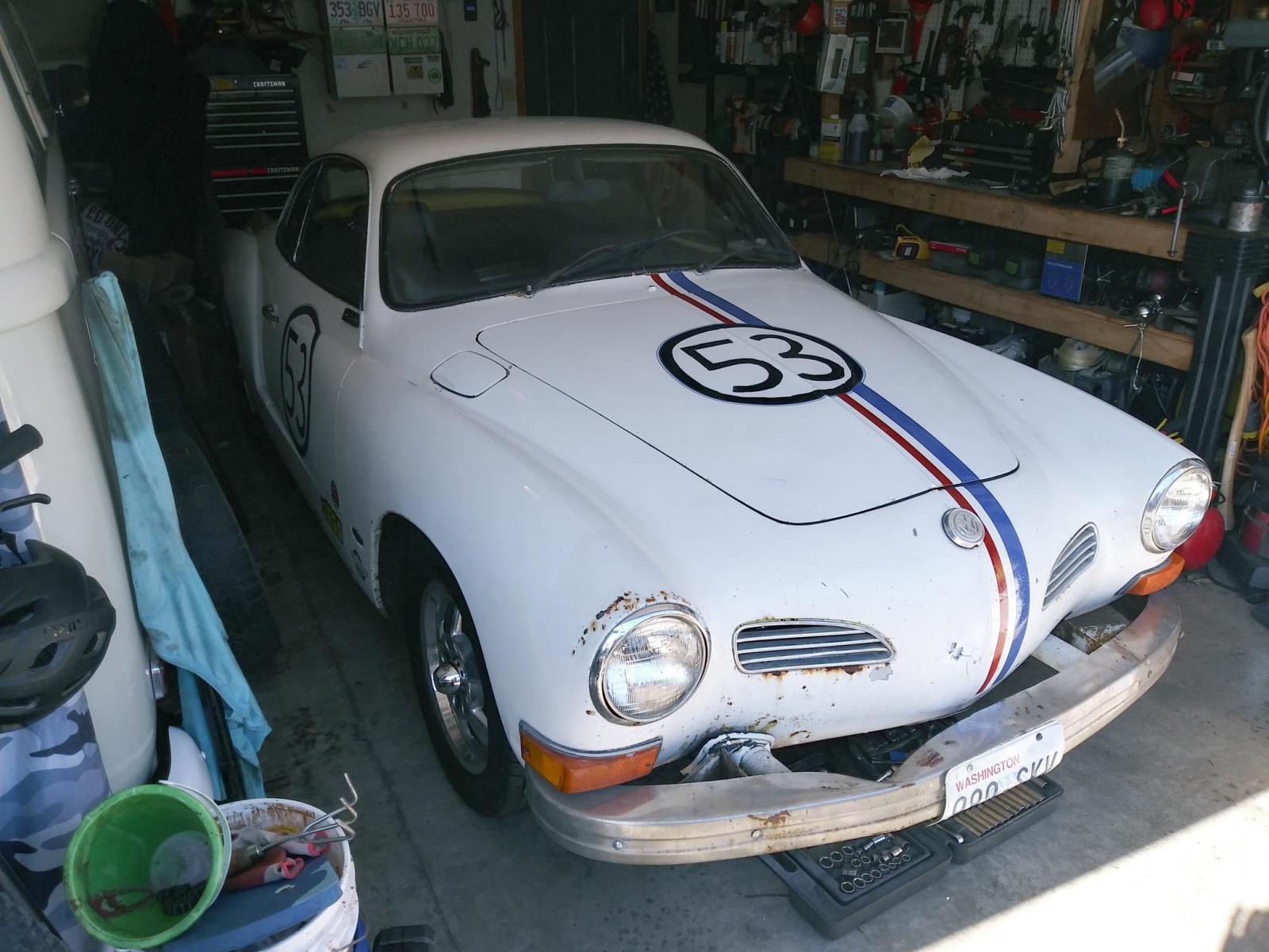

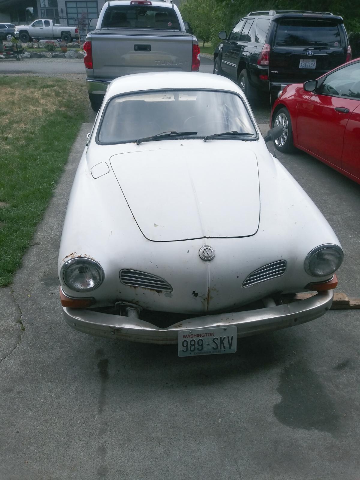

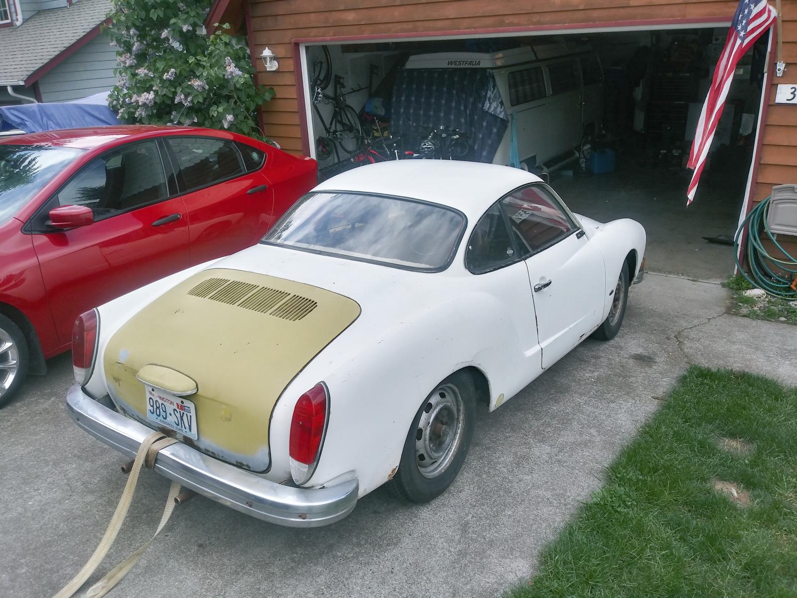

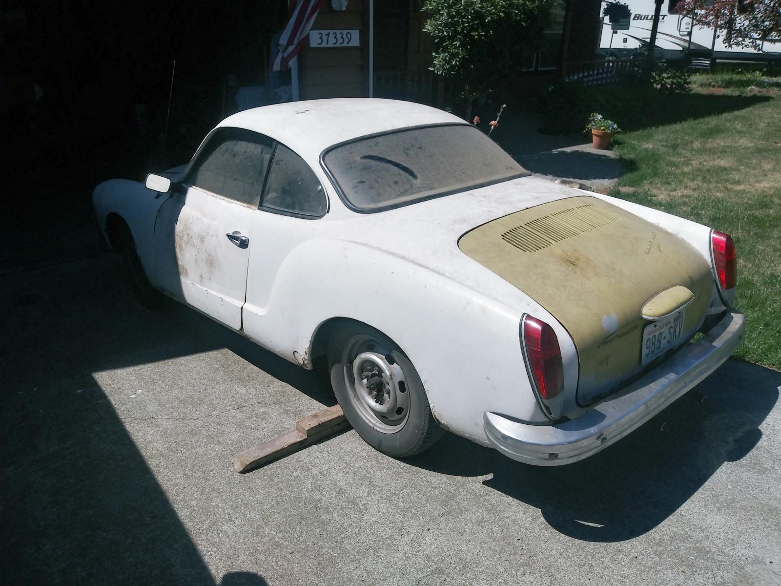

Hello there fellow Sambanistas! I'm starting this thread to document the restoration of my 1974 KG with the eventual goal to make it look like a Ghia Sport model (yes, I know they were 1973-only). This is my 20th air cooled VW and my third Karmann Ghia. If you see the links to my other projects you will see that I don't mess around and take a long time to finish a project. My goal is to have this car ready for paint by Spring 2023.
The backstory: I got this car for free in May 2021. The 2nd owner needed it moved out of the garage of his second home so he could sell the house. He was told that the car wasn't worth anything. I saw the ad on CL for $45 and thought surely he meant $4500. But no, he just wanted the title transfer paid. Luckily I was the first to call him and flat towed the car home the next day. It was in pretty rough shape and one good thing about having Covid was my loss of smell because the interior reeked (so I was told) and it was probably from the 10lb mouse nest I found in the headliner!
After getting the car home I started evaluating it and put a battery in it and poured a little gas down the carb and it fired right up. I was amazed. Before going much further I decided I'd better do an oil change. It was then that I discovered that the oil pickup tube had come loose inside the engine. I would have to split the case to press it back in it's hole. I decided at that point to pull and preserve the original engine and build a new one. After doing some research I decided to build a spicy little 1967cc engine (74X92). I got all new parts including a C/W crank, Porsche-length rods, 041 big valve heads, and a Scat C35 cam. At first I had dual 34mm baby Webers but it wasn't enough so I switched to 40mm HPMX carbs. I am running an MSD clone dizzy with a 40K volt coil and a Crane Cams ignition box. Needless to say, it rips!
I decided to drive it as-is through the spring and summer and do the exterior resotration this winter. Knowing that, I had a little fun with a Herbie based paint scheme. I switched the numbers to '74' shortly after putting the 53 on there. Here's some pictures.
First ones after towing it home:

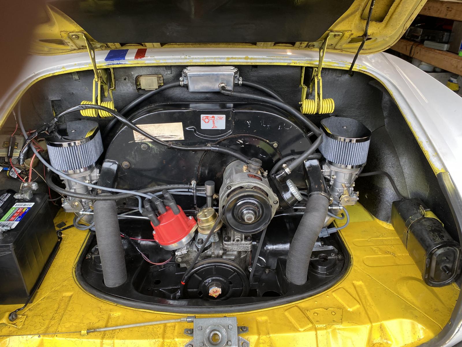

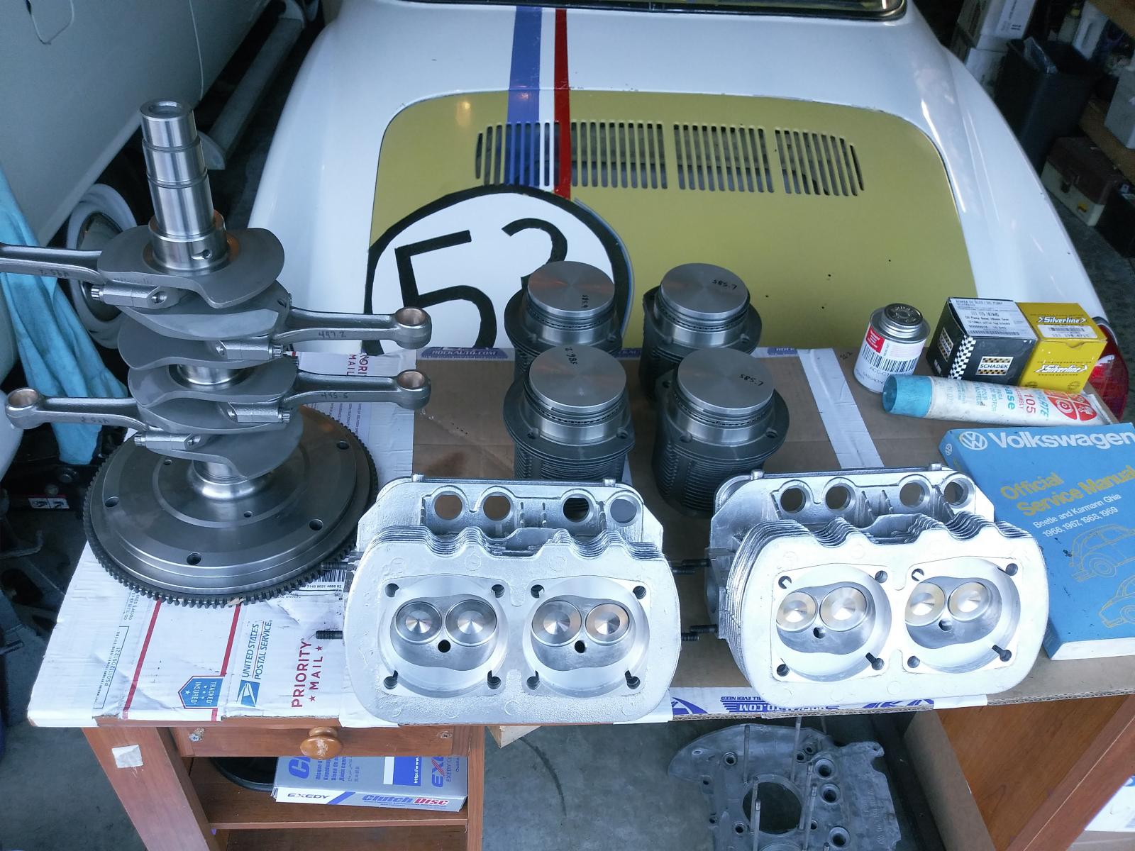

Engine parts:
Engine in the car:
Before the resto started:

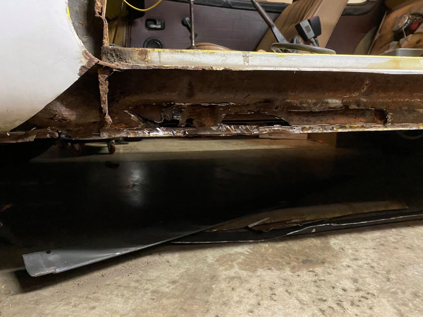

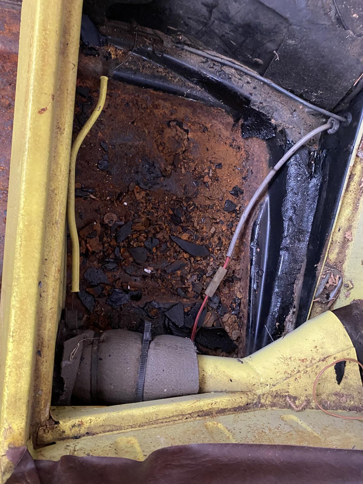

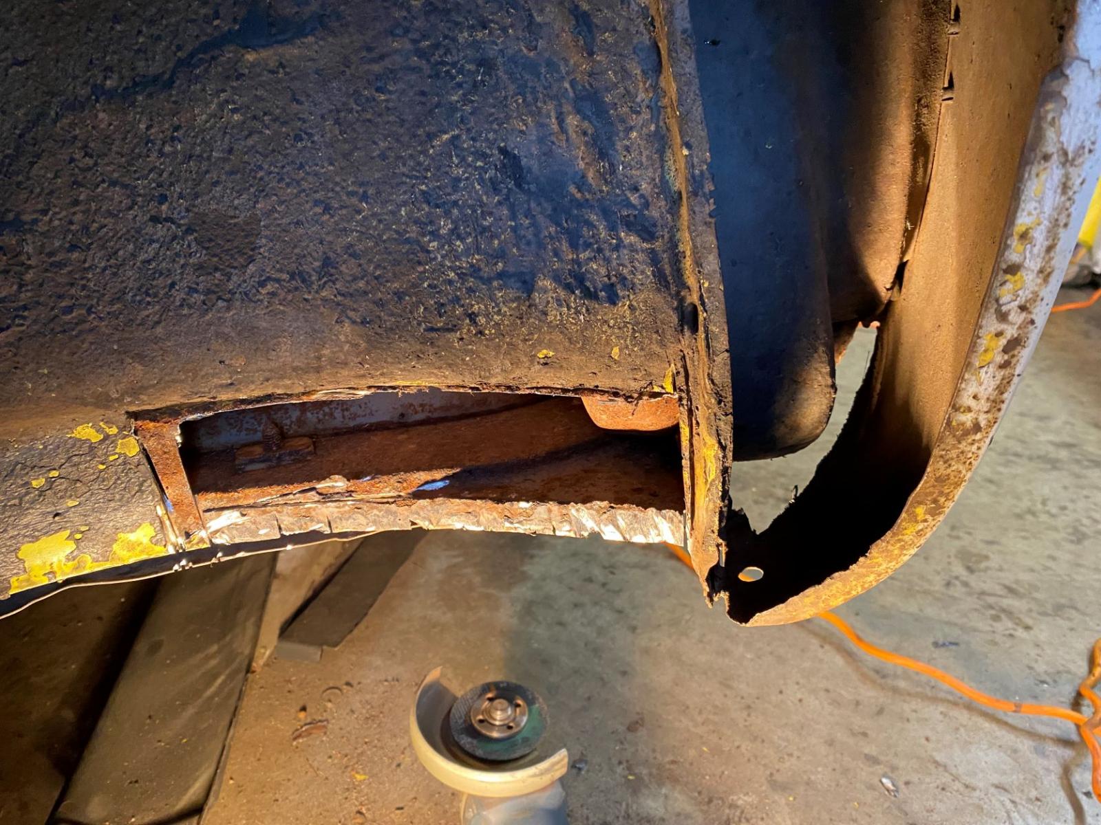

Starting on the resto, both pans need work. the passenger side was better and only needed 1/4 pans for the rear.
The drivers side is a little worse but in my opinion only needs a rear 1/4 section and some patching in a few other areas.
The outer rockers are shot but inside looks solid.

I’d pull the body if you have space and do the entire pans. The repair sections are terrible and it’s hard to get a seamless repair. With the body off you might find that the inside and underside of the rockers are also roached.
That’s a dang nice car for $45!
Ideally I would pull the body off the pan but I don't have the time, budget, or space to do it. Also, the rust really isn't that bad. The drivers side is the worst and after cutting the outer rocker skin the inner structure is not that bad.
The pans are pretty much done. I have a few more patches to make and then they will get a coat of POR 15 and be ready for another 50 years.

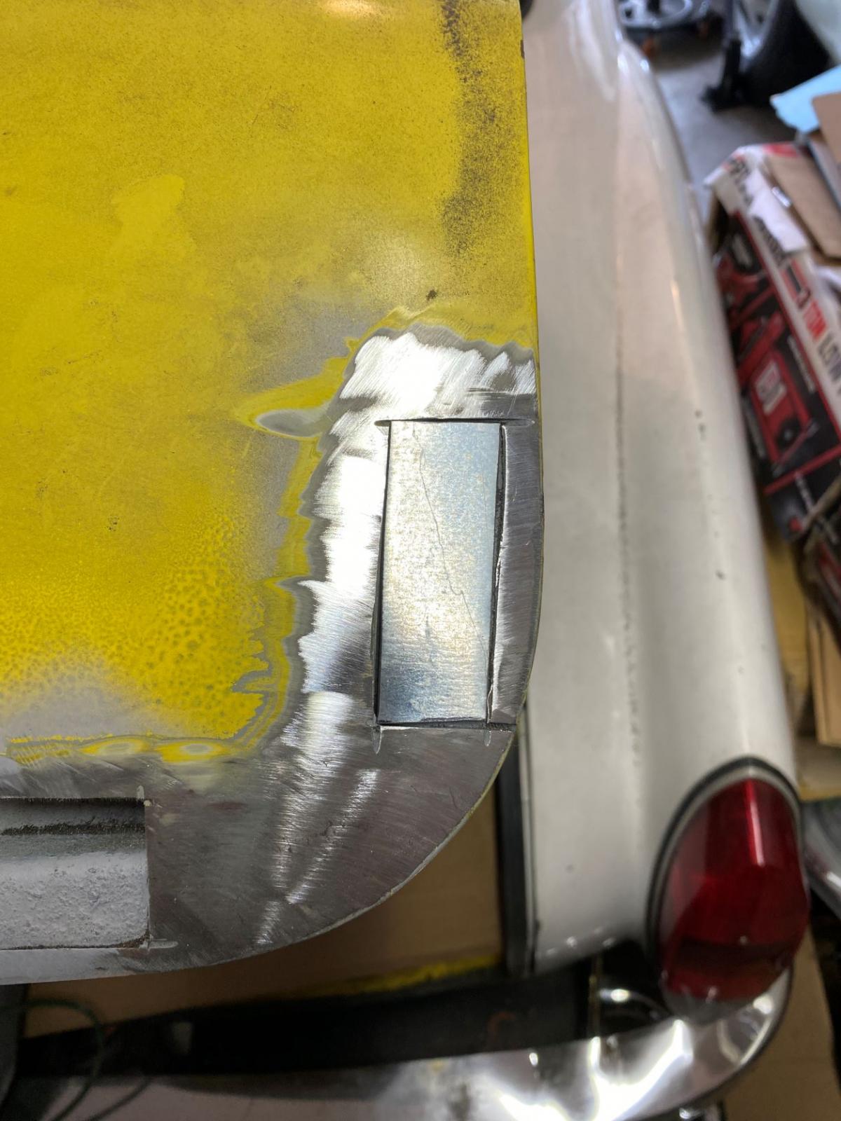

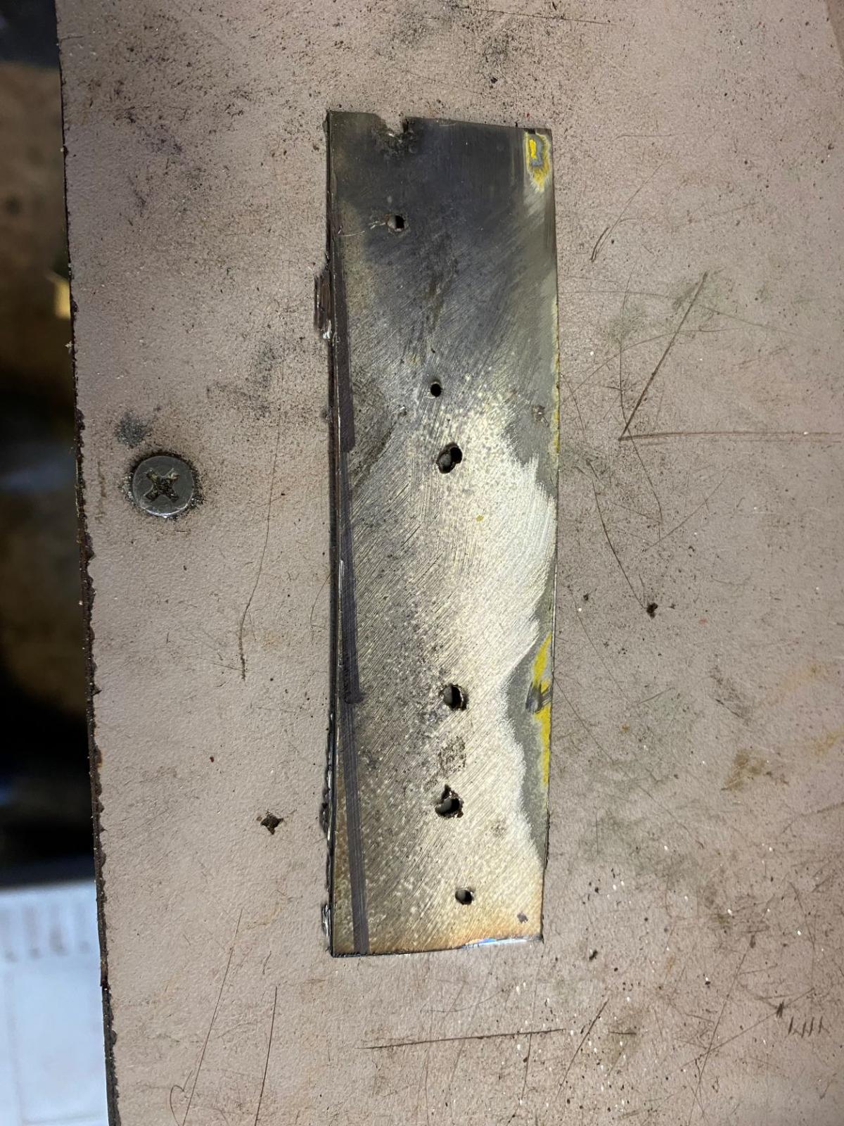

Small update for today. Decided the drivers front floor pan is too far gone so I will be ordering up a new section.

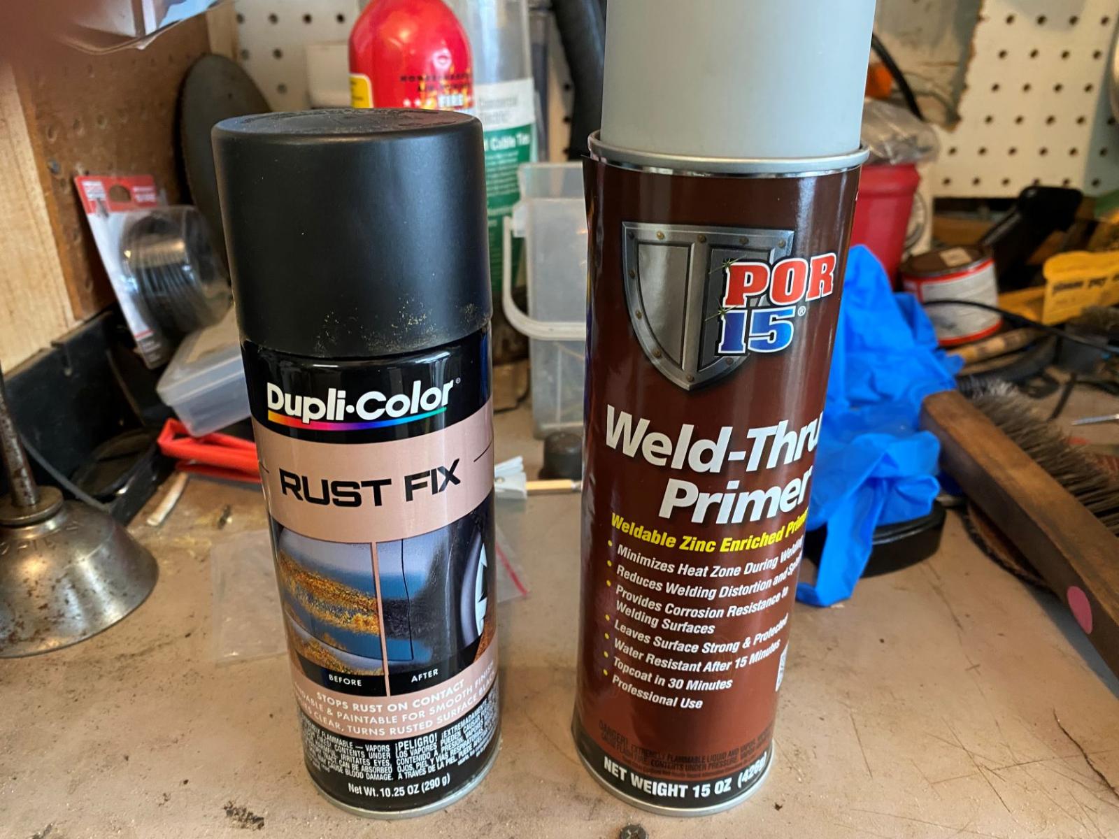

Started working on the decklid. My plan is to rust treat the area there and then make a patch panel out of galvanized steel so this won't happen again anytime soon.

Welding galvanized metal is very toxic. Probably best to just use steel, coat the inside if lasting for 50 years isnt enough. Good Luck.
Thanks, I have welded galvanized steel before and as long as I grind away the galvanizing on the area I'm welding it should be fine.

A little more progress today (I try to do a little something every day). I am using a few new products this go around and so far I like them. The weld through primer is pretty expensive but to have the peace of mind that there is something behind the repair panels is worth it. The other product wasn't too expensive and it's a rust converter by Dupli Color. So far I like it, it comes out clear and dries like spray paint and leaves the metal a black color.
Here's a before and after spraying on the rust converter.
Ever wonder what it looks like behind the small pin holes of rust one finds on the outside of the car? I started poking at these "small" pin holes and my pick easily went through them. I decided it would be best to cut that area out.
Here is the weld through primer. I also sprayed the back of the repair panels before welding them on. Didn't seem to slow my welder down at all.
I try to be patient with these repairs and jump from one side to the other on the repairs to keep the heat from warping the panel.
Mostly done, just have a little more grinding and hunting down the little pin holes that need some filling with weld after grinding them down.
A few more patches to make and the decklid will be done. Moving on to the drivers side rocker area soon.

More progress today. Finished the decklid welds and ground down as best as I could. This area is going to need a skim coat of filler to be sure but it's better than it was!
Had to fill a few pin holes after grinding.
After final grinding.
My drivers side inner wheel well had a nasty spot of rust. One theory I have for why my drivers side is so much worse than the passenger side is that this car was in an accident at some point and the nose/ drivers side fender was replaced. The repair work was not that great as there is heavy bondo on the area and the fresh air vent box is pretty mangled where it meets the nose. Whoever did the repair also didn't replace the fender liner and that allowed dirt, water and other debris to get into the drivers side rocker.
Any advice on how to proceed with repairing this?
The inner wheel well patch was pretty straight forward. I made an inner and outer patch from galvanized steel and I primed the inside and back of the repair panels before welding them in. This patch isn't pretty but it doesn't have to be because it will get some sealer and some undercoating sprayed on so it will never be seen.

Good to go ahead in saving this ghia!
Concerning pour welding, I think the penetration is way too low, you have to move the power up on the welder. Your last 2 pictures shows it well, some wire "glued" on top of the surface and stay high but not penetrating..maybe take some time, and put 2 pieces of metal on your workbench and try several settings until it looks good from both sides. Then you can go to the car 😉
Bests
Bests
Antoine
Antoine, thanks for the tips unfortunately I don't have a fancy welder and it has minimal settings. If I turn the heat up one more notch it will blow through the thin sheet metal. Luckily I have lots of grinding disks!
