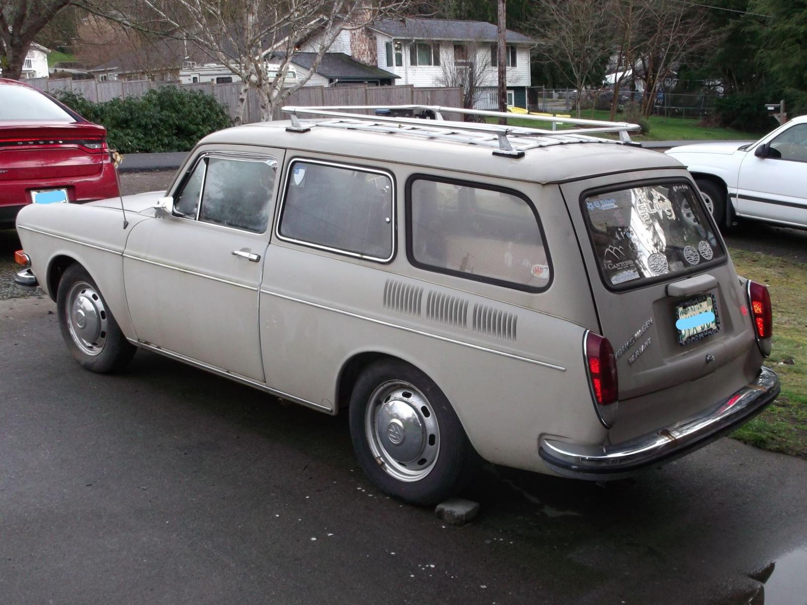

This is my new project. I have owned/ restored 18 air cooled VW's over the years but I have never owned a VW Type III (Squareback). The previous owner took great care of this car but she still needs quite a bit of work. I will document the work along the way. For now I just want to get it cleaned up, see if I can get the paint to shine again and get it running. First order of business though will be to get the drivers seat rail repaired. For those of you in the Pacific Northwest you may recognize this car from a fellow Samba member. My plan is to bring it back as a well-preserved stock car and replace as little of the original metal as possible. These pictures are as she sits right now, fresh out of a long hibernation. It is currently not running because of old gas and possibly a bad or stuck fuel pump. It is still fuel injected and I plan to keep it that way. Stay tuned...

Tram, Bob, you are both correct. It is Annie's old car. She just didn't have the time to put into Savanna that it needs. I promised her I would take good care of it. We don't live far from each other so I'm sure she will hold me to my word!As you both probably already know, it's in pretty good shape. I will post some pictures soon of the areas that need some attention.

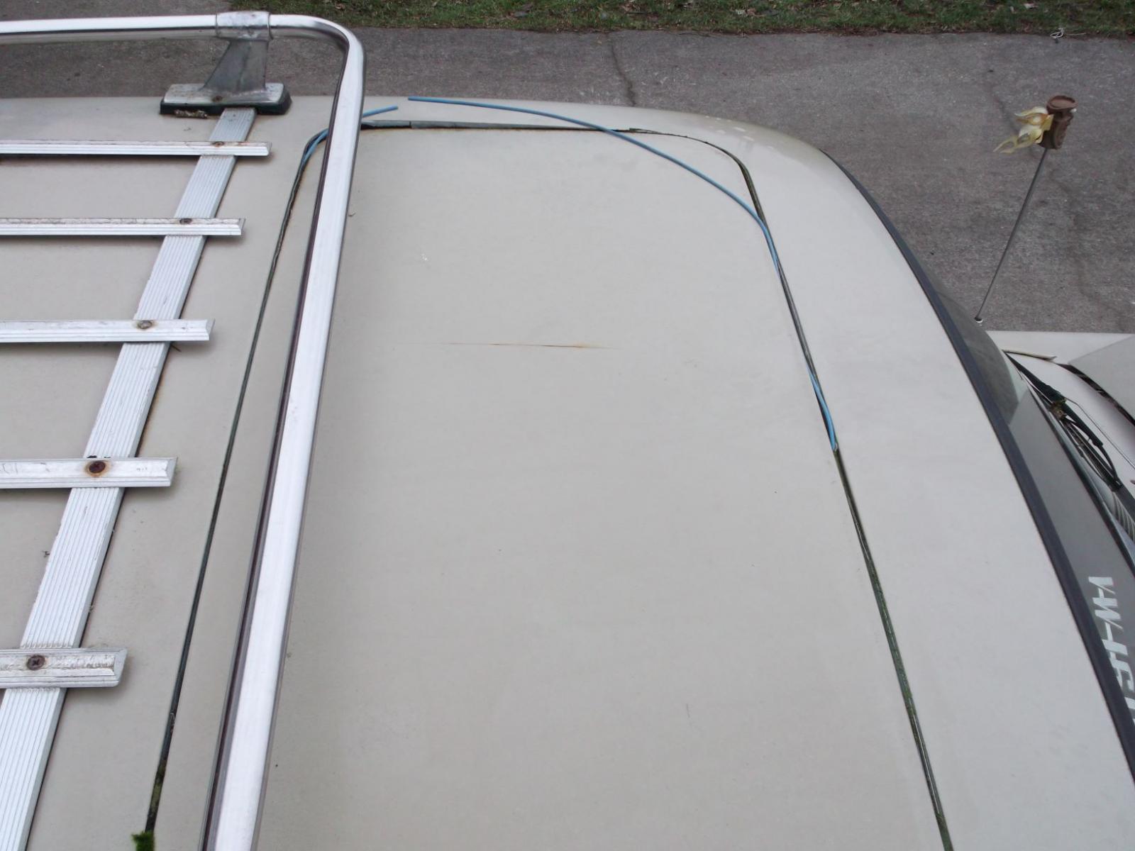

She needs plenty. See the pictures below. Annie told me a local guy named Damon painted it. It has survived pretty well but I will be doing some painting to repair the rusted areas.
Annie still has her bus but once the seat track broke on this car she parked it for safety reasons and never got back to it. I was as shocked as you guys when I saw it up for sale. I didn't waste any time going to get it!

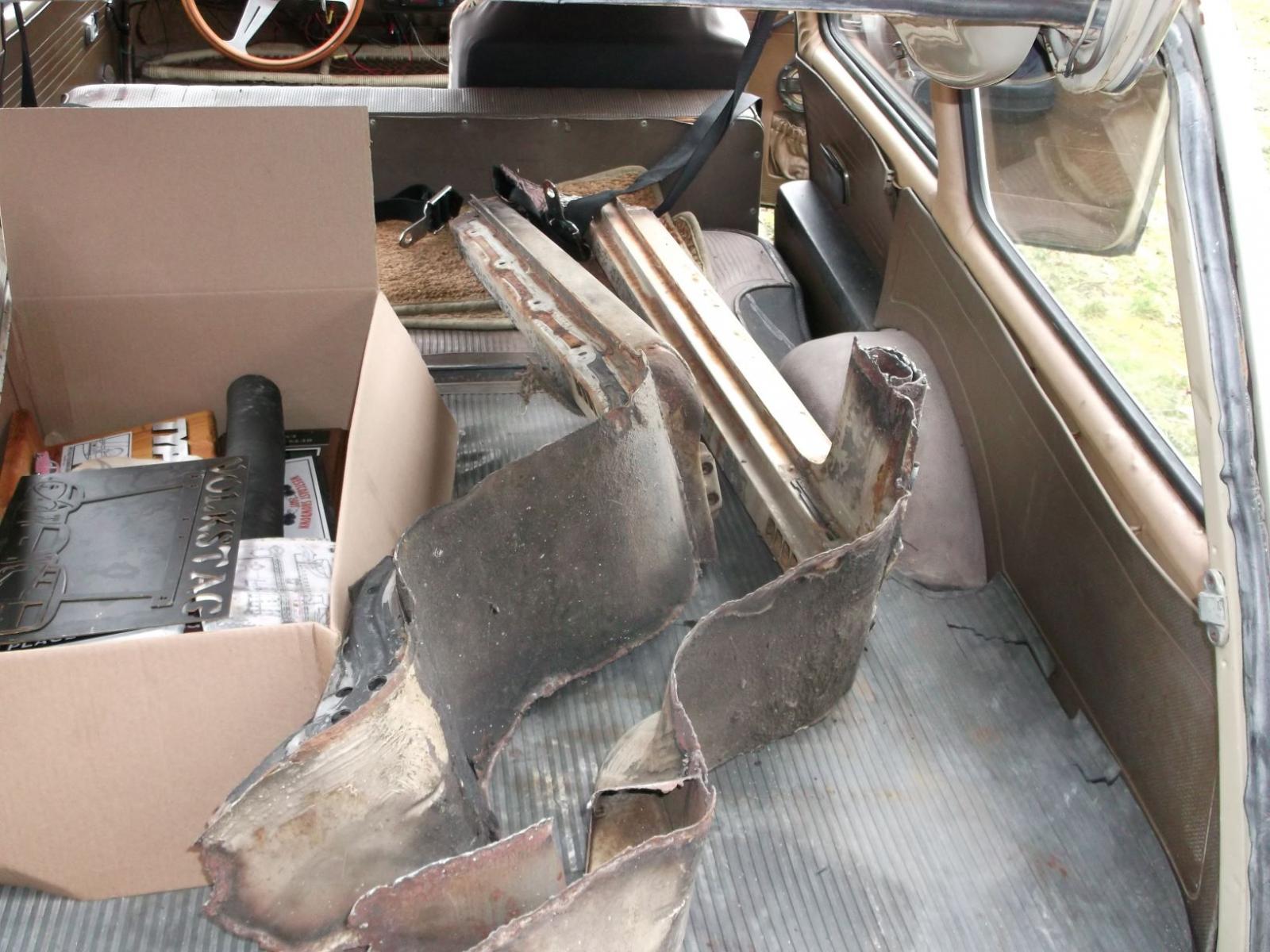

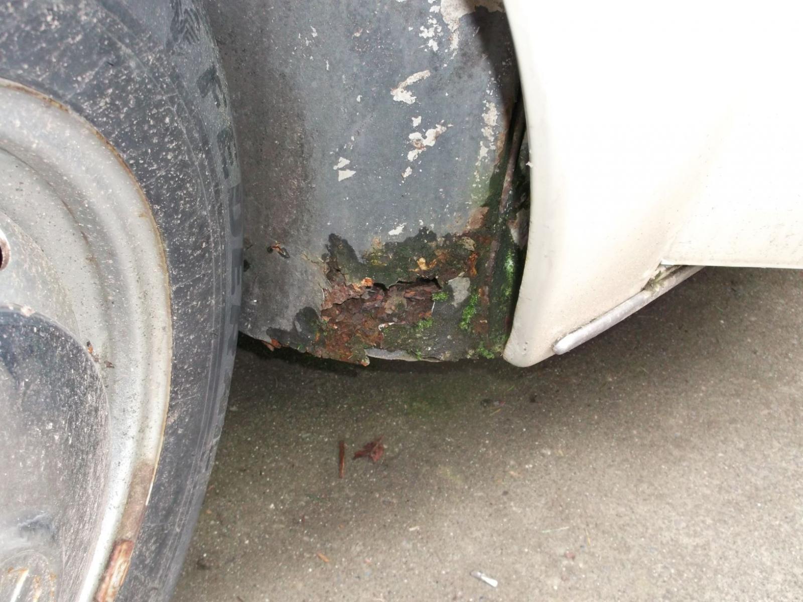

Here are the areas that need the most work. The heater channels (plus the exterior rockers) and the trunk area are the worst. I think I can save the drivers side pan since it is mostly surface rust.
The sunroof needs some adjustment and a new seal.
The trunk is pretty bad. Never, ever let your brake fluid leak and stay on the paint. This is what will happen. Do they make a repair panel for this or do I need to find a donor car?
Spare tire area isn't too bad but the bumper mounts are both rusted out.
Luckily Annie supplied me with both heater channels complete with good rockers.

Here is some more rust to show the extent of how bad the heater channels are. Drivers side. Luckily the passenger side isn't nearly as bad.
The good news is that Annie provided me with two complete heater channel sections to repair all the rusty areas.

I told you I thought I had early model metal that looks just like late model metal minus the safety crush box on the outside of the inner fender.
Early metal would look better than anything you're likely to fab from scratch.
If you are that worried about having the goofy crush box you could fab it onto early metal. Twisted Evil

Bob, yes. At least I have those parts to fix the complicated heater channels. I have heard back from both Mike Fisher and Joel and neither of them have the parts to fix the rust in the trunk. I guess I will be fabricating those parts.
We haven't gotten it to run yet. The fuel pump is acting up and we got it running but it isn't pumping. We will continue to mess with that when time allows.
For a pump, you can use the Airtex E2000, or the precision brand E16020 from O'Reilly's. These pumps are replacements for an 86-89 Ford ranger frame mounted pump. There are quite a few of us running this pump without issues. My wife's 70 Fastback has been running 1 since 2008.

Mike, guess I misunderstood. I'm new to these type III's. So the early metal will work and look like the passenger side? I'm likely to just fab up some repair panels anyway because, 1) I'm cheap and 2) the repaired area will be covered by a trunk liner.
