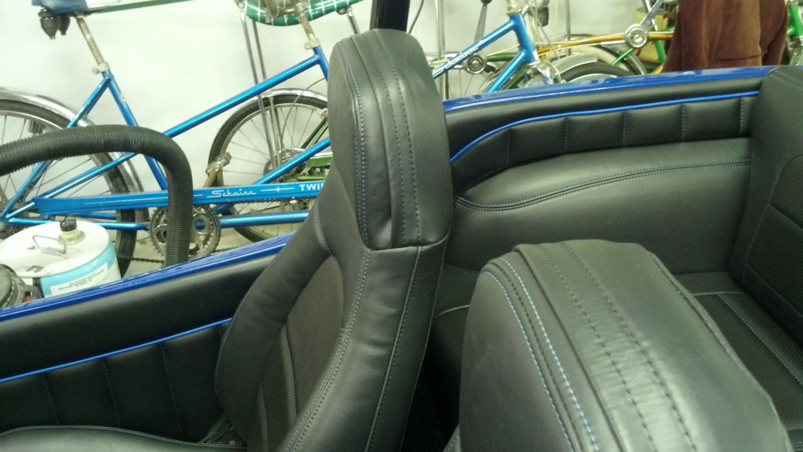

I just switched over to Mazda Miata high backs... best move I've made for our buggy. Small, deep side bolsters, good support comfort, decent look.

I'm with VOLKSWAGENNUT. I put Miata seats in my buggy this year and I've been really happy with them. Any you can't beat the price. I got a really nice set off of Craigslist for $200, including the adjustable mounts.
-Rick
-Rick
Agreed, I got a pair of Miata seats for $150 and had the reupholstered. Speakers in headrest. Of course, it is more street buggy than offroad. Very comfortable seats!
