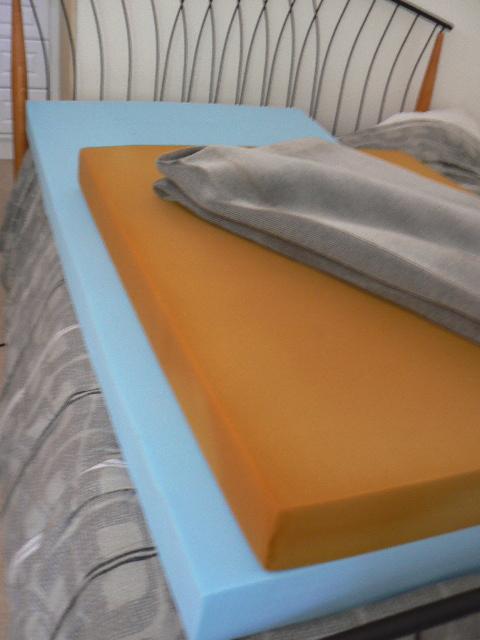

I mentioned I was going to try just doing the back cushion. Here is what I got for $79.99 and free shipping from foambymail.com I'll have to cut it, but I can use the leftovers.
This is the LUX-HQ foam with an ILD (hardness) rating of 50. I was on the fence between this is and the HD36-HQ which has a 35 rating. They are both high quality foams that should last a long time.
This 50 rated stuff is a little bit softer than the Westy stock foam. You can feel it if you go back and forth. You sink in just a bit with this vs. the Westy your kinda just lay on top of it.
If anyone is wondering what softness to get, I would say 50 is good if you didn't think the Westy foam was all that hard. It will be somewhat softer, but not enough that if you liked the Westy foam, you would mind. The HD36 is noticeably softer and I think most people that want softer foam would think this is about right being used as both a mattress and a seat cushion. As a seat cushion, it would not have the furniture like feel of the Westy foam. I think it would work fine but you would notice the difference as your butt would sink in more. Comparing to memory foam, both the 36 and the 50 would seem firm, but memory foam would not work as a seat foam. So if you are thinking memory foam softness is what you want, the 35 rated poly foam may not be soft enough. If that is what you are after, I think a separate topper is your best bet because super soft foam isn't going to work as a bench seat any better than the memory foam would.
I guess I got the 50 over the 35 because I didn't want to feel a huge difference with my upper half laying on the rear cushion and my legs on the seats. I'll have to camp with it a while and see.
http://www.foambymail.com/foam-types-for-seats-and-cushions.html
I've also tried some 39 rated stuff from a local place. I liked that too. I don't recall any difference from how that felt compared to the 35 but it would have been 10% firmer based on the rating. Anyway, a range of 35-50 is what I think most people would want who are redong westy cushions. HTH.

Have you slept on your new foam pads? What do you think about them? Would you get thicker/firmer or vice versa next time? I need to replace my foam in the back and figuring out my options.

I have a blue one and a HQ LUX 36 and I am using the blue (stiffer one). I like that it is pretty close to the stiffness of the bench seat. After sleeping on it, I got more used to the firmness but I usually put a thermarest pad down.
I think a well crafted topper like this is the cats meow. This one is 1.5" and a stiffness of about 36. 1.5" is nice if you have a rear cabinet bacause you can still access it with it folded over. But you could do 2" and that work well too. Foambymail only sells in full 1" increments.
This cover is made out of sueded cotton blend that FoambyMail sells. It folds in the middle and this is 46x36 sections with zippers on each end. I forget how much it cost, but you would need to get the measurements for yours and just call them. It seemed about what you would pay a local seamstress but they cut the foam and put it all together and shrink wrap it and ship it for free. That fabric is really nice. http://www.foambymail.com/AllColors.html
Hope that helps.
