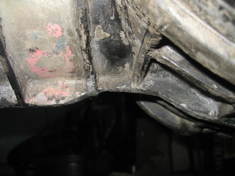

This is how much I had to clearance my gearbox to fit my 52
