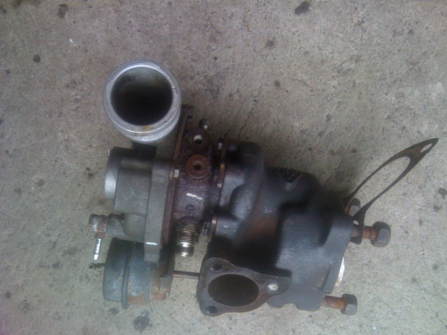

I think most of us with the 1.8t know about this issue.
The 3 bolts that connect the exhaust manifold to the turbo....man, I just can't keep them torqued up.
I believe factory spec is 24 or 26 pounds, I've also tried all the way up to 36#, and they always loosen, especially, it seems, the bolt closest to the exhaust mani.
So I was thinking about this, is there any reason NOT to try studs in there?
I know on mine (AEB motor) the exhaust manifold nuts all would have to be loosened to get the turbo on or off, since the mount hardware underneath the turbo doesn't give enough room with studs in place.
Other than that initial small hassle, is there any reason I'm not aware of that would make this a bad idea?
I was even thinking of double-nutting them. Wink

These bolts can be a real bitch. I have found that if the car has been driven much with them loose it makes the threaded holes in the turbo wear oblong and then the bolts will never stay tight again.

Sodo, these are bolts that hold the turbo to the exhaust manifold that are the problem here.
VW does offer bolts or studs and nuts for this application, the stud will do a better job holding it in place but I resist using them because it makes thing much much easier to disassemble when there is bolts in this case.
As Butcher has mentioned, these are something that should be replaced each time and a bit of loctite like Abscate has mentioned is a good idea too. That piece offered by Urotuning that Metropoj linked could help, I was not aware this was available.
In Levi's case, it sounds like it has run with them loose a few times and now he's got a couple broken bolts in the turbo ( These can usually be gotten out with a lot of labor, it sounds like a new turbo would be the better solution at this time.

PostPosted: Thu Nov 01, 2018 4:47 pm    Post subject: Re: The dreaded 1.8t turbo bolts Reply with quote
Andrew-
Hey that's my turbo right there!
Ha ha but with 2 broken bolts!
Hey Andrew what's up?
Very awesome of you as usual, your offers, Thank You, I may take you up on that, but first I see an opportunity to try different things.
AND I'm just the right amount of twisted loony that I kinda enjoy the challenge of seeing what's going to happen.
I'm in an idyllic spot, no one around, no hurry to be anywhere, and lots of tools and parts so I'm good.
I agree, so far drilling this out is a lot of labor.
I've got taps and various helicoils and studs and even 3 new turbo bolts from a vw stealership.
The bolts have their own vw part number, so they're not just standard bolts.
But, thanks to your heads-up, I'm not going to try those.
I hadn't thought about the effect on the threads in the turbo caused by a loose bolt.....
The thing is this turbo shaft is still so TIGHT, be a shame to give up on it.
I think I'll try next size up with studs.
Let's see what happens.
