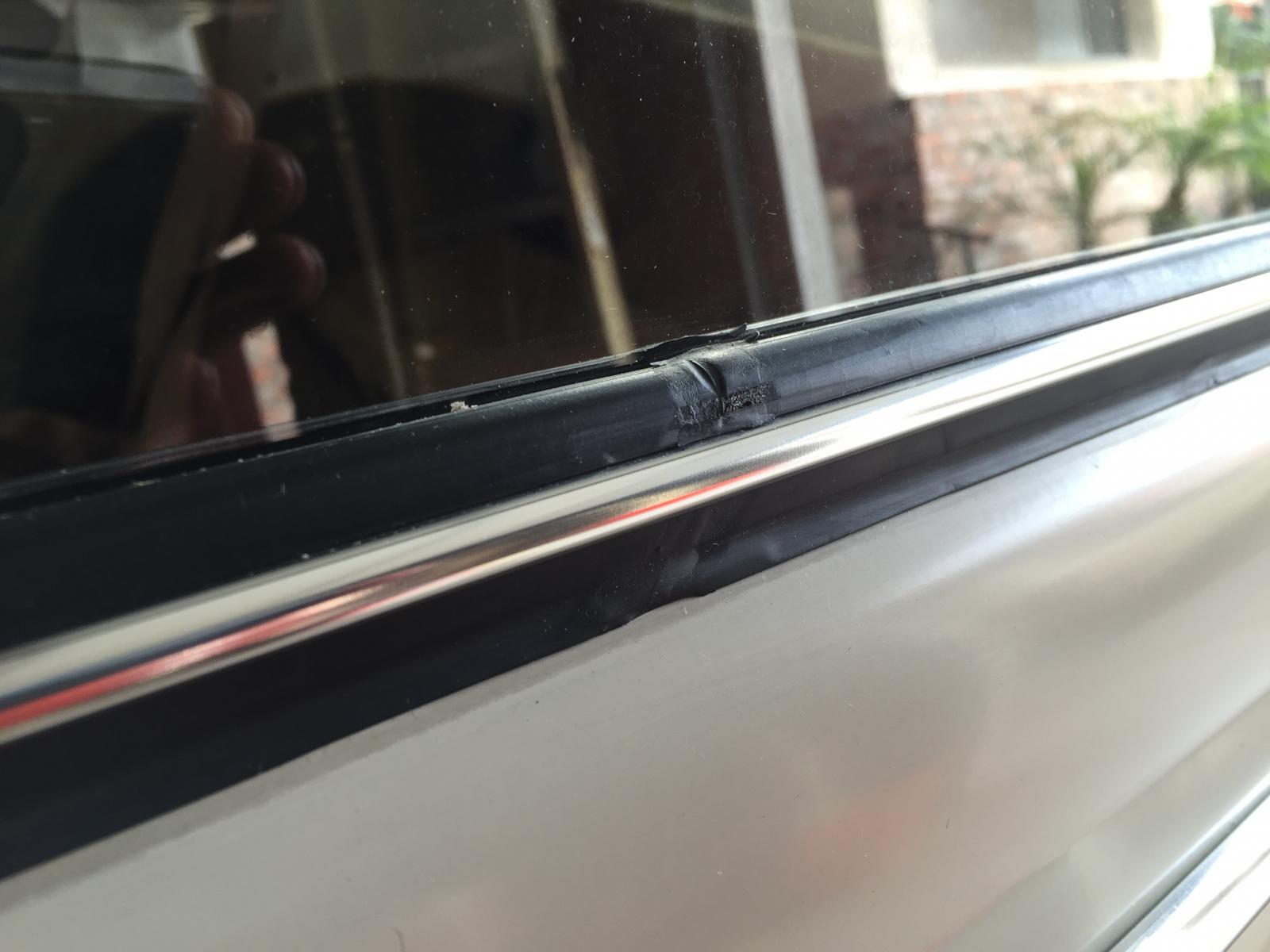

I had the same problem with WW window rubber but unfortunately I never inspected them and the guy who did my headliner had them installed by a window guy. It was a $140 mistake. I cut out the window rubber and took it back to WW and they refunded my money for the rubber itself but I was out the money for the labor. I didn't make a stink about it because I should've inspected it. I ordered Vewib German rubber from Cip1 and am extremely happy with the fit and finish of it. Pics of the WW rubber

VDUBMYK:
Those photos show EXACTLY what I'm talking about WRT crappy seams...
My interior guy put them adjacent to the trim clips in hope that the eye would be drawn to them instead of the seams.
Will go ahead and order vewib rubbers for the rear/quarters, and go ahead and re-install all 3 with some local help (my interior guy lives ~60 miles away in LA traffic).
Hope can get full refund from WW.

I've learned to inspect everything before I leave there now. I live 10 minutes away so I'm lucky in that regard. I had the same issue with door rubber seals. I asked for the German ones and the coutnterman tried selling me the Brazilian ones since I could buy "3 sets of these for the price of one of the German ones." The Brazilian ones were crappy and the corners didn't even line up. When I showed him, he understood why I don't mind paying for quality parts. BTW, the German door seals fit great.

Damn! I'm normally a WW fanboy, but those are GAWD AWFUL.
IMHO, everybody should stop buying that garbage and see what WW does when they sit on the shelf...for years!
