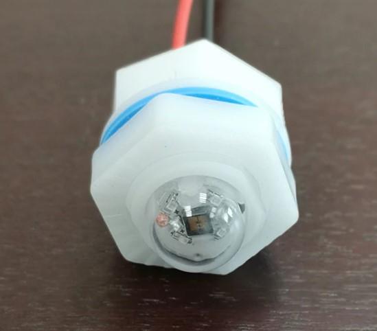

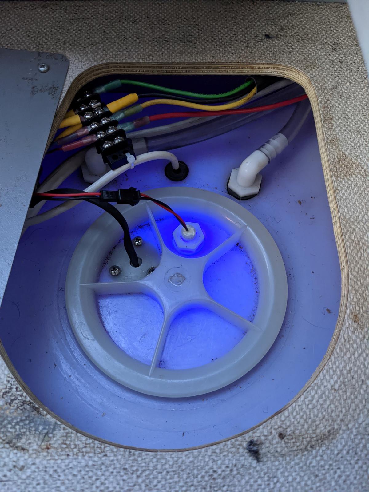

As if I had nothing better to do, I found this on AliBaba and plumbed it into my water tank. Bring on Giardia! Shocked
"Lumiwell UVC LED Module DC 12V sterilizer"

How about a link to the part?

cool color effect. what is the black wire for?

The thick black wire bundle goes to the water level sensor. Alibaba now shows this item as "undeliverable to the USA" 😳, but the are alternatives on the site. A little more peace of mind . . .

Here's a link to the specs:
https://www.solidrop.net/product/265nm-uv-led-lamp...lizer.html

The thick black wire bundle goes to the water level sensor. . . .
Interesting..h water level sensor is outside the tank on the side

Its wired from the galley light, so its only on for about 30 minutes in the evening. The tank is "milk-jug" plastic and almost as thick as a kayak. I'm not worried . . .

I find this a terrific idea!
I wonder if the intensity of this light is sufficient to be effective all the way to the bottom of the tank?
I wonder how long the light would need to be on to kill all the bacteria?
I think it's a valid concern about the UV deteriorating the plastic material, but depending on how often the light was on and the duration each time, it might take 5-10 years to be concerning or maybe 50 years.
Sounds like a great topic for a controlled science project. Anyone have a bacteria counting system?

Well this really doesn't tell you anything about effectiveness, it's just a suggested method for measuring effectiveness. But, in the method the exposure is 5 minutes, so assuming you could get 100% reduction of E. Coli at 1 cm, just 5 inches away (12.7 cm) you'd need over 800 minutes exposure for the same effect (12.7 x 12.7 x 5min) due to the inverse square law - and that's not factoring in the absorption by the water. So even if the tank is only 10" deep, you'd need almost 54 Hours exposure at the bottom to equal 5 minutes at 1 cm.
I've tested a lot of UV disinfection/sterilization equipment, and my guess is this is virtually useless, but can't really tell without any actual output specifications.

The better way to do UV purification in the RV setting is to build an inline UV filter into the supply line from the tank to the sink. You set it to power on only when the pump is running.
There are a lot of good products that already do this. This site has a few, including a legitimate in-tank UV sanitizer.
https://ultraviolet.com/uv-water-purification/
I agree with the other poster who mentioned that UV light will degrade the plastic tank. It's better to build something into the sink supply line.
I thought of doing a project like this, but for now I'm just using a separate Pentek filter system that is switchable. Turn it off for washing dishes, turn it on for filling water bottles. This is very popular with my guests, and works well as long as you manage it properly. Photo below.

Agreed on the UV systems quoted (e.g. they are looking at 30K uWs/cm2, likely >1000K times the energy of the LED). They are a tad pricey, but that's why.
As to a Pentech filter, I'd be cautious in what you expect it to do. To reduce or eliminate "typical" flora from a tank of potable water, great, you wouldn't want to rely on even a 5-micron filter to eliminate pathogens, especially Giardia and oocysts. And carbon filters are a food source for bacteria so their use has to be controlled if you don't want to create additional issues.
