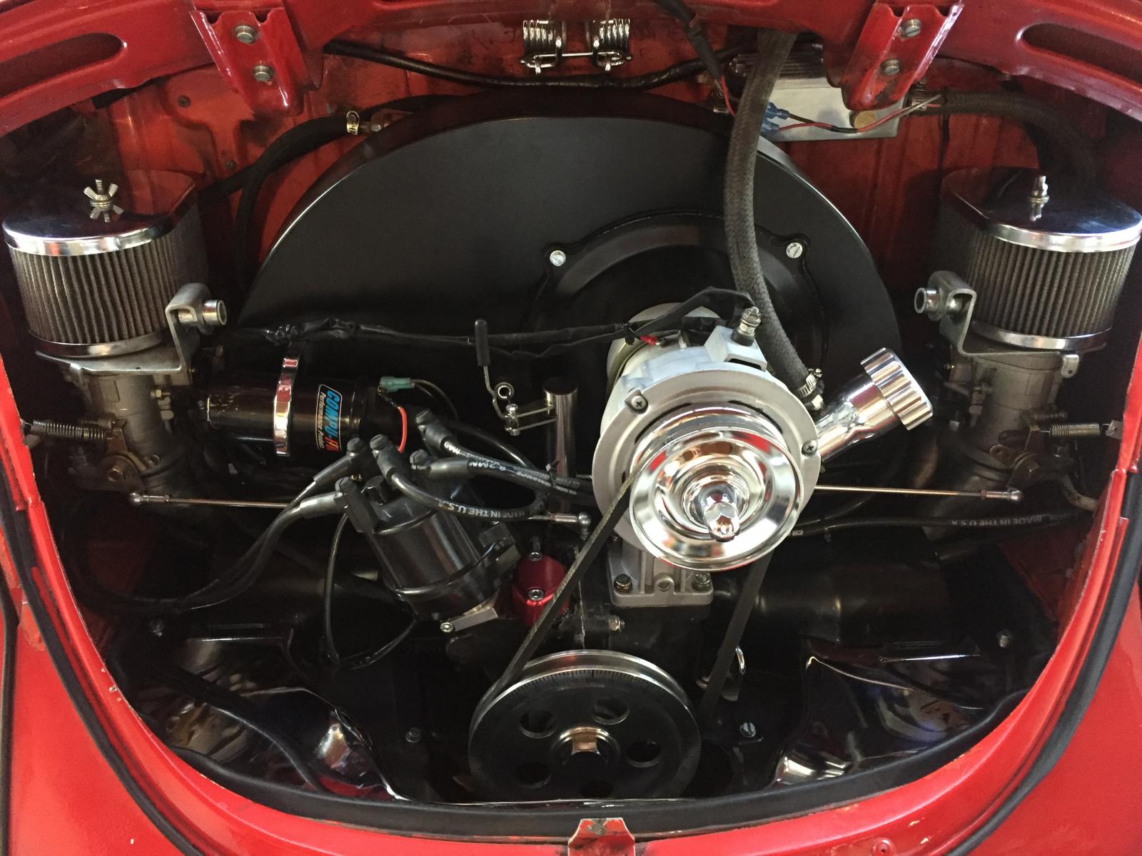

Am I losing my mind I have a 2276 engine I’ve always used a crossbar linkage since the 80’s basically all they had back then I decided to try the so call better linkage style I went with csp bellcrank after spending over 200.00 for linkage a different fuel pump block off since I had the one that doubles as coil mount which is in the way, and new Jaycee coil mount. After spending the day relocating and re-running wires got the linkage installed started it up at one carb ran like it was wide open adjusted the rods completely out cards were not close all the way came to the conclusion the rods were too short spent the day trying to get it to work put everything back the way it was with the crossbar to get the motor to run properly again Am I missing something?

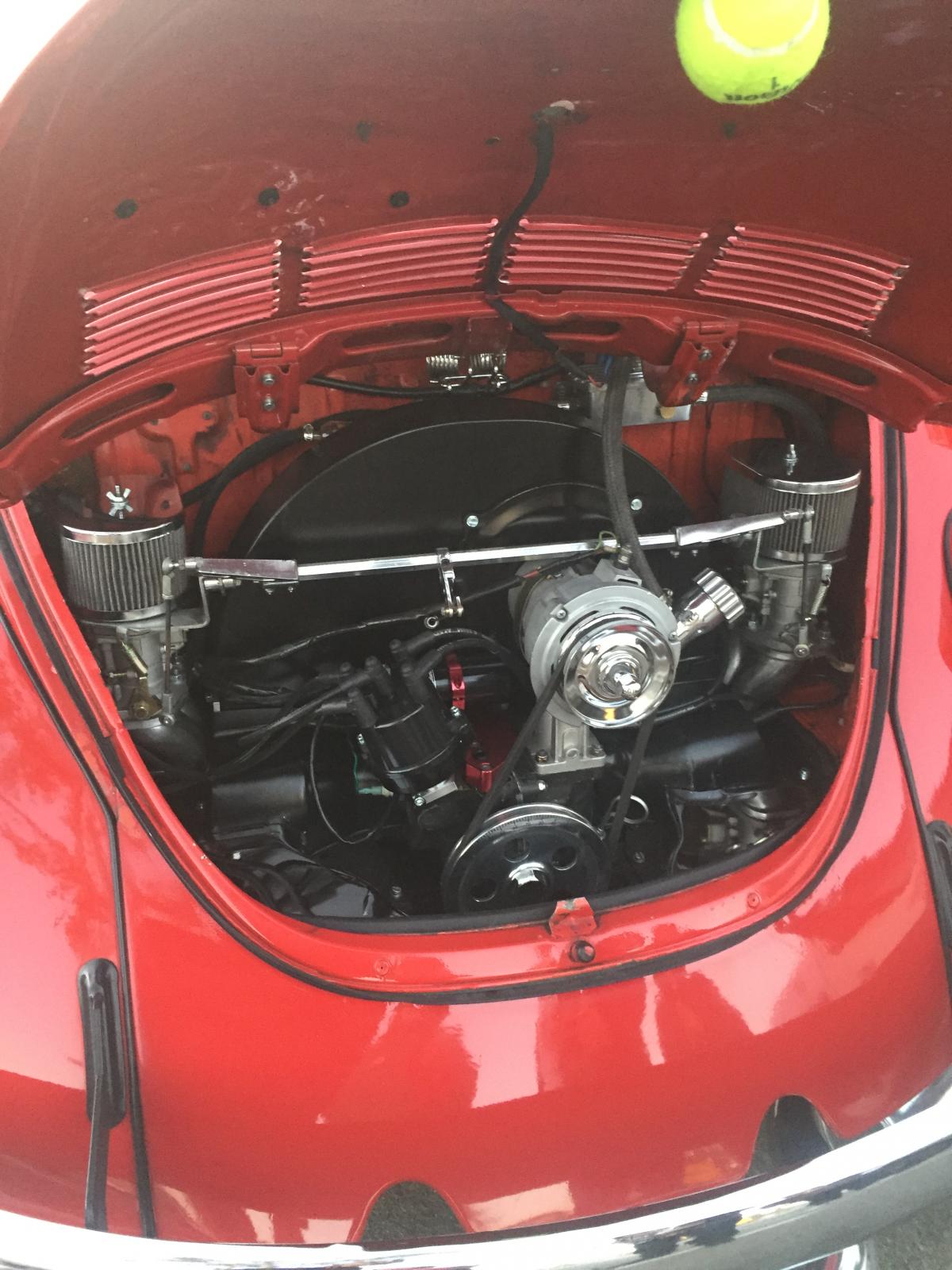

Sorry have 44idfs with offset manifolds I’ve had 2 different crossbar linkages on it redline and CB and not times had to get a 19 inch crossbar instead of the 18’s they came with so the ball ends weren’t threaded so far out to reach the base plates

The bell crank should push not pull. It would only hold the throttle open if they were too long. Winding rods out opens, shortening them closes.

Sorry didn’t take a picture of it installed but both ball levers were 45deg down and facing in however you said shortening rods closes carb but when I shorten one side it pulls other side open? Do I have the threaded end backwards they came already together and the longer rod is on the left if you’re facing the motor .I’ll try and post a pic of the motor as is maybe one of the carb arms is backwards?

Perfect that’s exactly how I set it up sorry guys I was pulling my hair out on what seemed simple I was using the words PULL carb open when in fact it is push push sorry for the confusion.ive looked it over so when the rods are all the way out at the end of threads it barely snaps on both sides n pushes one side barely open if I shorten the open side rod to close carb the center pull rotates towards the shroud in effect pushing other side open so it’s like there’s no adjustment available to rotate center counterclockwise to pull both sides closed .hope that Made a little more sense seems like if one of the rods was longer I could screw it and then snap it on and have some adjustment on both rods to even it out

If you center the linkage, so it is halfway between the two carbs longitudinally (half the offset), and get all the angles right, preferably with the linkage pivot ball-joints seperated apart by the same distance as the carb offset, you can have a really nice, even, Pull-Pull system. It's a lot of work, but I'm glad I did it. I had to order the left-handed die, though, and it was a lot of work.
Study the stock Type3 system, and emulate that, it was worked out by actual engine-ears.

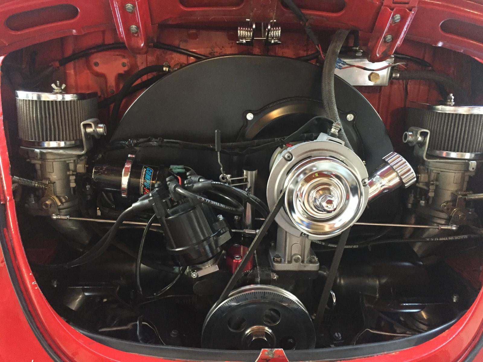

Ok so I’m not crazy I a longer rod from an IDA kit that gave me overall about an extra 1/4 inch of adjustment which works fine now EXCEPT now I have the 2200rpm stumble I didn’t have before but only for a second Seems to be a lot smoother after that. Maybe since the linkage isn’t slopping around now at the joints it’s uncovered a minor flaw.I readjusted the valves and checked the timing and re-sync the carbs everything good I’ll check the Jets again tomorrow. All in all looks like it will be a better option and stay in sync longer appreciate all the feedback here’s a couple pics of it installed

With the CSP bellcrank linkage, it looks like the 3/4 side rod has a greater angle then the 1/2 side. Is that correct? And if so, how can you get the carbs opening at the same rate when they cant open at the same rate cause of the different angles?

dntchav, It is quite normal that at least one rod is too short. It is du to the fact that the set is designed for their own manifolds and not everybody else´s (which to some extend is understandable.) You can order longer rods, no problem, exept if you can´t order locally.
